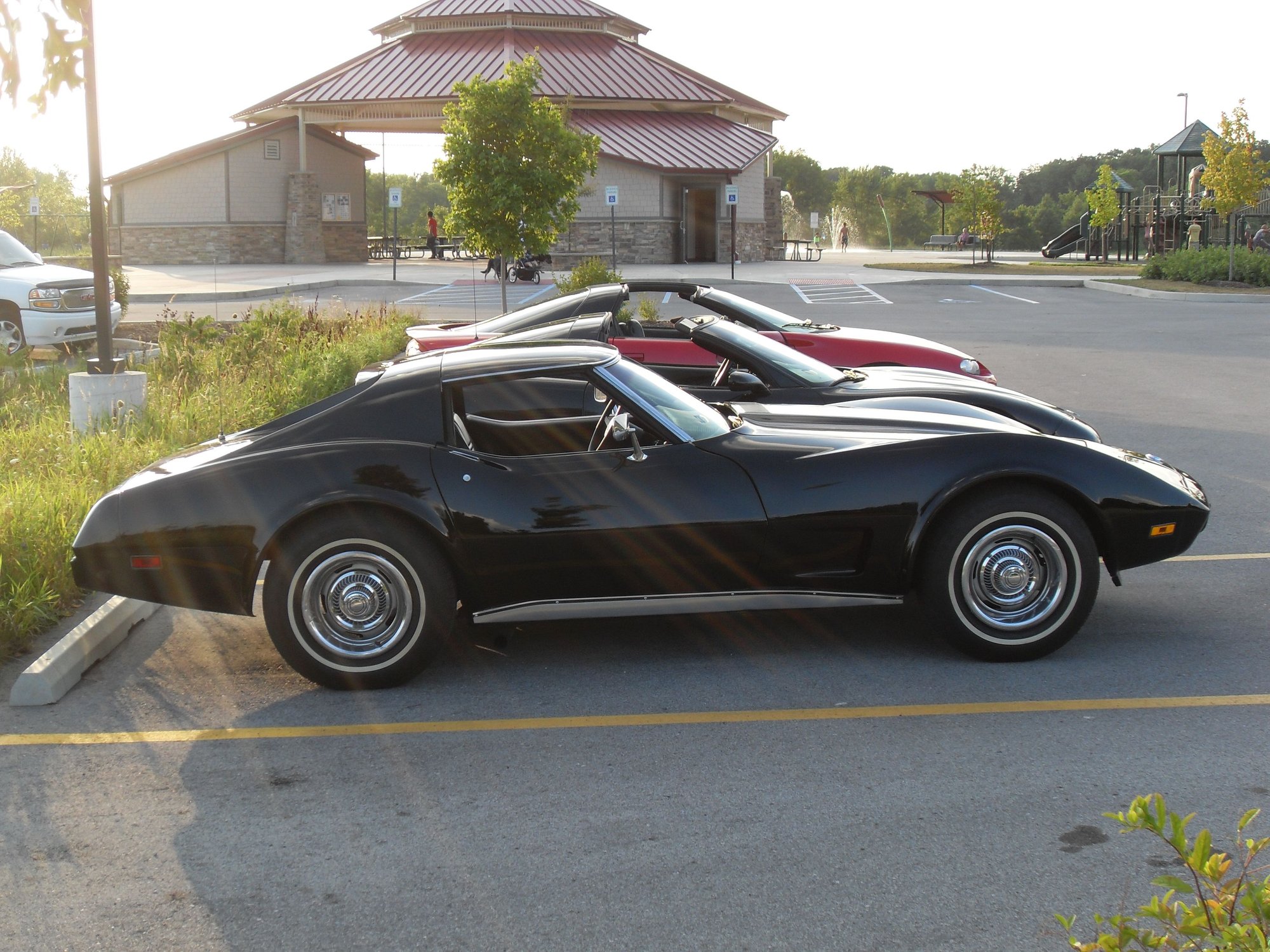

I couldn't really see where the posted picture dumped out before the rear tires.
But anyway bigger diameter pipes have a nice deep sound even with a "H" pipe idea. These are 3 1/2 inch in and out race mufflers with 4 inch tips. very little back pressure. Times were about the same when I was into drag racing and just ran open headers with 14 inch collector extensions. I got tired of the noise and just put on dual 3 inch full length pipes opening up to bigger diameter mufflers. I had a 355 ci motor back then. Before Corvette forum even existed. You do one exhaust system and it is good for life when you go to 434 ci SBC
Those are my 345 width road racing slicks

Nice Ride, can barely see...stealth and clean lines, I'm sure it's impressive in person!

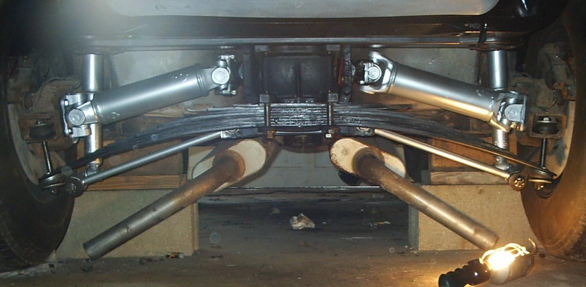

Here's a photo of after I cleaned up the rear end that gives you a better idea, the exhaust is loose at the collectors in this shot which is why they are dipped way down, they're usually horizontal with the car.

I get it...slick way of achieving the sound and not compromising the original look. I'll share some picks as I progress. Thanks for the insight!

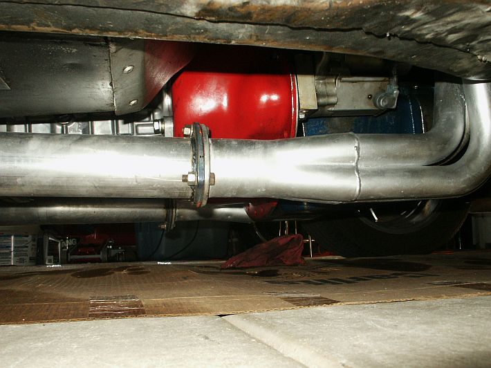

To simplify the header exhaust system. You can buy tranny cross members that have the exhaust pass under (NOT THROUGH) like stock. I just installed my headers and drove straight to the muffler shop.
3 inch straight back off the collectors. Passing under the cross member
