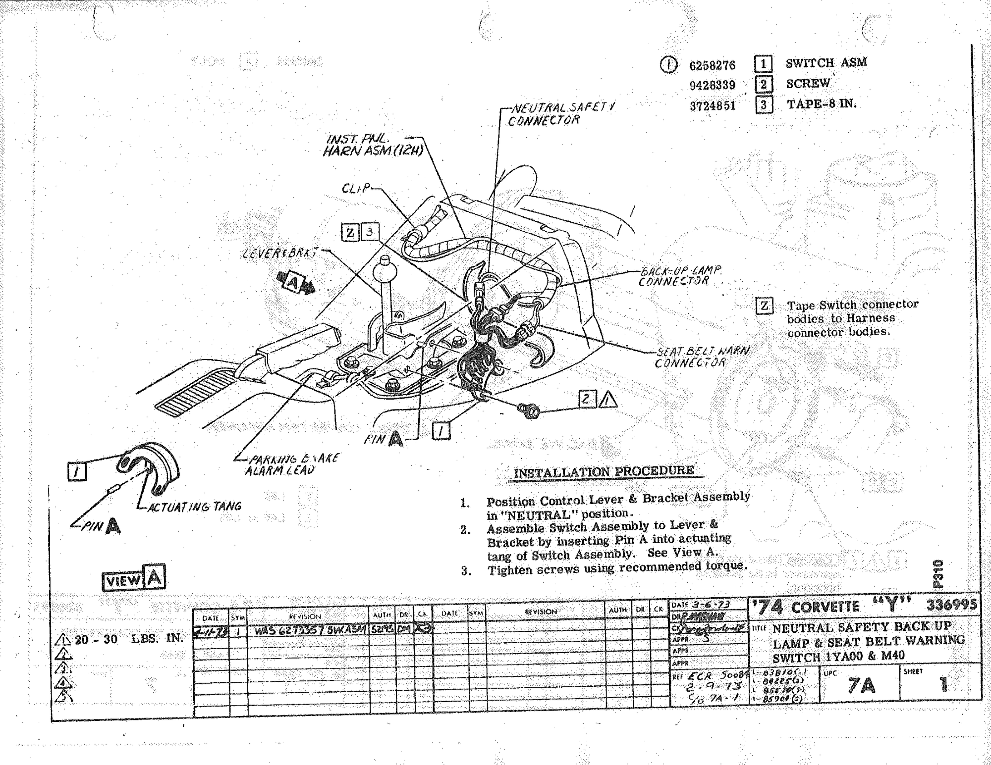

Is your 'starter extension' good and connected correctly?
Have you tested to see if the neutral safety switch works? Power in and out as you move the shifter.

Old Jun 11, 2021 | 12:04 AM
Peterbuilt's Avatar
Peterbuilt
Joined: Aug 2006
Posts: 7,431
Likes: 1,562
From: mount holly NC

Originally Posted by Peterbuilt
this will be a big help. I’m gonna run these down after work tomorrow and will report back. Thank you
peterbuilt,
checks on the NSS complete. There are some slight differences in wire color (yellow wire on new harness brings 12v to NSS, purple brings it away).
yellow checks good for 12v with key to start.
both sides of NSS check 12v
purple wire to solenoid checks good for 12v with key in ignition.
So have narrowed it down to between the NSS and the solenoid. Just trying to see where you recommend to check next.
thanks again

If you have 12 volts in and out of the NSS with the key in START then check for 12 volts at the purple wire on the solenoid.
If no power on the purple wire at the solenoid you have to find the break (open) in the purple wire.
Is your starter hooked up correctly?
