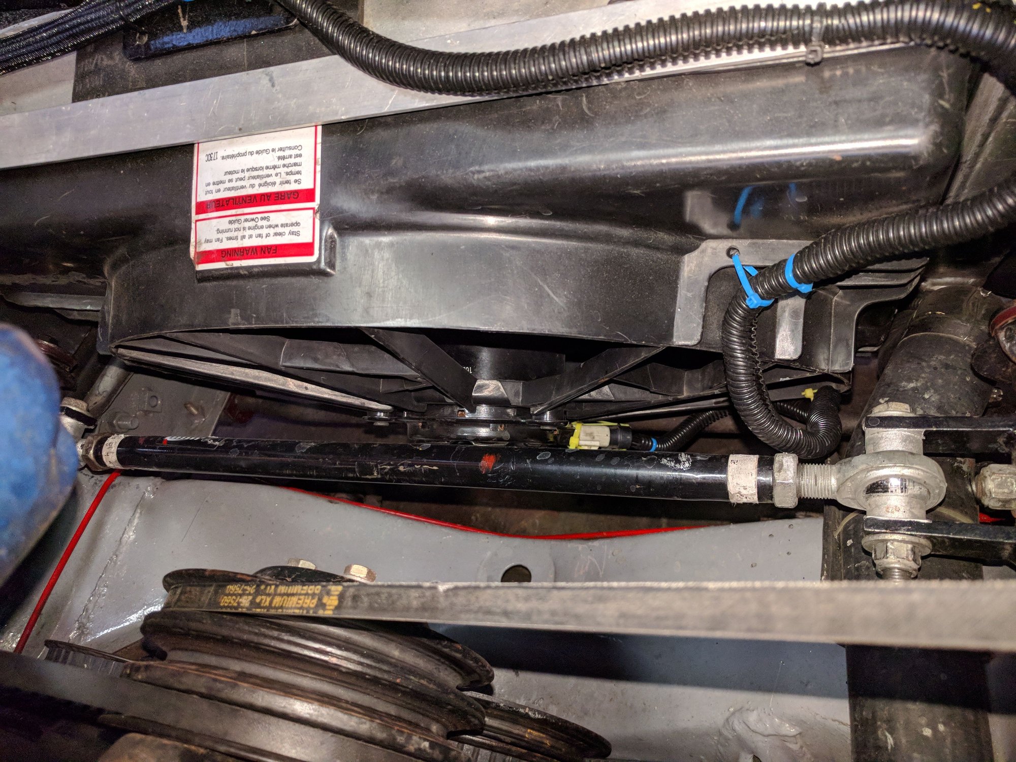

IF you already have all the long water pump stuff then you should have more than enough room for a LWP. See here my electric fan in mine. There is a LOT of room up front.
Originally Posted by 77383
thanks for all suggestions, back to drawing board with short high volume pump and all related brackets and pulleys and such
