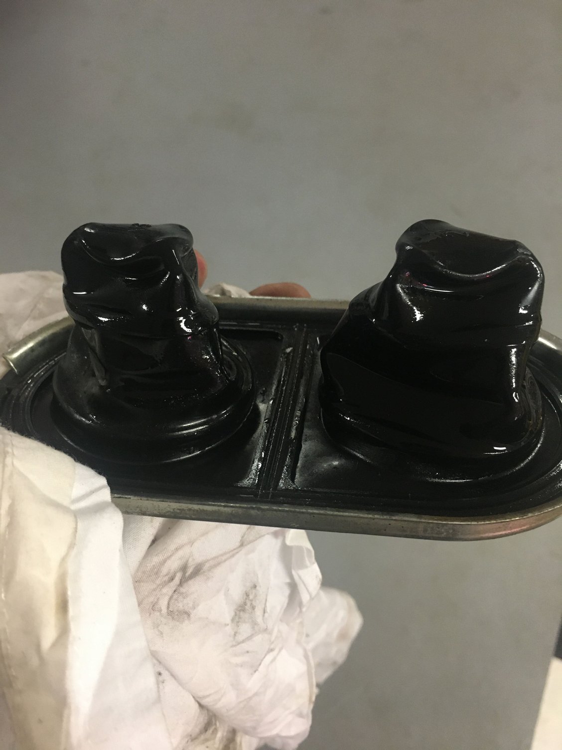

Is this the way they are supposed to look? I’ve seen some that are flat and I’ve seen some covers have none at all.

They are a form of a diaphragm. take your finger and fold it back down. this one is extended from lack of fluid. it's supposed to do that. it folds back.

They are like an accordion. Push them in so they fold up. Then you will be able to fill the MC with fluid. They are designed so when the fluid gets low they expand to take up the space.
