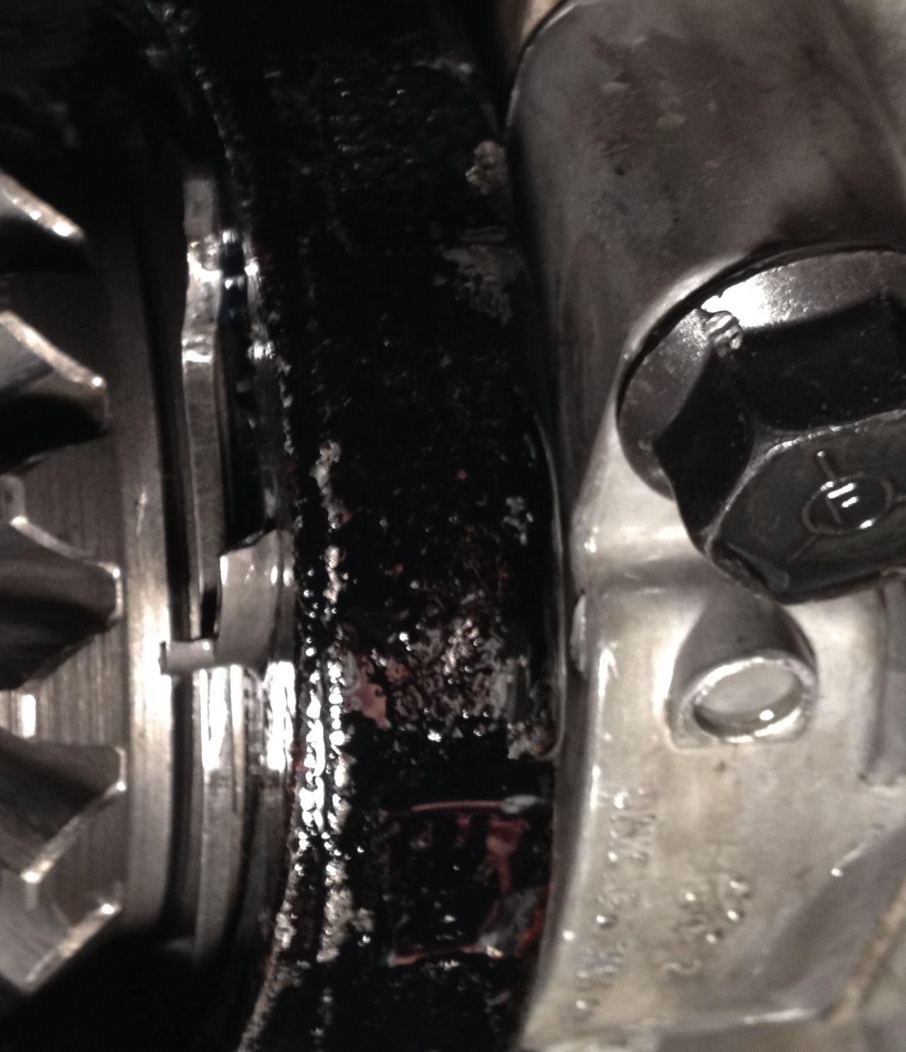

A couple notes. Bairs in PA will do a rebuild and are excellent to work with. But they will not machine up a new steel cap. While I haven't seen commercially available steel caps, I have seen commercially available billet aluminum caps listed for Viper Dana 44's. These have to be fitted to your diff, but that is true anytime you replace bearing caps. And billet aluminum would be a much stronger than the existing sintered aluminum caps. Even the sintered aluminum have been reasonably reliable up to 400 hp. For an assessment of the issues with the stock caps see this thread.
As far as swapping gear ratios, as was noted above, your options are limited. I replaced my 3.07 with 3.54 and they are OK. I would have preferred 3.36, but they appear to be made of unobtainium. It is likely you'll need new stub axles as they had some soft lots at the time and they mushroomed out. And it's likely the clips holding the clutch packs together have broken per the photo of my '80 L82 when I pulled it apart at around 90k miles.
