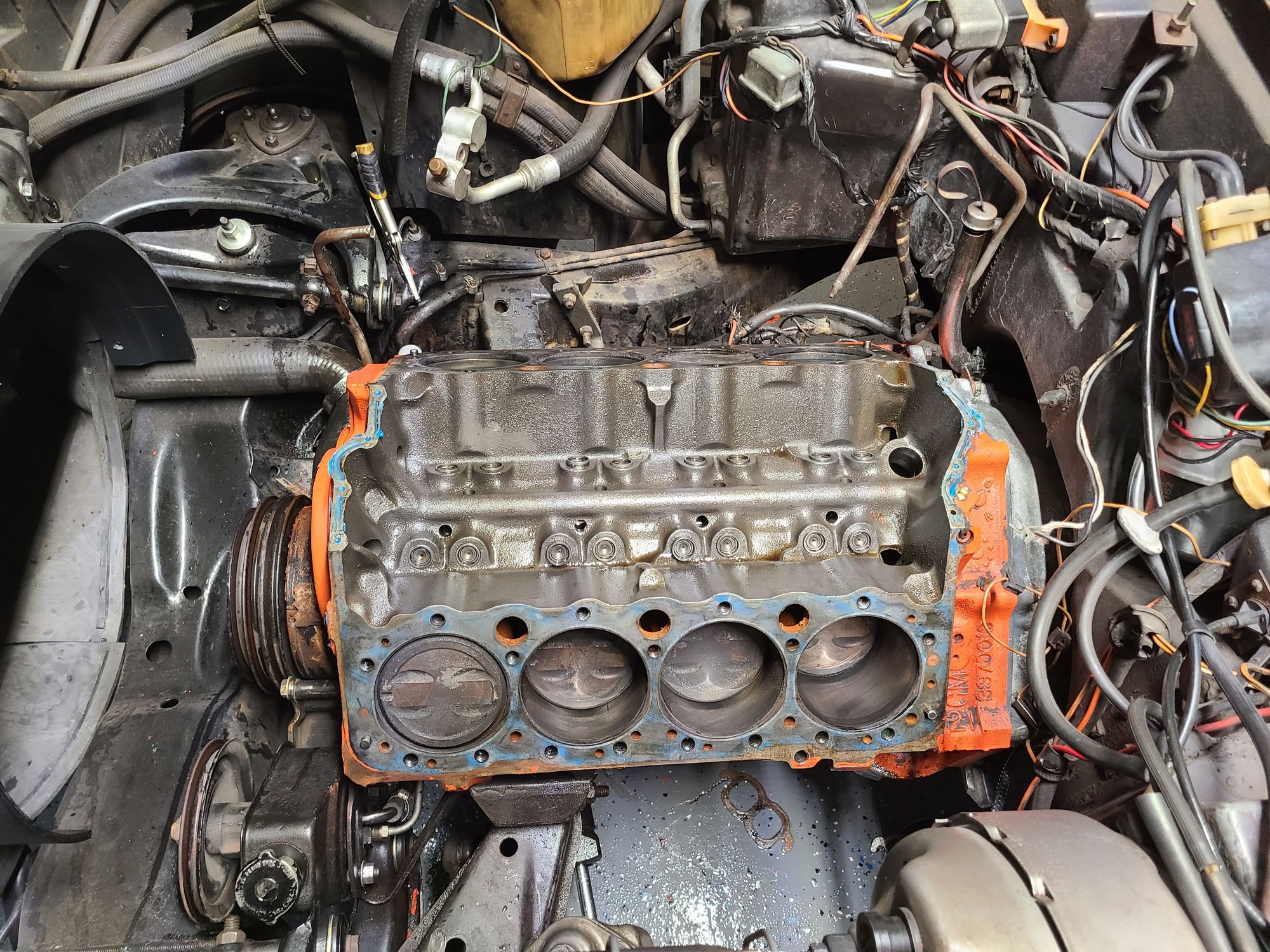

Well I pulled the heads off tonight and confirmed the worst case scenario..... The pistons are dished. They are marked with "020" which I assume means a 20cc dish?? I also confirmed the deck clearance is 0.035". Which means with my new 64cc head and a 0.041" thick head gasket my compression ratio will only be 8.28:1...... I see that felpro offers a .015" thick head gasket, that would get me up to 8.7:1. Even with that I imagine that I will need to go on the smaller side of cams.

With decent heads and 9:1 compression I would go with the k1103.
The first cam is close to the old crower Baja beast, which worked really well on low compression engines with stock heads. It was a decent improvement over the stock flat tappet cam even though it wasn’t much bigger.
I ran the 268H with stock bottom end and 64cc heads. It had good mid range but with 3.08 gears the bottom end was pretty lame. With tall gears the first cam might feel quicker but have less mid-high range power.

The 020 probably means that the pistons are .020 oversized. Which means you no longer have a 350. More like a 352 or 353 .
The engine is bored over. How would I determine how much of a dish the the pistons have?

To properly CC them would mean removing one or pulling the engine to get it level. for the price of a set of pistons. I would replace them with flat tops.
