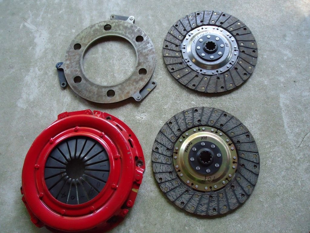

I can tell you from first hand experience that the original McLeod street twin with one disc having a Marcel spring, will not release fully. My RST releases in .440 of an inch as tested on a press, does not rattle, and has lighter than stock pedal pressure. I am using a 12 pound McLeod aluminum flywheel and my 502 is internally balanced. Love the clutch.

Had this chattering on/off switch McLeod in for about 25 miles and took it out and put in a Ram diaphragm in my slightly modded 427/435. When pushing on the clutch pedal, the firewall flexed so much, the brake pedal would move. If I could have found a n.o.s. GM clutch, I would have bought it.
