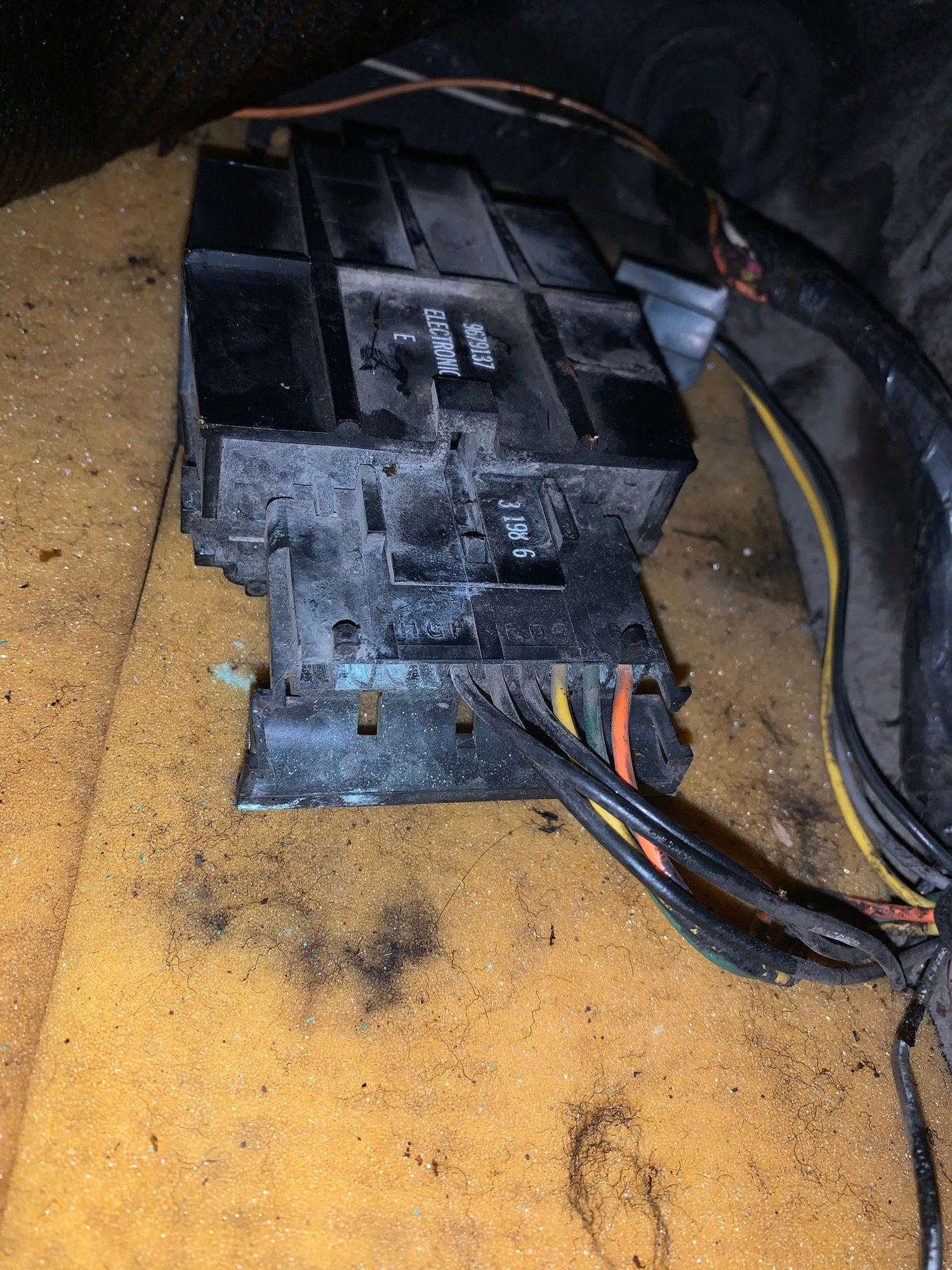

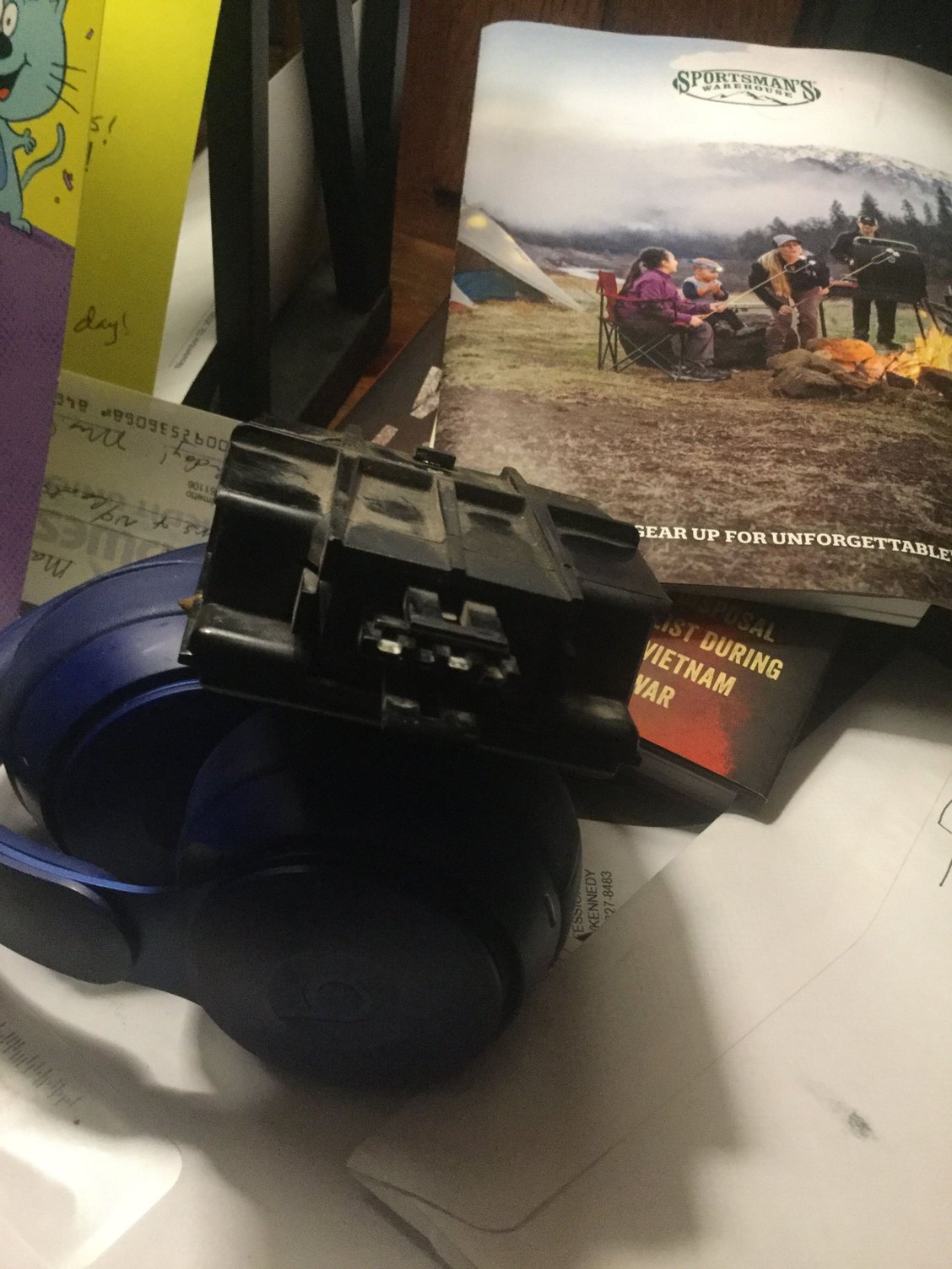

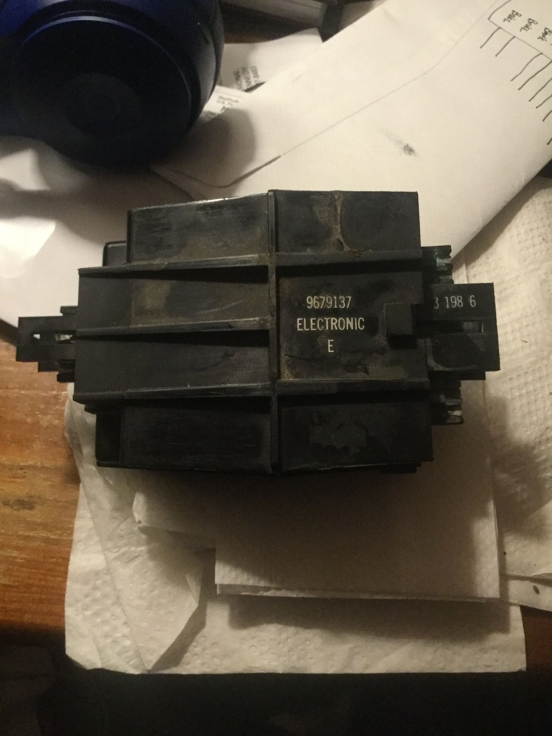

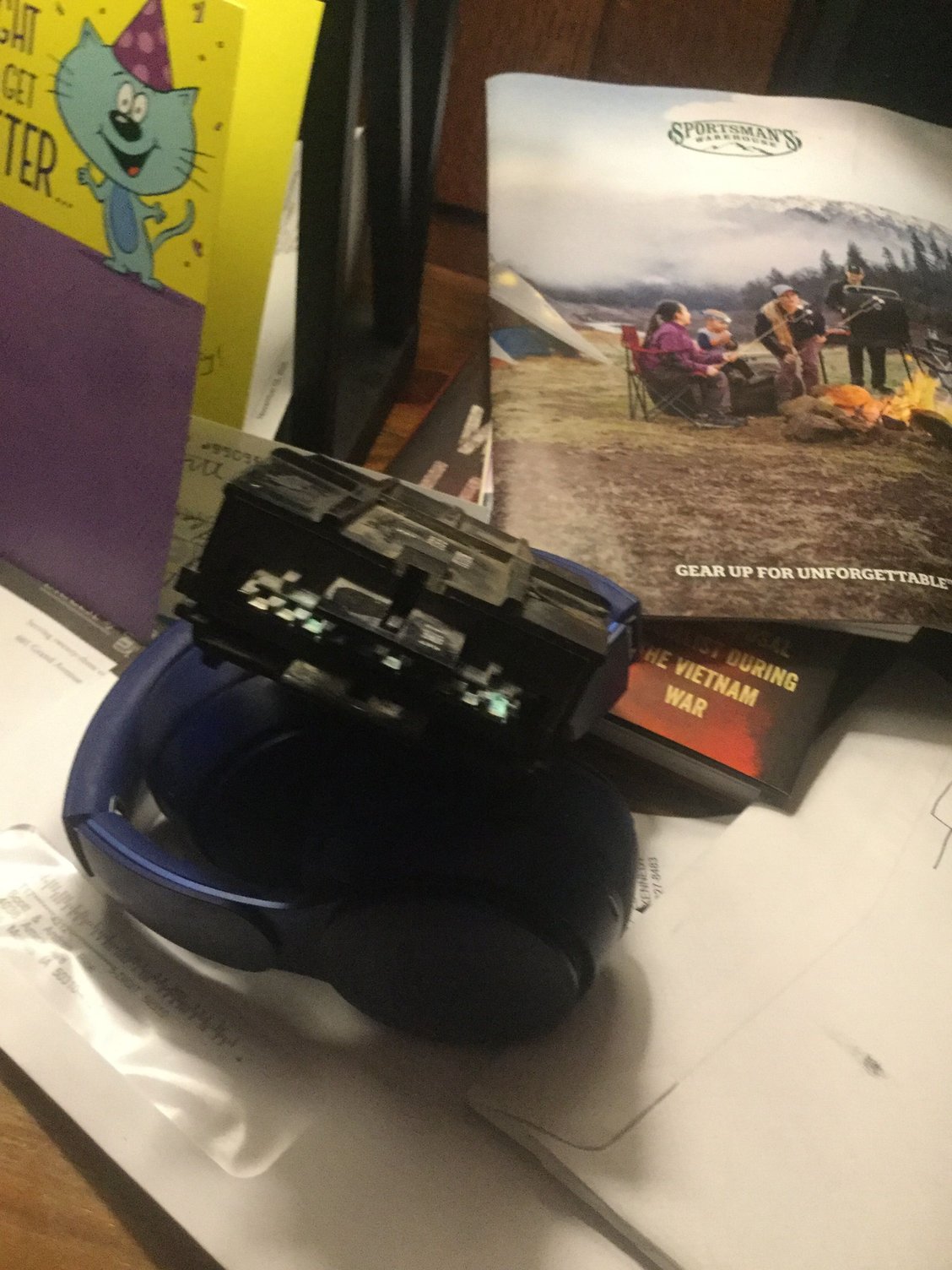

Hi. I was looking for the reason why I don’t have brake lights. When I found a black electrical box behind the drivers seat under the carpet. In the trunk so to speak. It has 8 wires going in. 2 are corroded off inside the terminal 1 is super green. It has a 3 or 4 plug terminals on the back but wasn’t plugged in. Any help with what it is. And how / where to get it replaced

Shoot a picture so we can see what you are dealing with.

That is the seatbelt interlogic module. It is designed to inhibit the start circuit if the seatbelt is not connected. Most have long been disabled by the owners.
