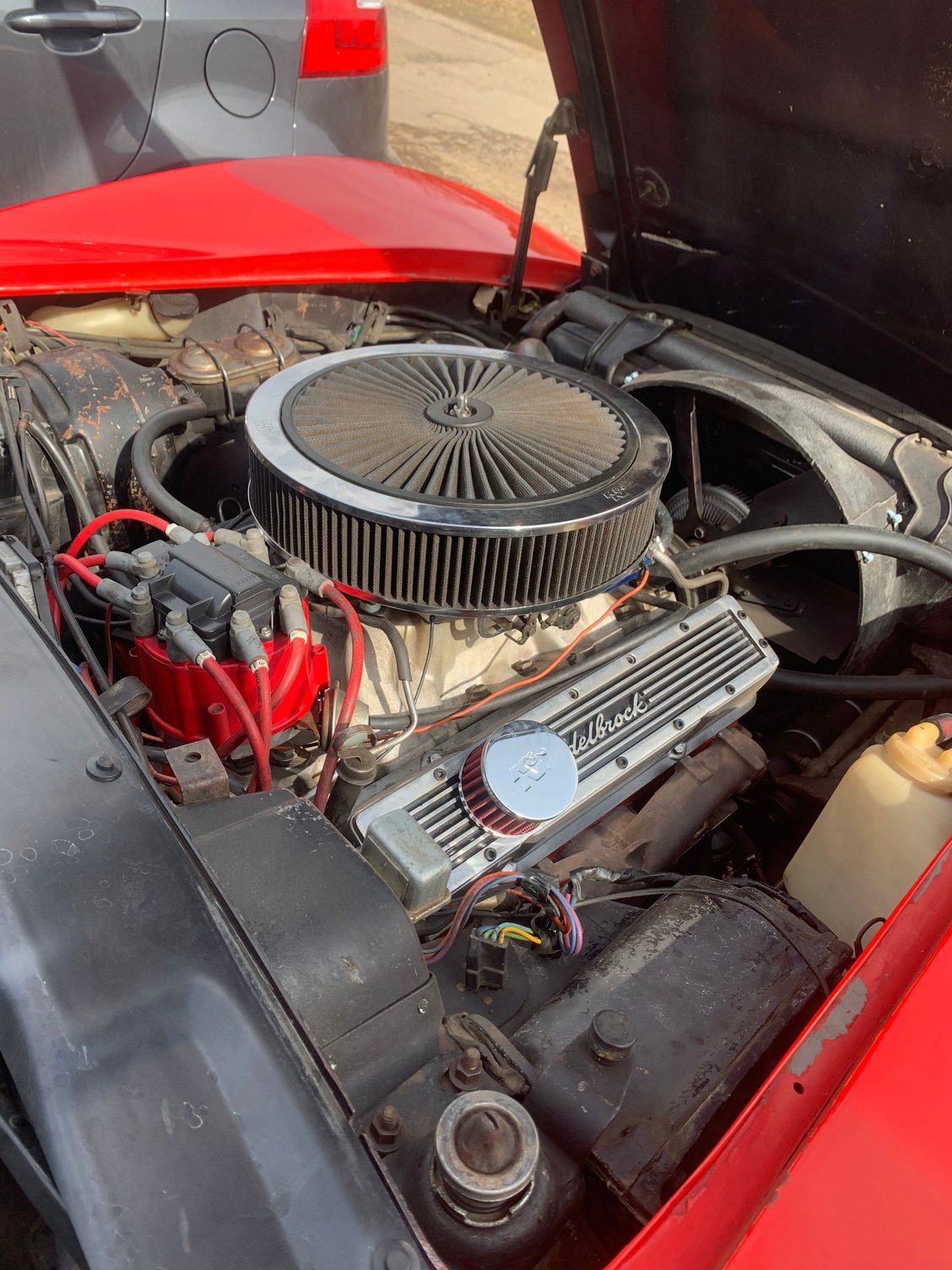

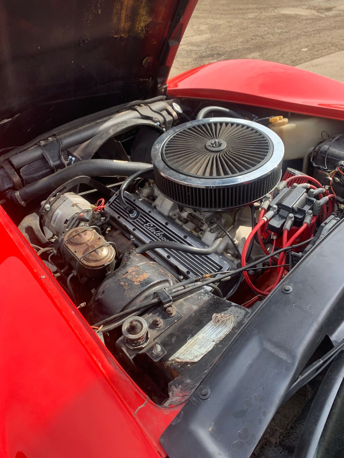

Hey all,
Just wondering if anyone has a rough idea how much horsepower I should be running. Have a modified L-82 (stock HP of 210 supposedly). Have an Edelbrock highrise manifold, flat top pistons, and thumpr cam.
On the dyno I got 183 hp and 208 torque. They fixed timing and the fuel mixture, but no changes were observed. Anyone know where I might be losing power? Have any easy tips to get more power without doing an engine swap? I’ve got plans for headers out to side pipes, but nothing much else.
thanks in advance!

Can you be more specific as to what "they fixed timing means"?
What carburetor exactly?
Edelbrock thunder series carb.
and the timing belt I guess? Not very familiar with the right lingo. I’m only 22 and very new to the auto world. Didn’t even know what a carburetor was before I bought this.

sounds right for rwhp

Most of the Thumper cams that I tried to input into my Dyno software Showed pretty poor results. as mentioned they are designed for sound las the priority not performance. That said they're not all that bad they're just not that great either. The best thing you could do to wake that engine up would be to put 64CC heads on it

Auto or stick..w/performance cams you ought to increase the stalls speed of the converter. Many go out of their way to use a stock one with a cam thinking a converter is a detriment...its the exact opposite.
A better set of heads, some 1-5/8" headers, dual ex and the right cam it wil feel like you added a 2s

Your numbers are in the ballpark if you use the conservative drivetrain/accessory loss of 15%
.15 x 210 = 179 so you are actually a little ahead of the curve.
