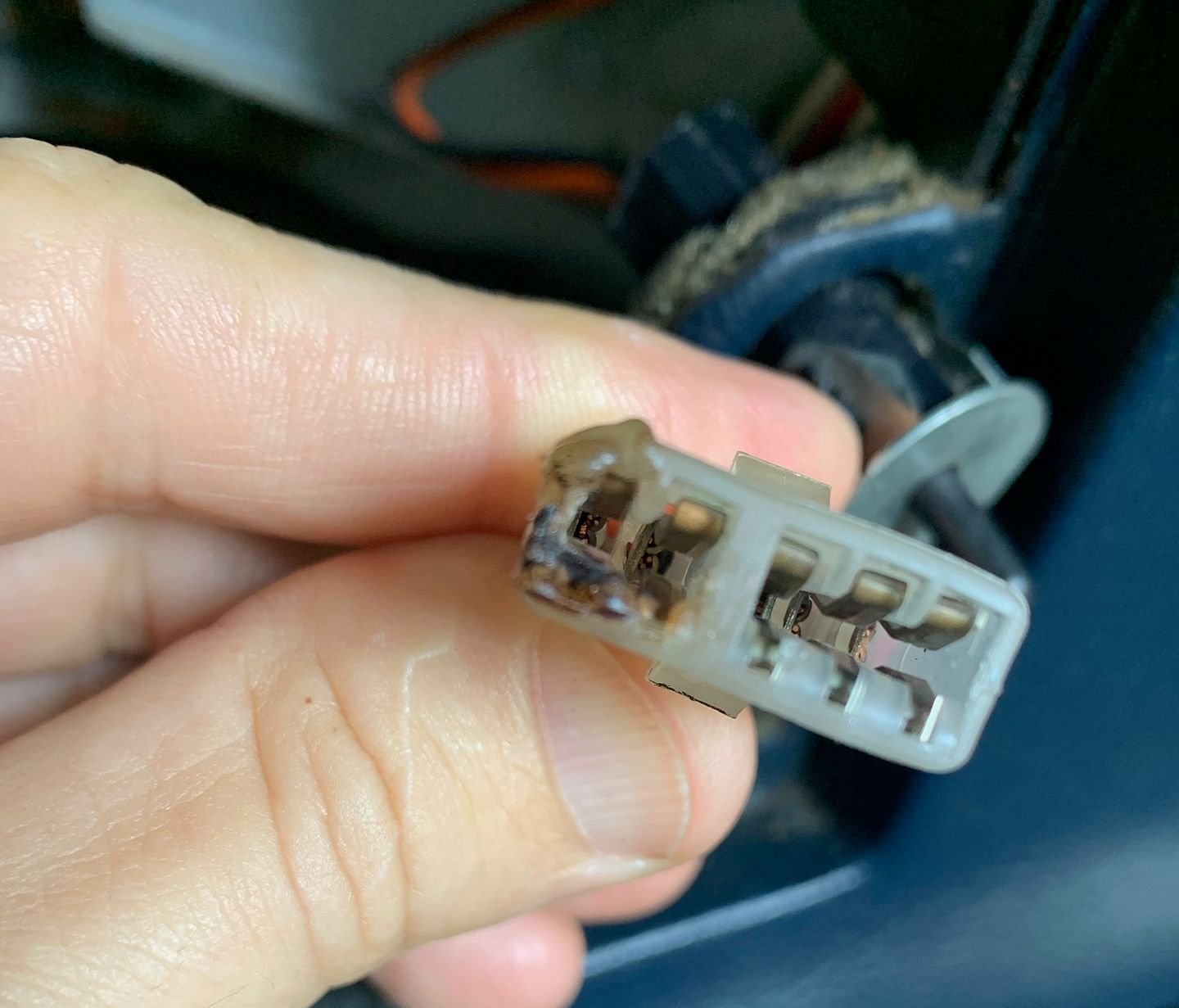

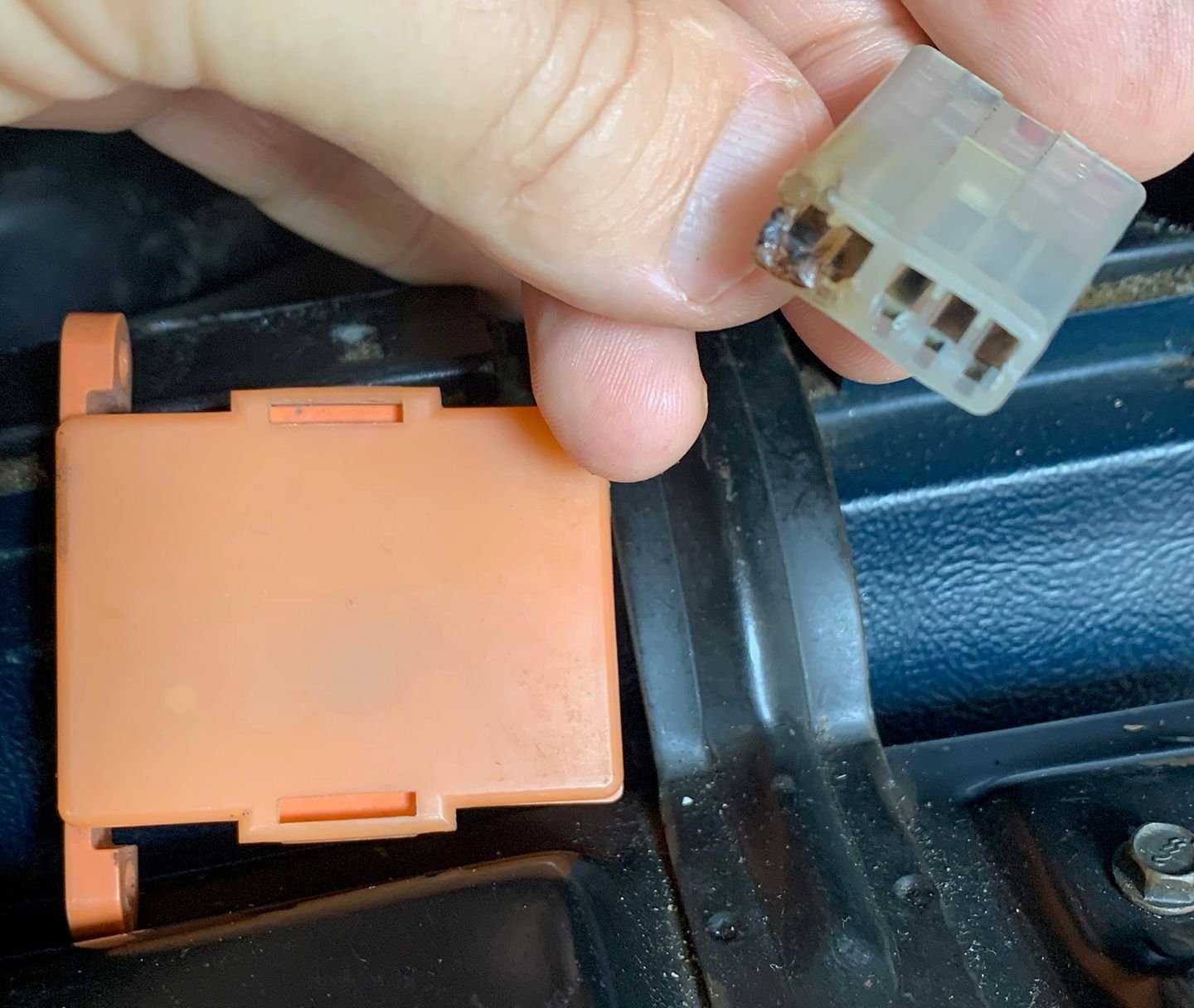

Where can I find a replacement plug for my interior light delay timer? I replaced the circuit board a couple years ago, it appear to still be good but plug is melted. No idea where to purchase a new one. Thanks in advance for the help.

It looks like on the line diagram that connector number is GM 8900655.
That number has been superseded to GM 12020299.
Here is a e-bay Link for the 12020299 connector. https://www.ebay.com/itm/NOS-1983-20...-/163671814892
Here is a .cad drawing to compare yours with. https://www.mouser.com/datasheet/2/1..._1-2265488.pdf

In your first pic, if you take a tiny jewelers screwdriver you can pry both contacts inward and pull the connector out of the housing.
I have a couple connectors like that from GM power antenna kits. Same housing but 4 wires. 5 slots.
Can send you one if you want.
