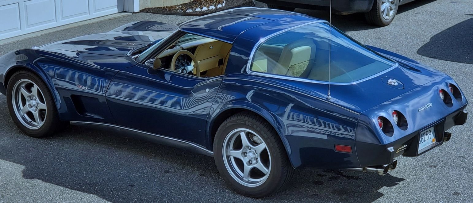

Mine are YearOne, 17" x 8", One piece Aluminum, 4.5 BS, with 1/2" spacers, 245/50-17 Michelin tires.

I prefer the look of the 8" wheel with the 4" BS, keeps the original look. I did install ARP longer studs since I wanted spacers and the strength of ARP.
I've had the wheels and spacers on since 2015, without any issues. The spacers are billet aluminum, hub & stud centric. (Wheels Torqued to 95 ft lb)
I have no concerns about using spacers, just use good studs and good spacers.
If you're looking for larger rear tires, then the 17" X 9" would likely be better for the rear.
A good friend drove in Trans Am racing professionally for a few years and always used spacers on his race car. He never had a problem. He's now using a 3/4" spacer on his '74 Vette, (383 450 hp), with the same yearone wheels, since 2015 as well, with no problems.
If you're concerned about the spacers when autocrossing, then just remove the spacers for that event. My experience says spacers are not a problem on the street, even with aggressive driving.

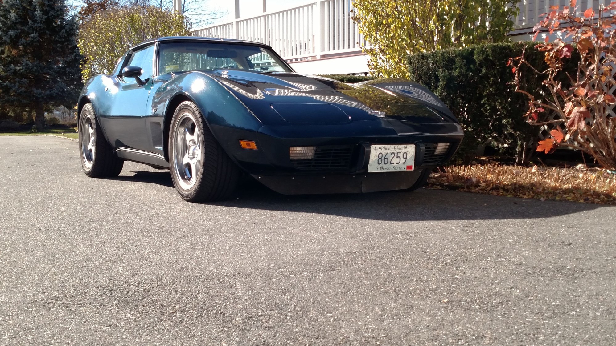

These are ZR1 style SLP 17 inch rims (BS unknown) with 255/45/17 fronts and 255/50/17 rears (gear preservation (3.70 rear gears stock) and for a modern stance, slightly higher rear versus stock C3's that often sag in the year, old school and dated look.
