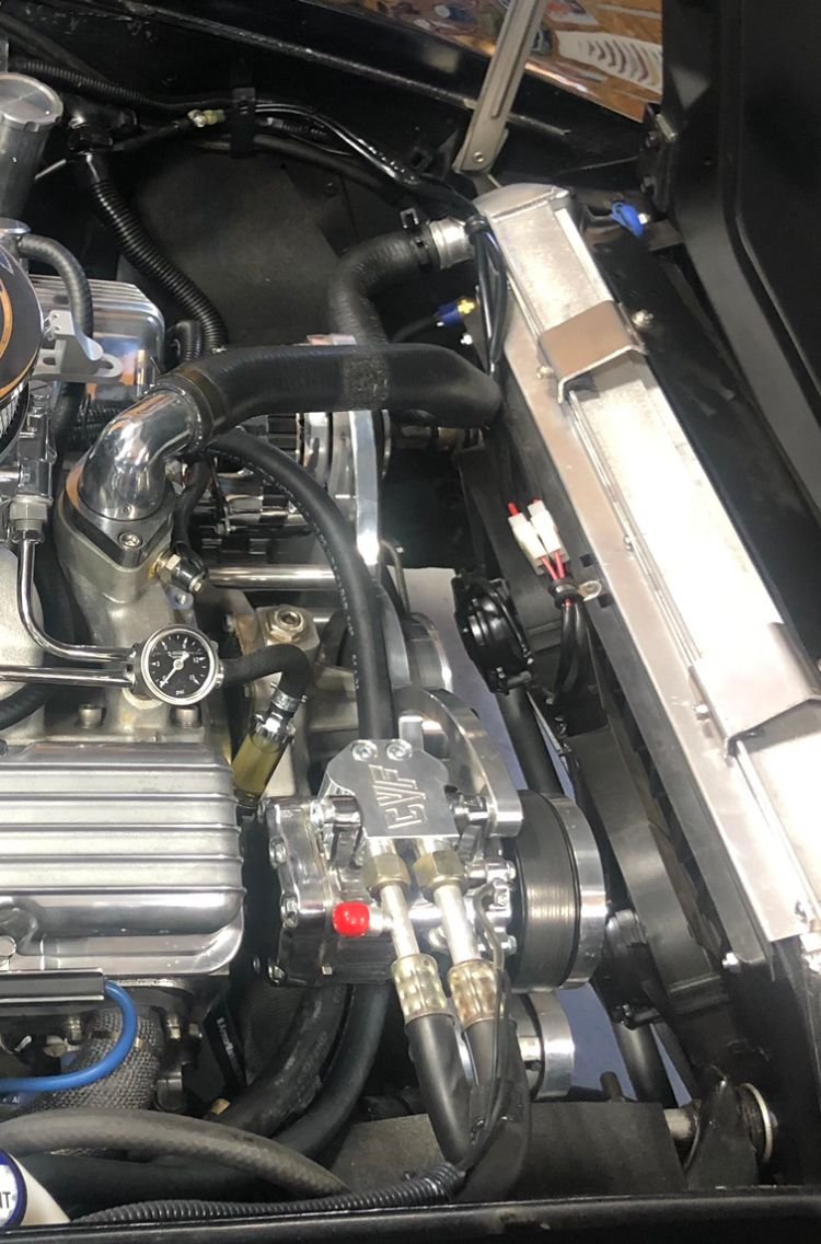

I have the CVF Racing “Wraptor” serpentine system on my car with 140A alternator, Genp 2 PS pump and upgraded AC compressor. Benefits of a serpentine belt system are many. Including being stronger, more belt wrap, less slip, last longer, consistent tension to name a few.

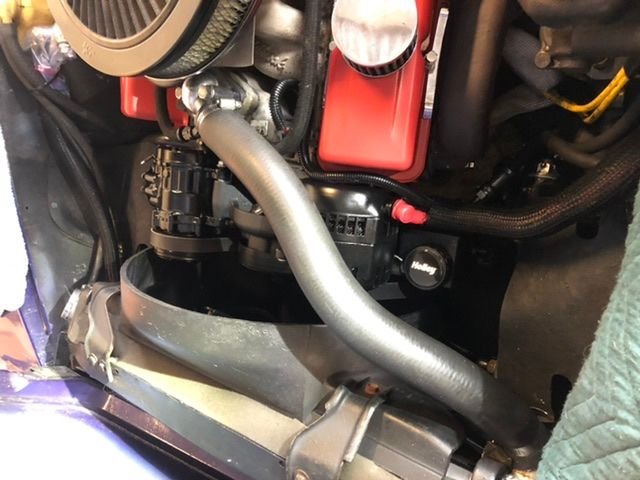

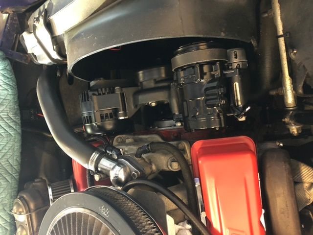

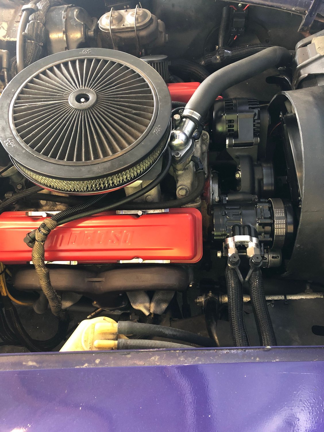

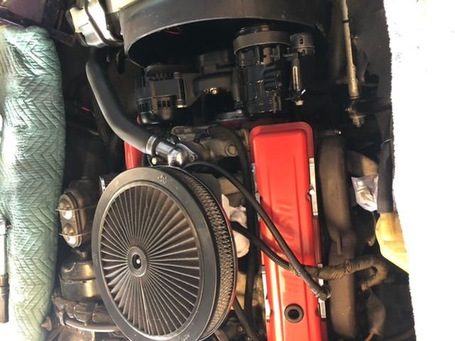

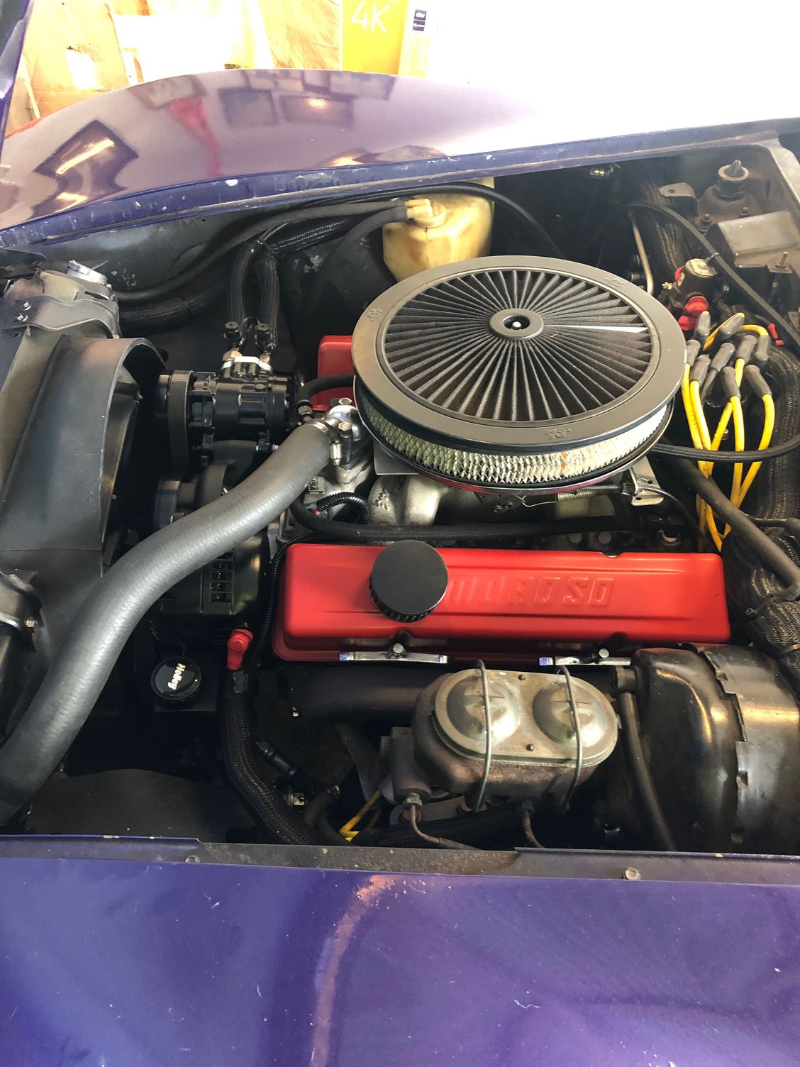

Old Jul 7, 2021 | 10:17 PM
iokepakai's Avatar
iokepakai
Joined: Apr 2007
Posts: 1,039
Likes: 62
From: Kona Hawaii
Some pics .Waiting on some AC fittings to finish up the project ..
Old Jul 8, 2021 | 12:27 PM
djquik1's Avatar
djquik1
Joined: Mar 2021
Posts: 278
Likes: 43
From: Kansas
That looks good. Electric fans would offer even more room

Alohas, Had no fitment issues other than trimming the fan shroud to clear the crank pulley and a slight trim for the PS pump pulley..There's an electric fan tucked in the shroud .
Will report back when the AC lines are complete.Using Aeroquip AC fittings and #8 ,#10 PTFE hose for the AC lines off the compressor ..
The part number for the PS line adapter 5/8-18 to AN6 Fragola 491942-BL & AN6 coupler 220641B ,was unable to find an adapter Inverted flare to female AN6 only a male ,hence the AN6 coupler ..
AC fittings Aeroquip Your application might need different angle fittings ...
FCE1813 #8 with charge port
FCE1814 #10 with charge port
FCE1713 #8 straight
FCE1724 #10 45deg
#8 PTFE hose & #10 PTFE hose black
Hope this helps anyone thinking of this install ..It cleans up the engine compartment and looks sweet ..!

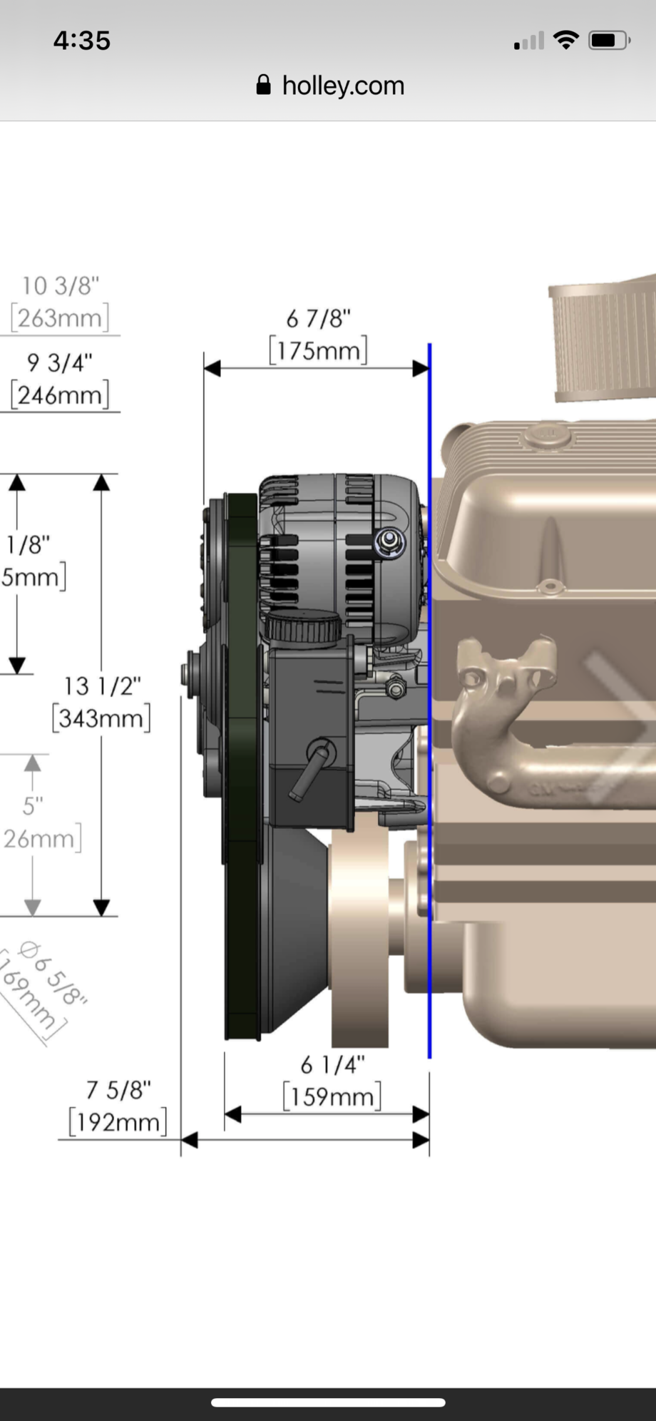

Assuming the radiator is in the same place in a big block, is there enough room to mount this system on a big block? It appears that Holly will be offering this system for the Gen V big blocks in late August of this year. It's really nice with billet aluminum brackets. The alternator is designed to withstand the higer rotational speeds of a performance engine. Looks like the PS pump is also billet aluminum. Looks like it'll cost something like $1700, which includes all the accessories, including an AC compressor.
Years ago, GM offered a serpentine kit for BB's. It's discontinued but can be bought from Summit. I bought this kit years ago, and returned it. The brackets are all cast iron with a cast iron water pump. Grossly heavy. I didn't want to put it in my car because of the weight issue.
Also, some time ago, I was interested in a March serpentine system for the BB. It was pretty pricey. The crank pulley was too large. It required cutting a notch in the crossmember under the crank pulley. No way. That cross member is not very strong anyhow. I asked if they would make a smaller crank pulley for me. Surprisingly they refused. Doesn't seem like it should have been a big deal. So I decided to forget March.

I have CVF Racing serpentine kit in the picture on my car. They do make a kit for the BB Chevy as well. Here is the link
https://www.cvfracing.com/chevy/big-...y-396-427-454/

Looks like BB pulley is 6.25 in from block face ..

Got the AC system all connected and charged.
Blowing cold and the s belt system looks great ..

On a BB with all the accessories moved to the front of the engine I don't see anyway to get it to clear the crossmember unless an under-drive pulley is used and not sure that even that would clear.
Moving all the accessories to the front they use a tall water pump and a crank pulley to match.
I ended up cutting the crossmember and filling it with a rolled plate to stiffen it up when I installed the Zoop's system (no longer in business).
