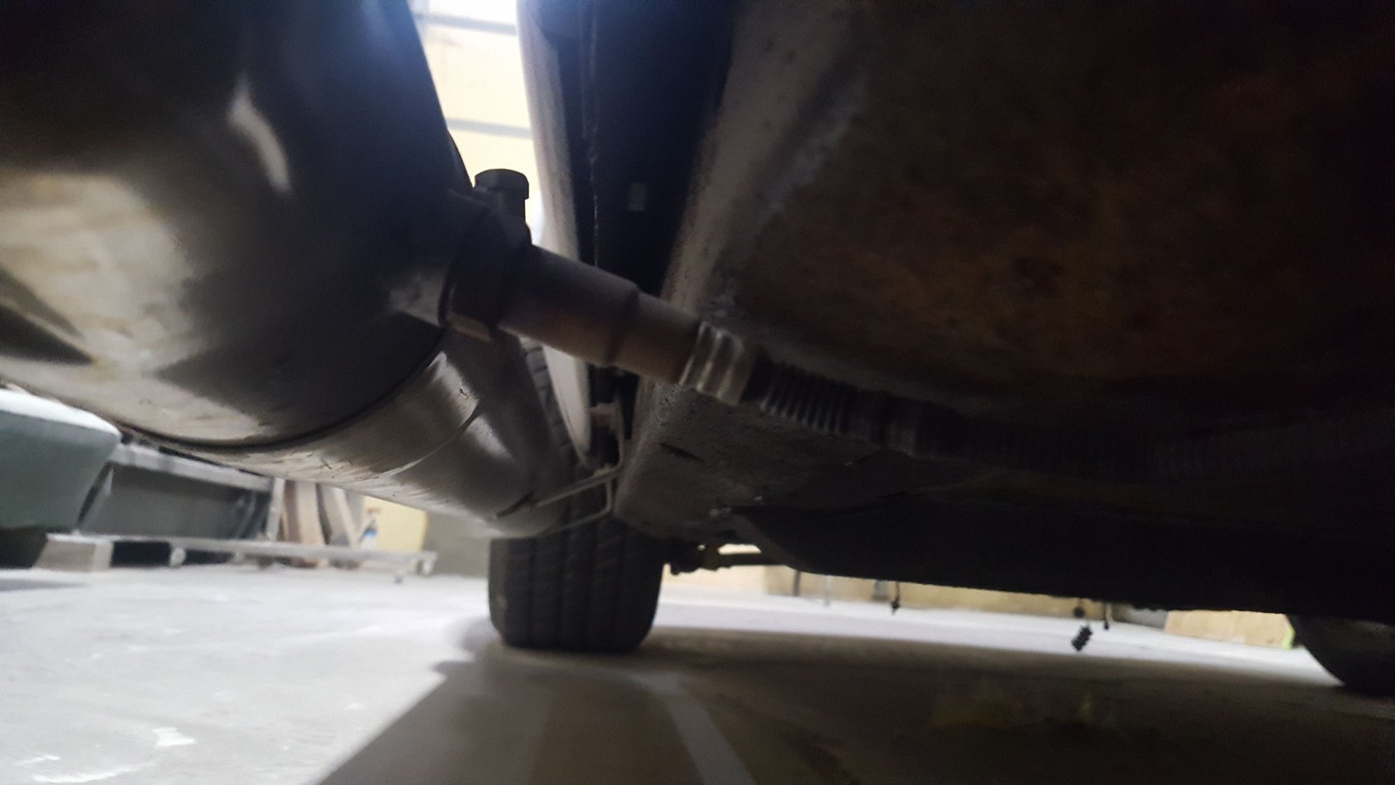

Has anyone attached an 02 sensor on there side pipe car for an EFI install? If so can you post a picture please?

I have Doug's but basically the same setup as Hookers. You are not going to be able to install it in the preferred position unless you go through the frame. Someone on here has done that but after looking at what needed to be done to route it that way, I chose to mount it in the header collector just forward of the side pipe with a slight upward angle. Here is what it looks like.
I did the same as yours for the same reason.

Mine is the same as pictured above and I used this HEATSINK to help prevent moisture damage. It's pricey but works. You can get a slight downward angle, or at least level, by doing what lionelhutz said above.
