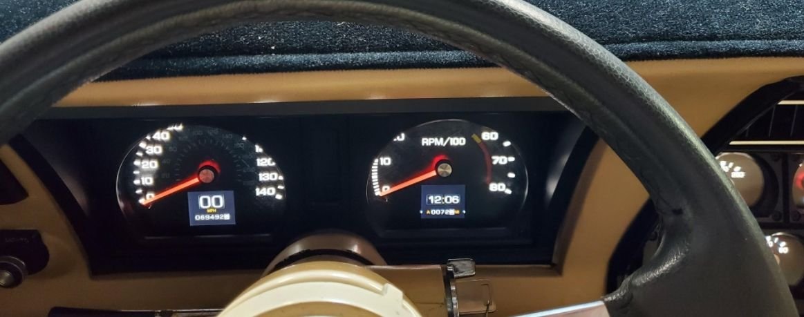

This is the driver view of the speedo and tach.
It's screwed into the same mount holes as the OEM cluster was - it looks like there's more room on the side by the console to come forward because I still have a few things unscrewed from other work, that will get pulled back when it's all back together.
I'm not able to pull the bottom of the gauge cluster forward due to interference with the steering column, which is what makes me wonder whether either the whole dash is sort of 'aimed downward' from where it should be, or maybe the column itself is out of line somewhere, though if I shim the column any lower it interferes with me.
I'm right at 6' tall and tend to sit with the driver seat slid about 75% to the rear - the only way for me to view the entire speedo/tach is to slide the seat all the way to the back and then slump down, so something is definitely not right.

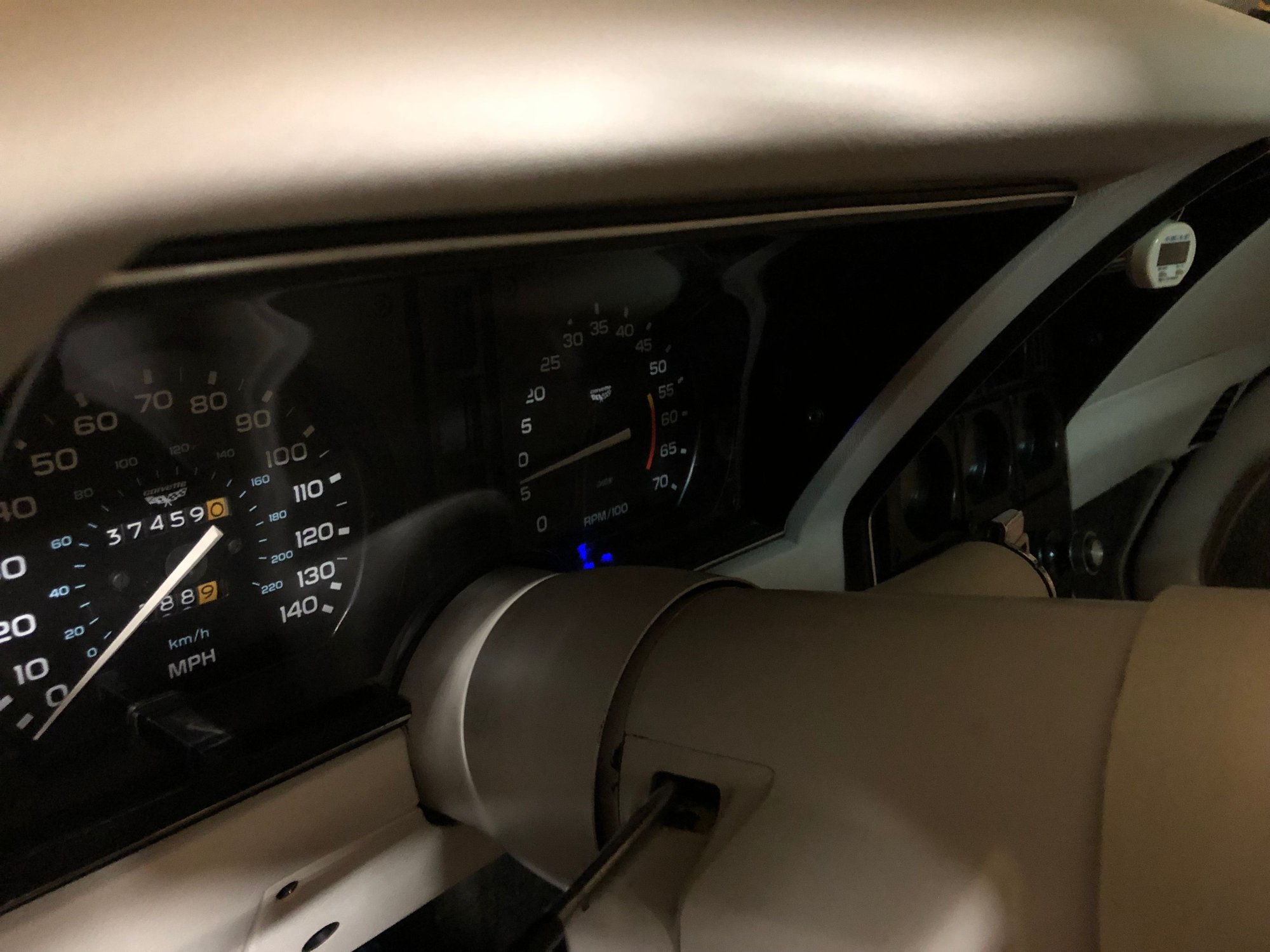

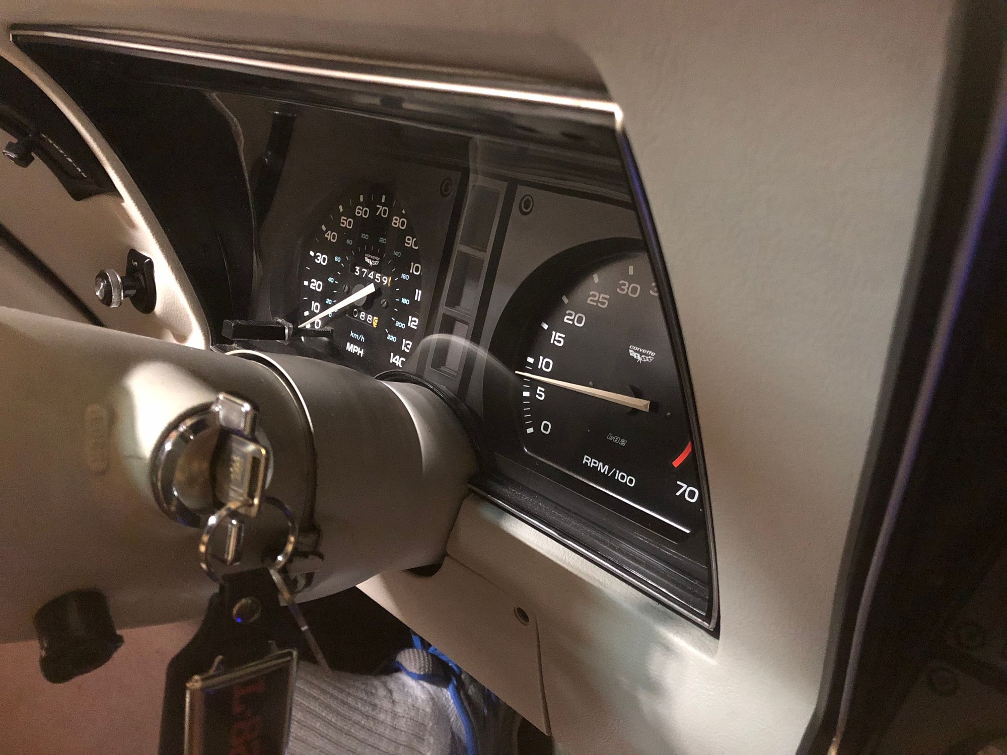

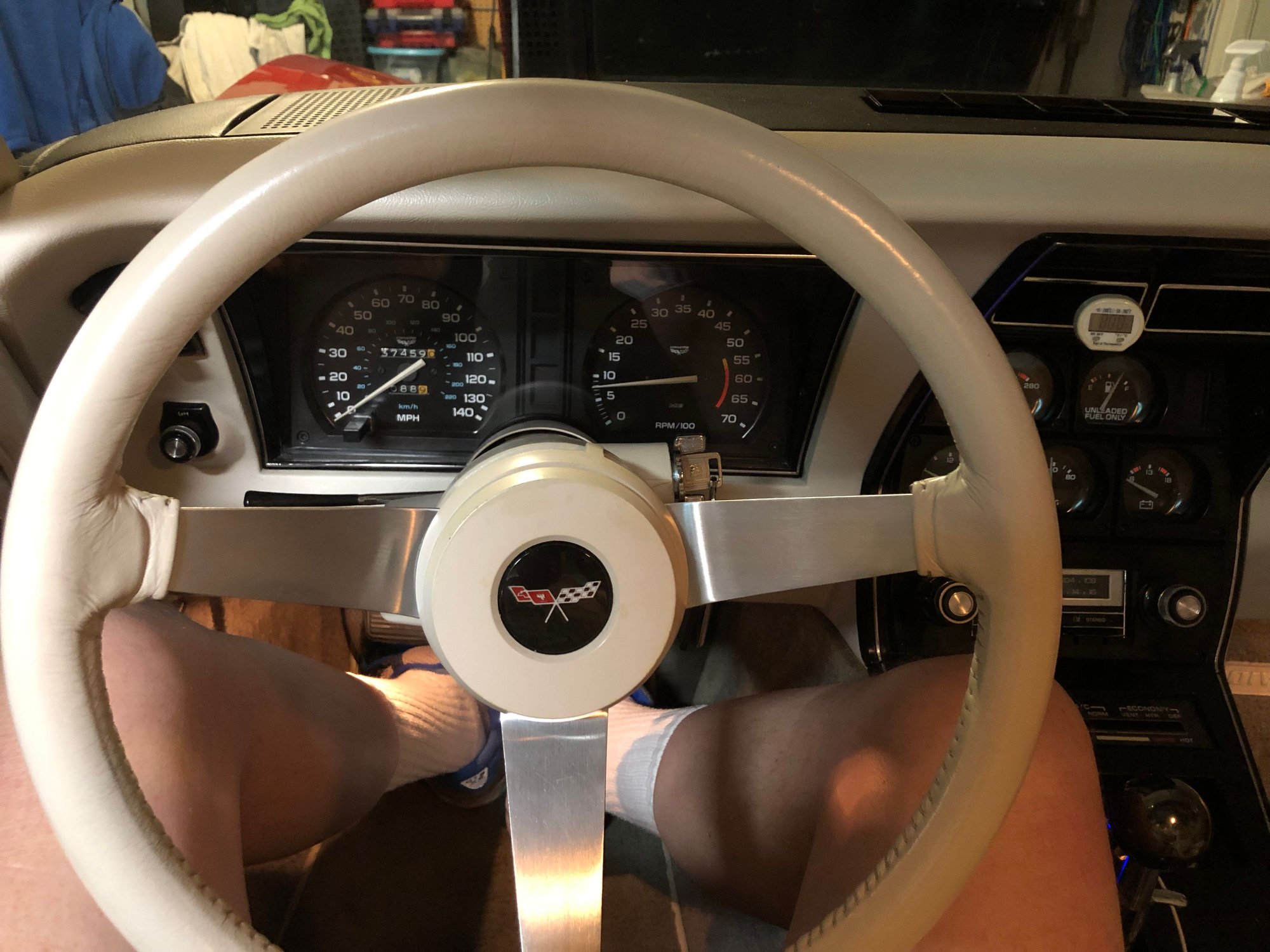

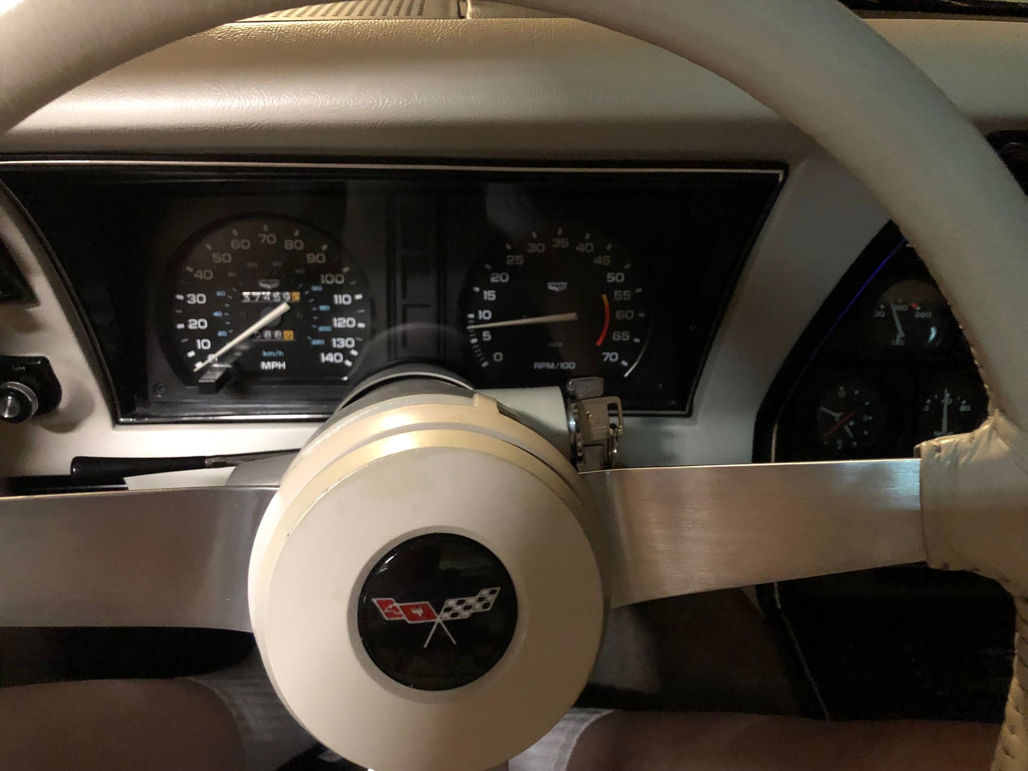

i can find no 3/4 or all the way back that limits my visibility.. 2 pics at eye level.. 6'3
yours does look jacked at depth points.. i snapped some pics if helpful..
79
