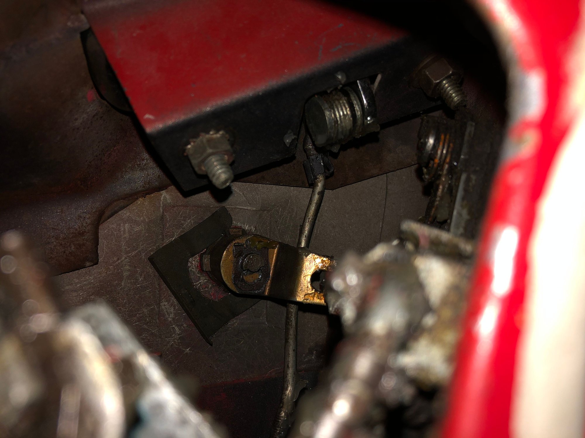

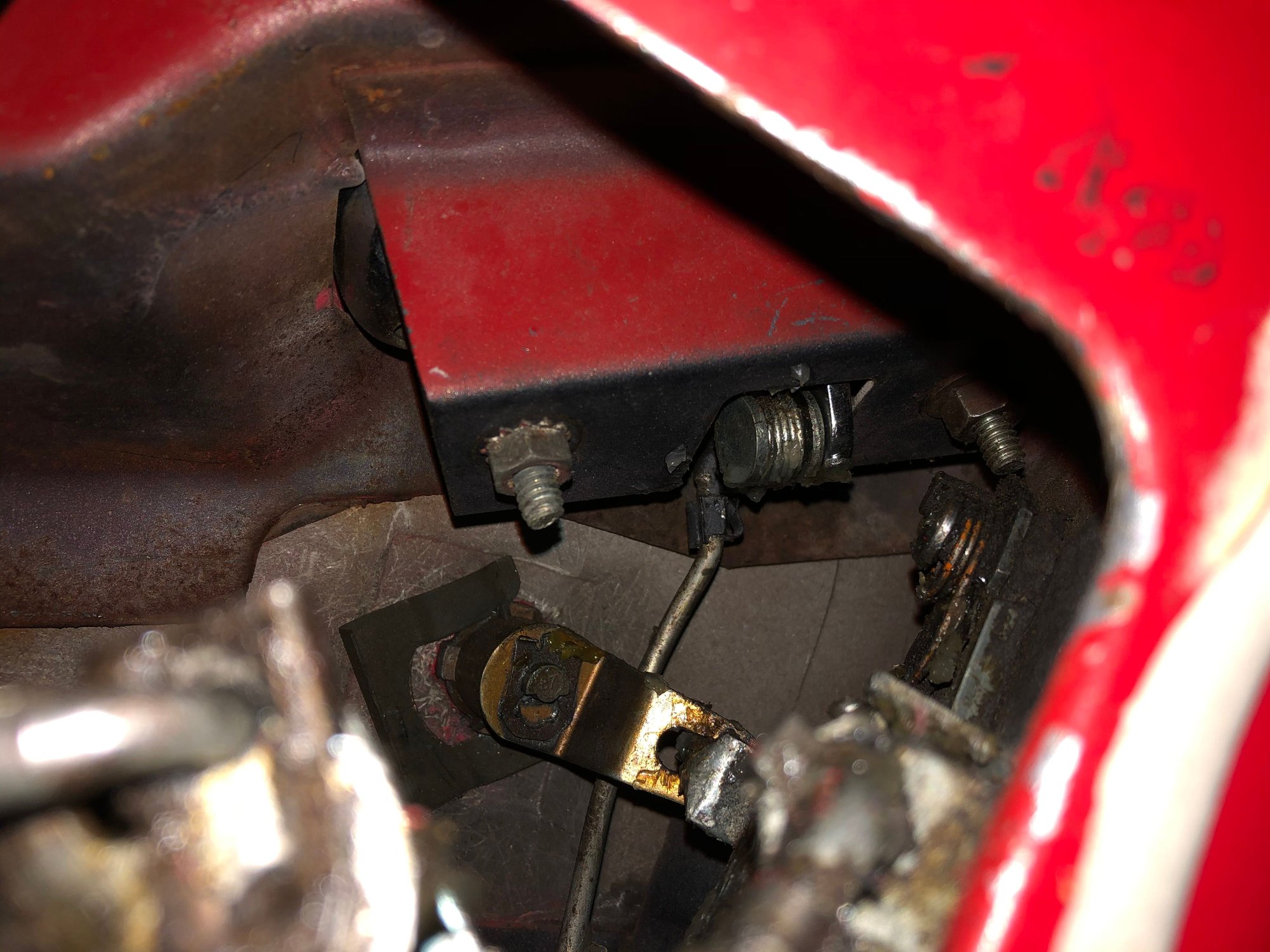

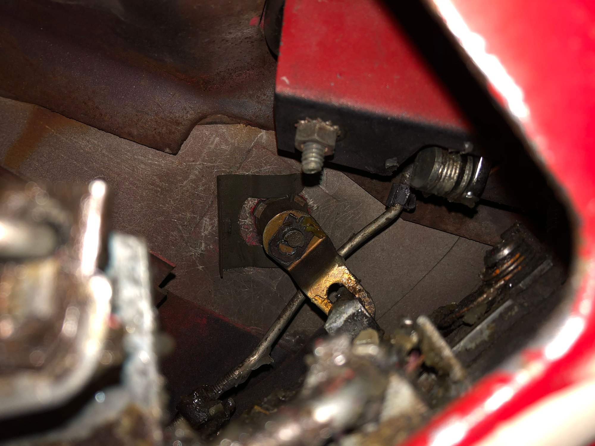

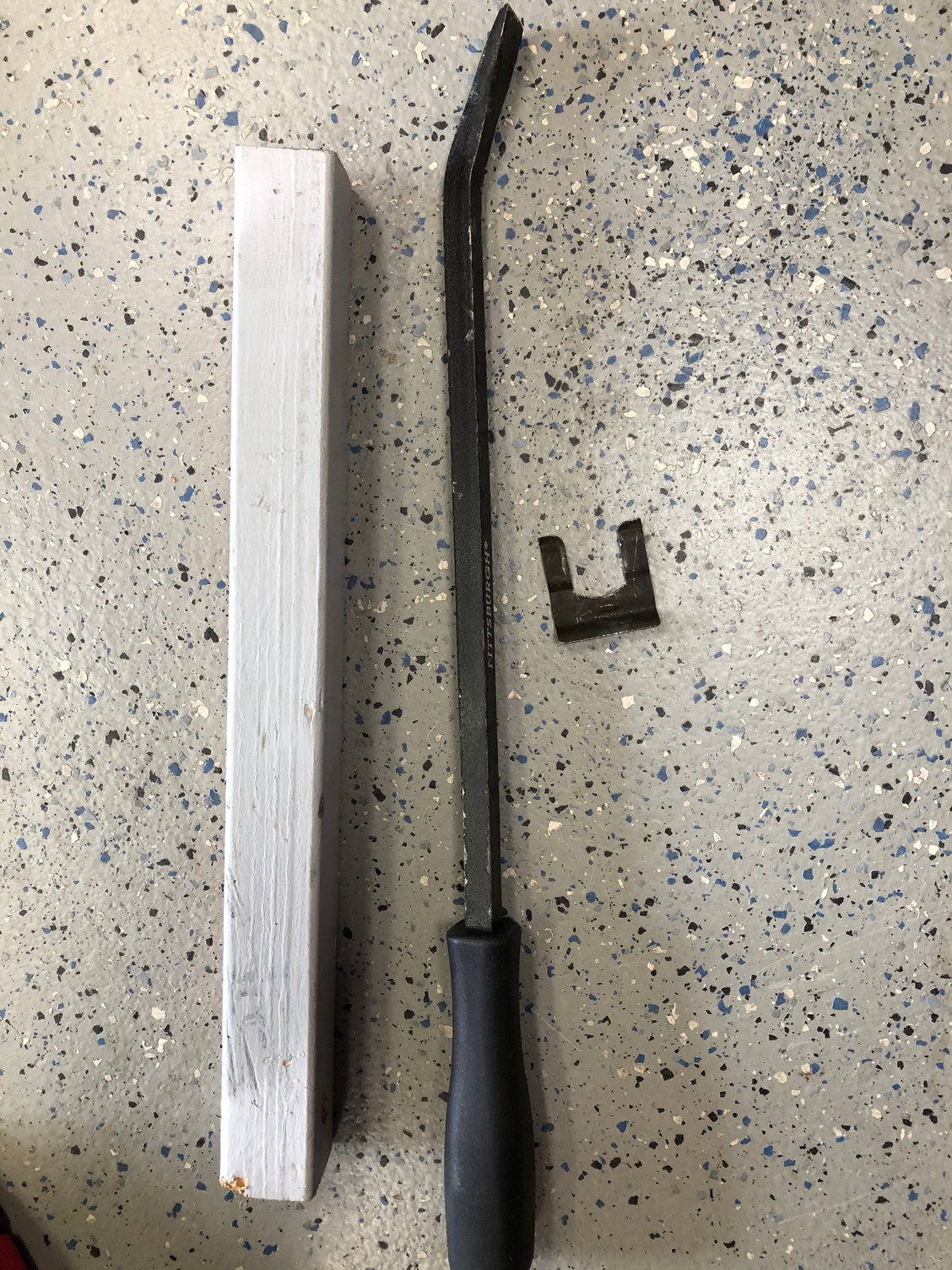

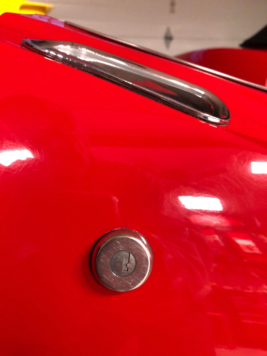

The last time I replaced the key lock, I recall turning the key didn’t move the lever on the door mounted latch/strike mechanism. Even though i took a tone of pictures the key lock was installed wrong. I will try and find the pictures, but you will have to remove the key lock and turn in around. Also, I recall there was a right and left key lock, but then it’s been a year and my memory gets cloudy. I recall it was a bear trying to get the snap bracket
(inside the door) to hold the key lock. I took a picture of the tool (I made) so next time it won’t be so painful. Good Luck
Piece of wood with a HF pry Bar to push the clip on the key lock
Orientation of the key way in the door
Getting ready to push the clip all the way over the key lock. The position of the arm and little shaft on the key lock is critical
On the shaft there is a small clip that turns the arm when you insert and turn the key
Picture of the key lock orientation
