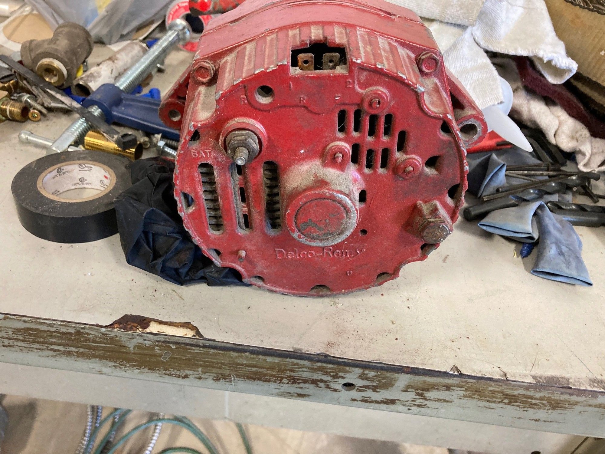

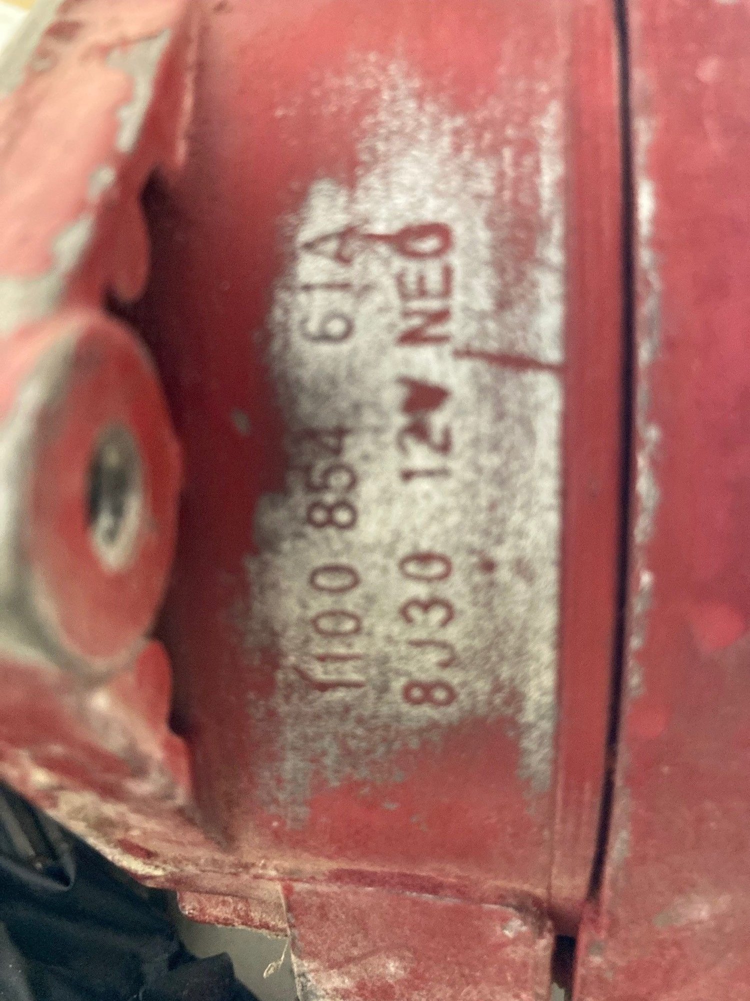

hello, new member here. I do not own a corvette(unfortunately). I mostly deal in GTO's. while cleaning out my shop I have a few parts that I believe are for corvettes. these parts will be for sale but I would like to make sure that I ID them properly. first is this alternator. Is the rear case incorrect on this ?
label these properly. the first is an alternator. 1100884

That is an 854, not an 884. The date is September 30, 68, so it would be for a 69 model year. The rear case is later. Not a Corvette part.
