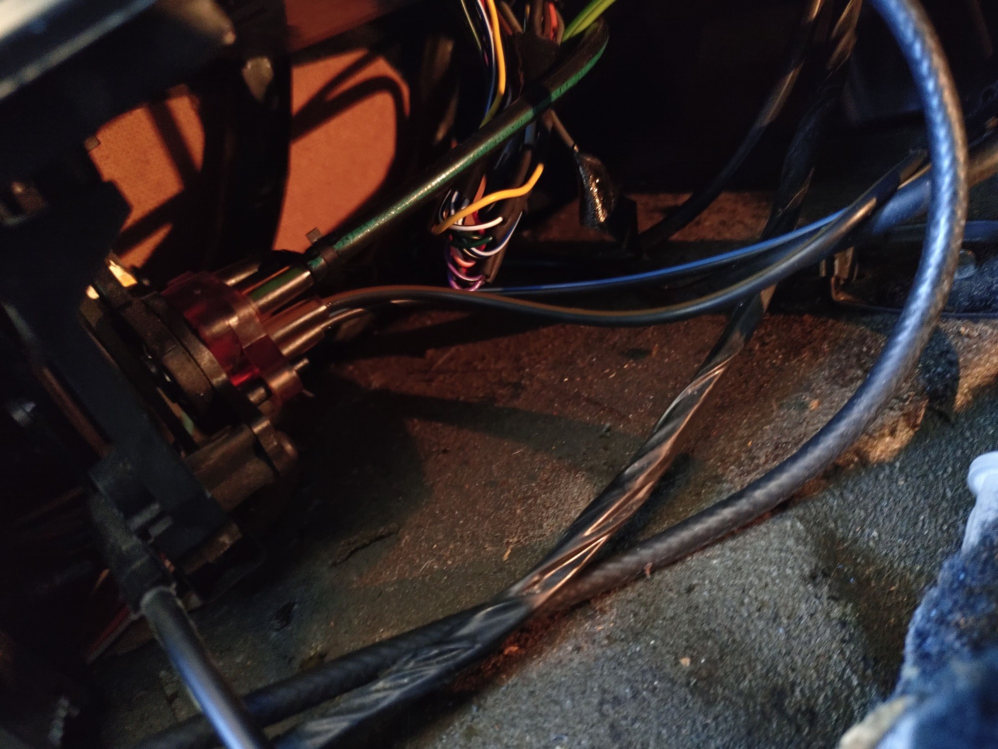

My 1982 vette will only blow air out the bottom heater vents. Cold/hot controls work. Air clicks on and selector will shut everything 'off.
No defrost and no vent, just bottom air. Looked at vacuum lines behind controls, all connected. I do not hear a vacuum leak. At a loss how to proceed. Really need defrost to function. Thanks!
