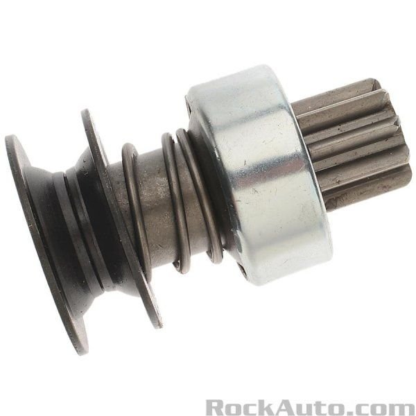

From: Little Rock AR
You need to replace the starter drive (bendix is a common name for it) with a Standard Motor Products "SDN1A" available from Rock Auto for about $10 or on Amazon for about $17. This "bendix" here is a one way clutch and drive gear assembly on the starter shaft. Yours is shot because it now rotates freely in BOTH directions so it can't turn the flywheel anymore and the starter motor just spins away. You pull the stater motor off and take it apart to replace this part. Not really difficult. A few bolts and a snap ring.
Alternately, you can replace the whole starter.
