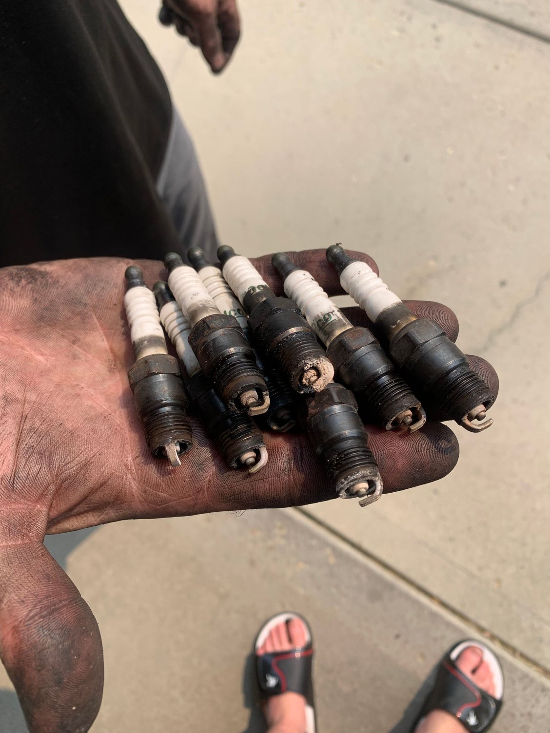

I’m having a slight shake at idle on my 81. It levels out at speed but the shake is notable while idling. I just changed plugs and #5 was not very tight. Attached is a picture of them and the one with the fouled white was the loose one.
I tried to have it timed today as well and there is no mark that is noticeable. The mechanic thinks my distributor might be dropped in wrong. That would explain the rough idle I believe.
I think the distributor needs to come right out and dropped in the correct position.
Thoughts?

I would clean and reinstall all the plugs. They all look to be running hot though.

Smells rich at idle is fairly normal. It really does sound like balancer has shifted. I am a mechanic. I would be checking the timing mark with a piston stop in the number one cylinder. But it really sounds like a new balancer is in your future. get one with timing marks out to 60 degrees. You'll thank me later.
