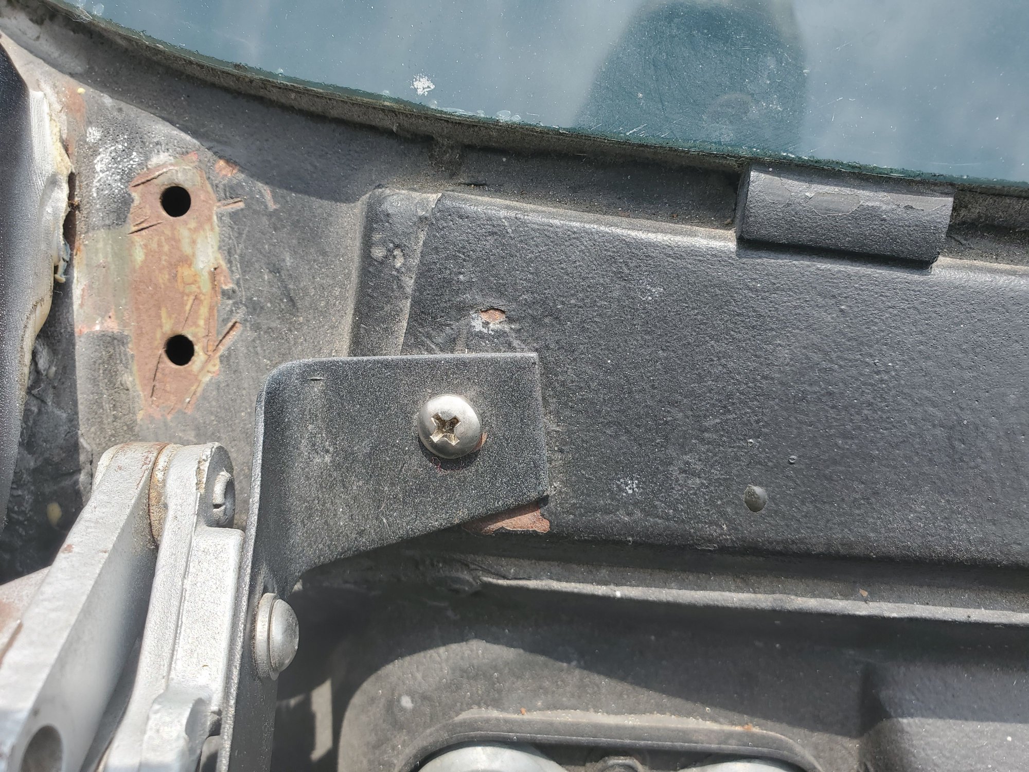

I have a 69 Corvette and I've attached a picture of the firewall under the wiper door where there are two holes on driver/pass side of the firewall. Please advise what goes in these holes and thanks in advance for your input to my question!

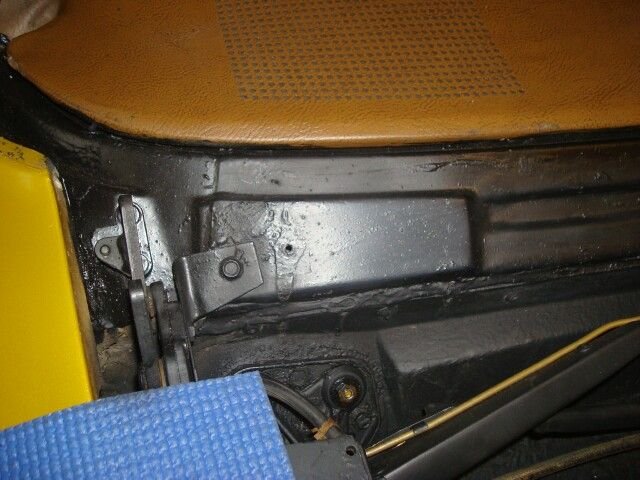

I believe that is where the open stop for the wiper door is located. I have a picture of that area but not a good one:
Looks like somebody took a grinder to it.

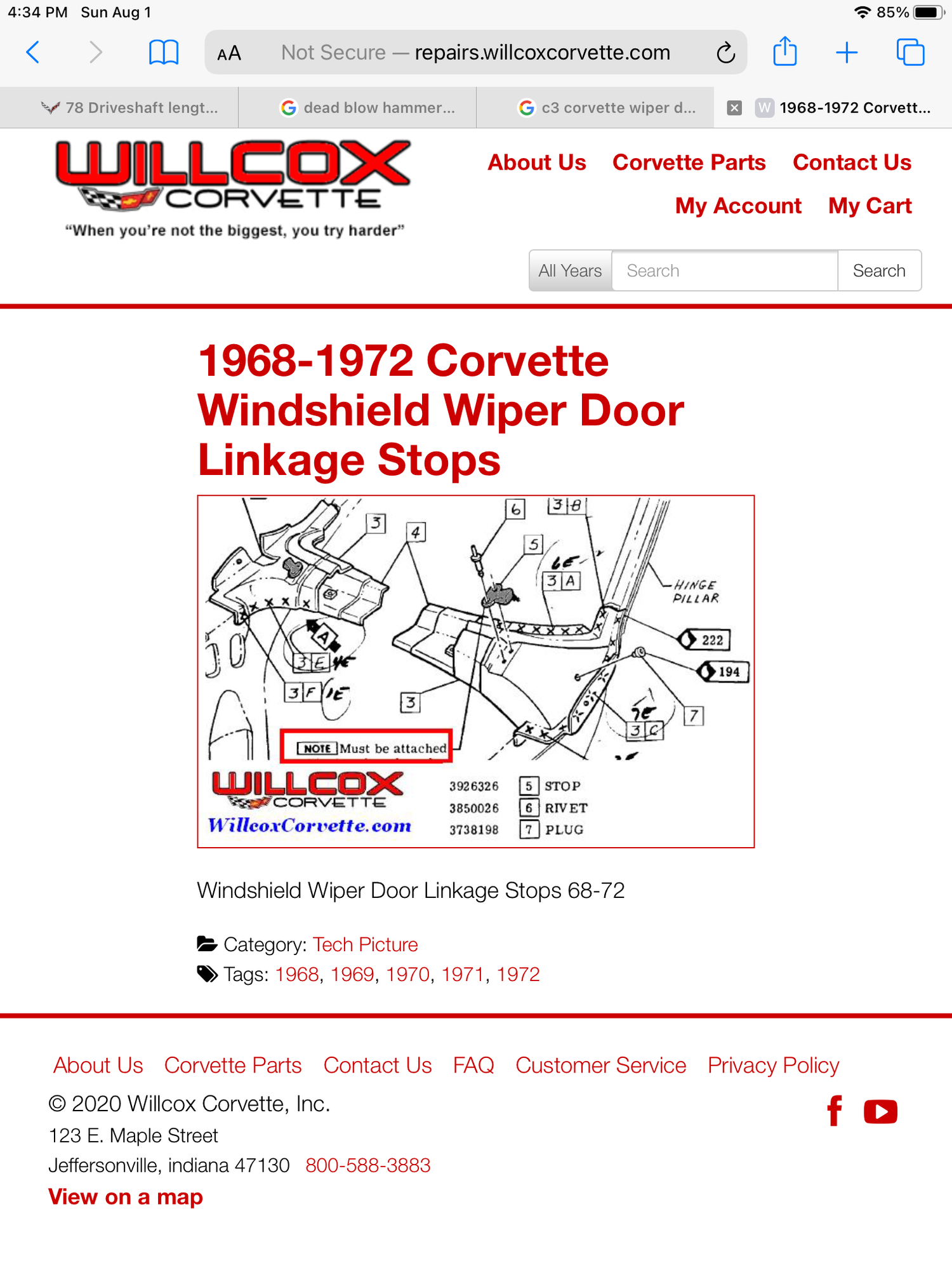

Wiper door linkage stop
