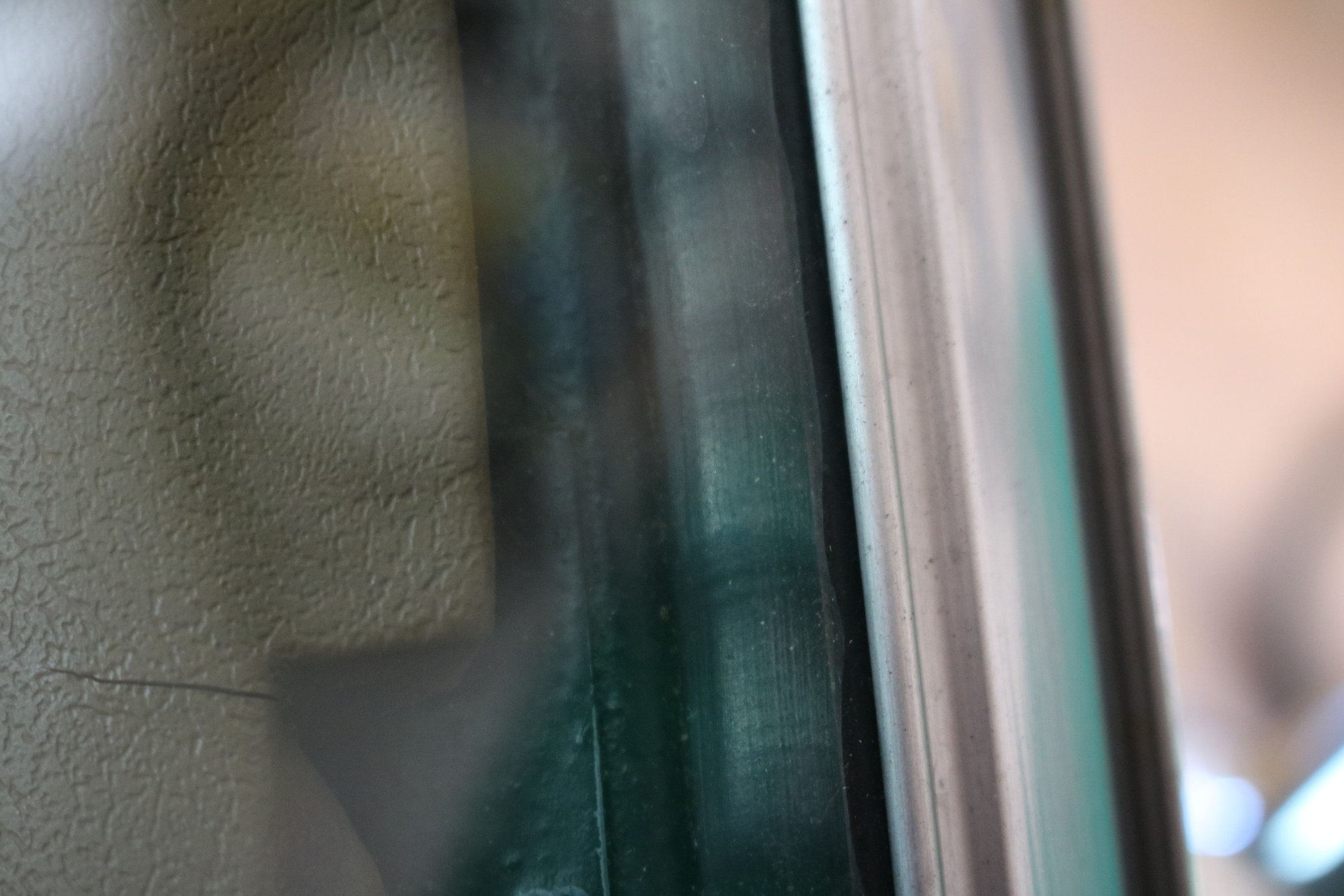

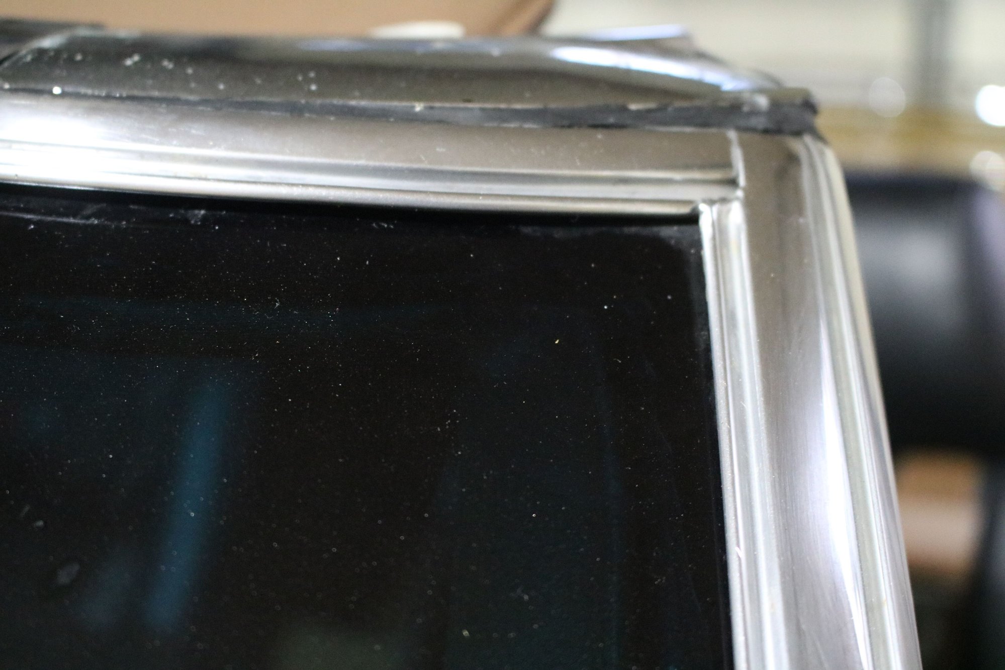

The old butyl tape was thicker than the adhesive they use today as they only need a little to hold a modern windshield in. My Safelite installer, being a muscle car guy, knew this and applied a thick bead when installing my new windshield. This way the molding fits flush as it should. I had already cleaned up my pillars and applied POR-15 then a top coat of spray can.
See how thick he put the goop on.
Nice and flush
