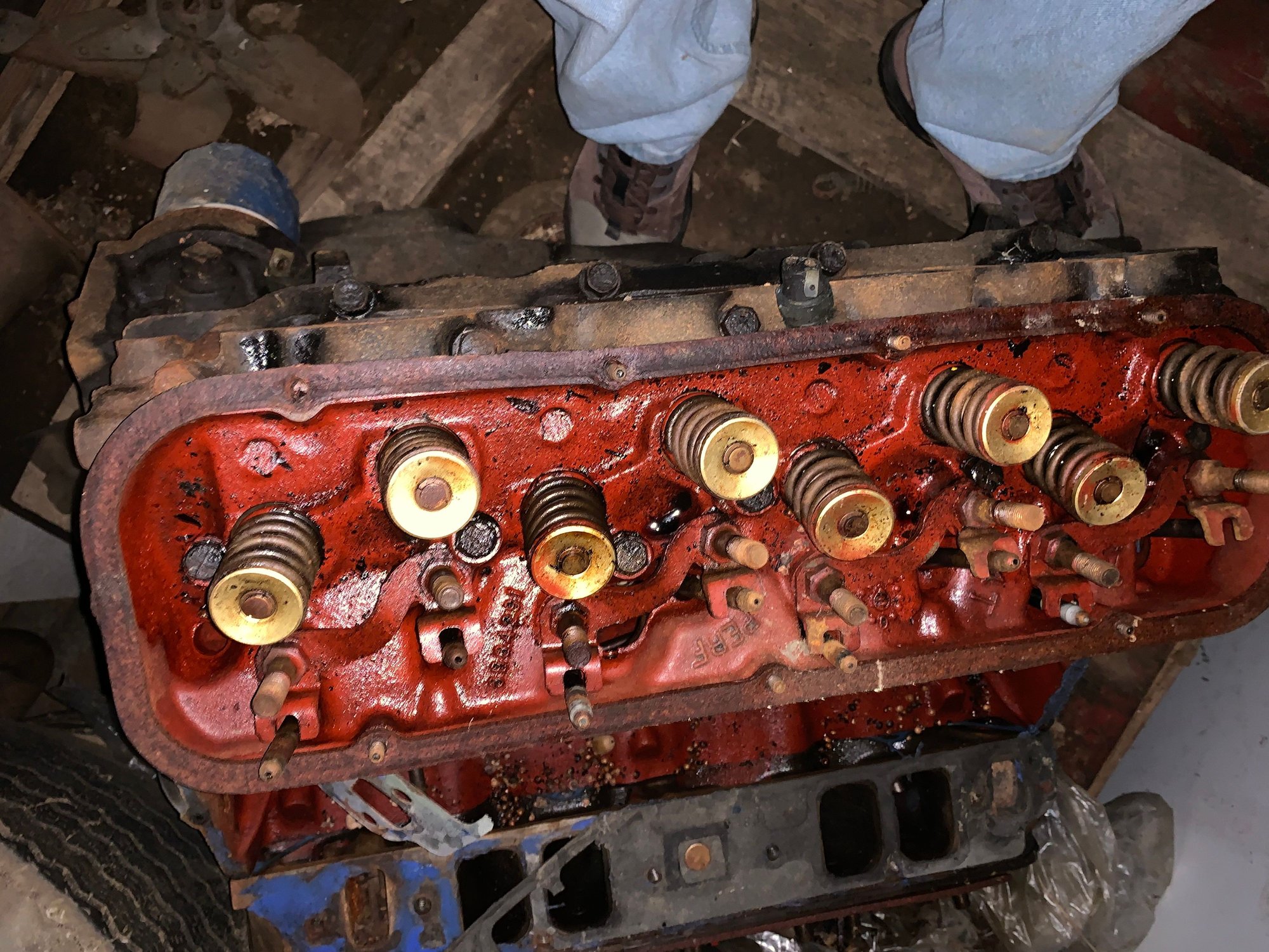

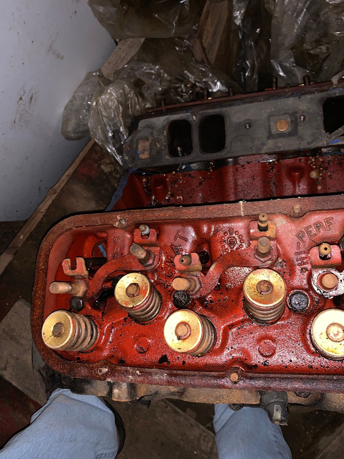

I found no number on the block anywhere except the 3969845 but here are some pictures of the heads

The Valve Spring retainers are not Original. It looks like the inside of the Square Port Heads have been painted with Gyptal paint. All very common late 70's early 80's Performance mods. If You can not find a Serial Number on the Head surface this means the Block has been Decked. So what does this tell Us. The sky is the limit. We know somebody has been inside there before Us, so we have no idea what Pistons, Rods, Crank or Cam lye below. The only way to find out is to take it apart. If I was looking to buy it I would be using a Bore Scope threw the Plug Holes. If You see shinny Cylinder Bores and Domed Pistons then things are looking up. If You see Flat Pistons with 4 Valve reliefs and a Rust Spot at the out side of the bore where it meets the Piston Top then You might be looking at scrap. All it takes is one Teaspoon of water to get in there and you have a Rust spot in any Cylinder and it will probably will not clean up with .030 overbore. If the Block has been Decked then You can figure it has also been bored .030 already. . However I think 396's have a lot of meat in them to bore.

I'm Seeing Gyptal Paint inside the lifter valley as well. This Engine has spent some quality time in a Machine Shop. Who knows what expensive High Performance parts lurk with in. Bu Oh No some of the Valve Tips are Rusted ! This means its been stored in a Rust environment. Use due caution and expect the worst.

So I missed the picture with the Serial Number so it would appear that the Block has not been Decked. And it also looks as though the out side of the Engine was never painted ?? If so it could mean the Engine was never installed in a car after leaving the Machine Shop. I'm a bit concerned that the Push Rod Guides are Painted with Gyptal. What Machine Shop wouldn't bother to remove them before painting ? Maybe the painting wasn't done in a machine shop at all and done under a shady tree.

Looks like aluminum spring retainers in the picture

Yikes, even the Valve Springs have Paint on them along with the Aluminum Spring Retainers. I'm changing my tune from spending some quality time in a machine shop getting Gyptal Paint to spending some time under a shade tree getting a Rustoleum Rebuild.
