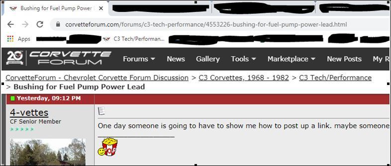

Here are the instructions. So let’s say the thread below is the one you want to create a link to. All that black is just me hiding all the links I go to regularly. Don’t get excited – it’s mostly aviation stuff.
First thing, copy the link by using the mouse to point at the address and clicking the left button to highlight it. It will look like this.
Now, press the right mouse button to pull up the copy/paste menu and select copy.

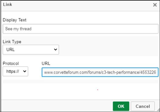

Then click on the little link icon at the top of the new post box.
That will bring up the following box.
Fill in the text you would like to use as the link, e.g. See my thread, and paste the address into the URL box.
Now it looks like this.
Hit OK and the link will look like this in the post.
See my thread
