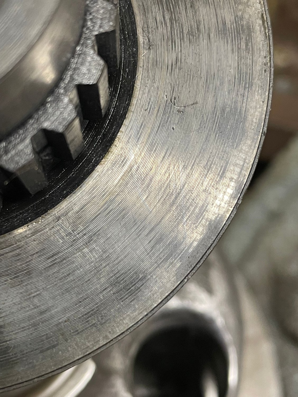

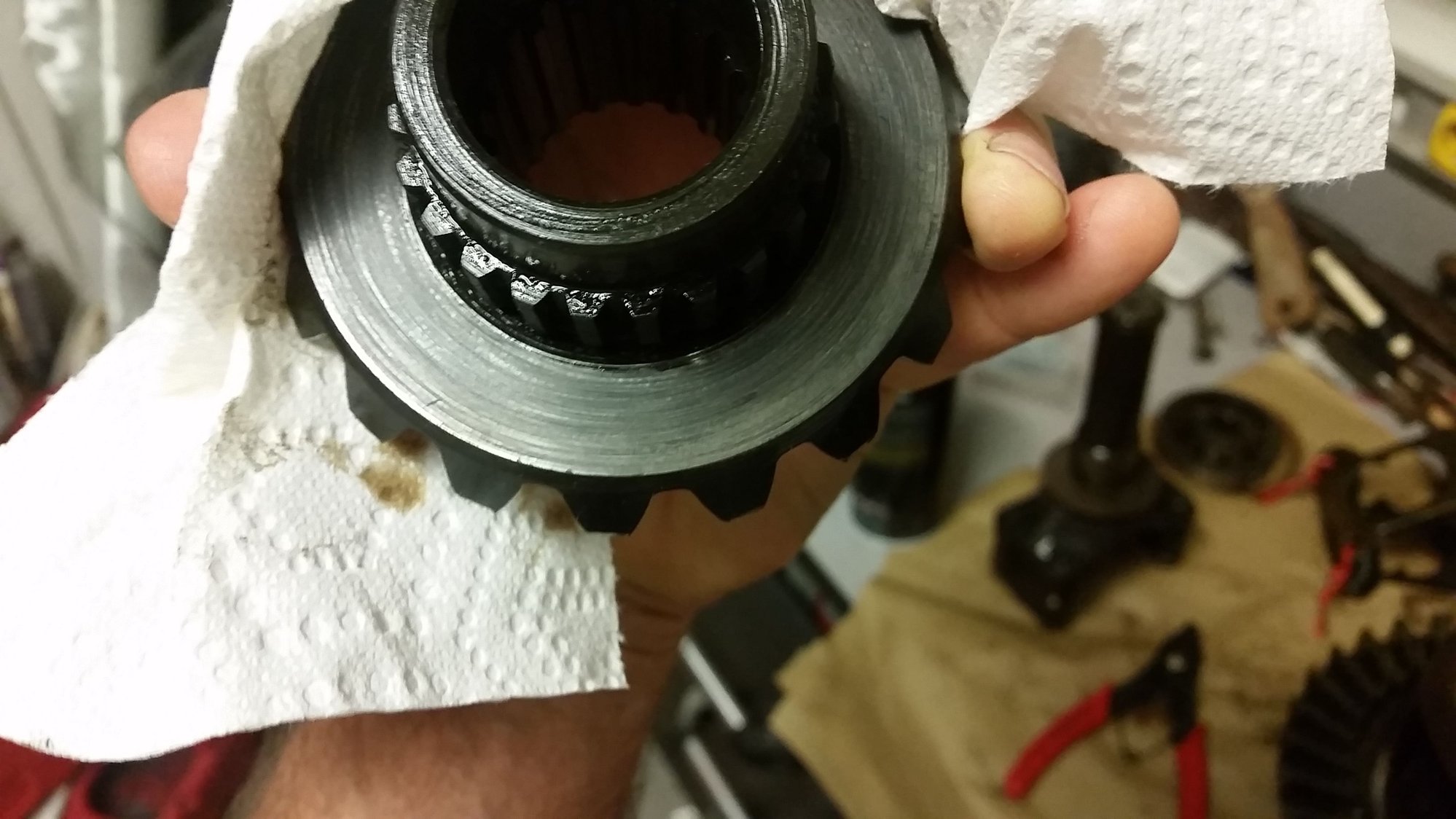

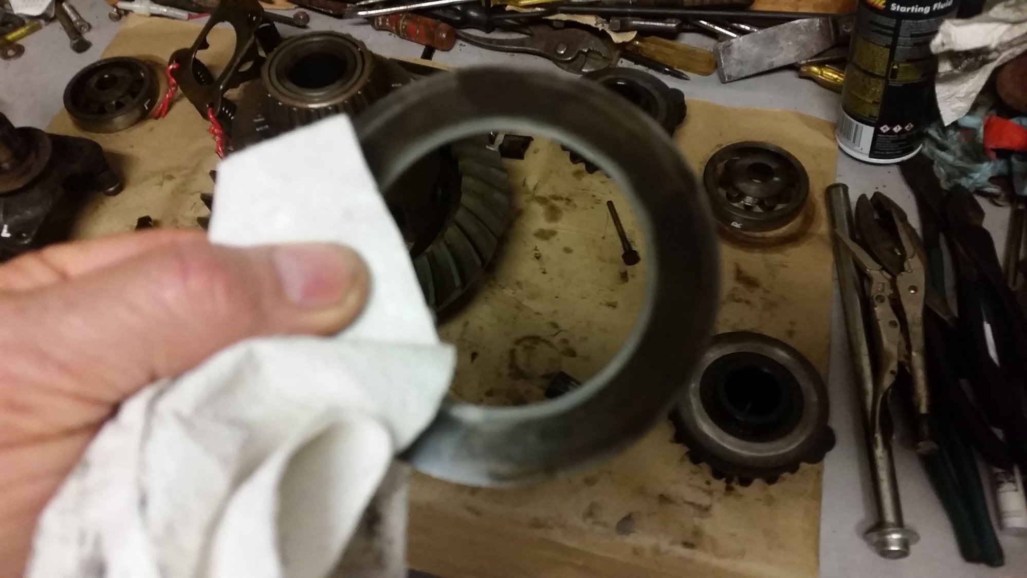

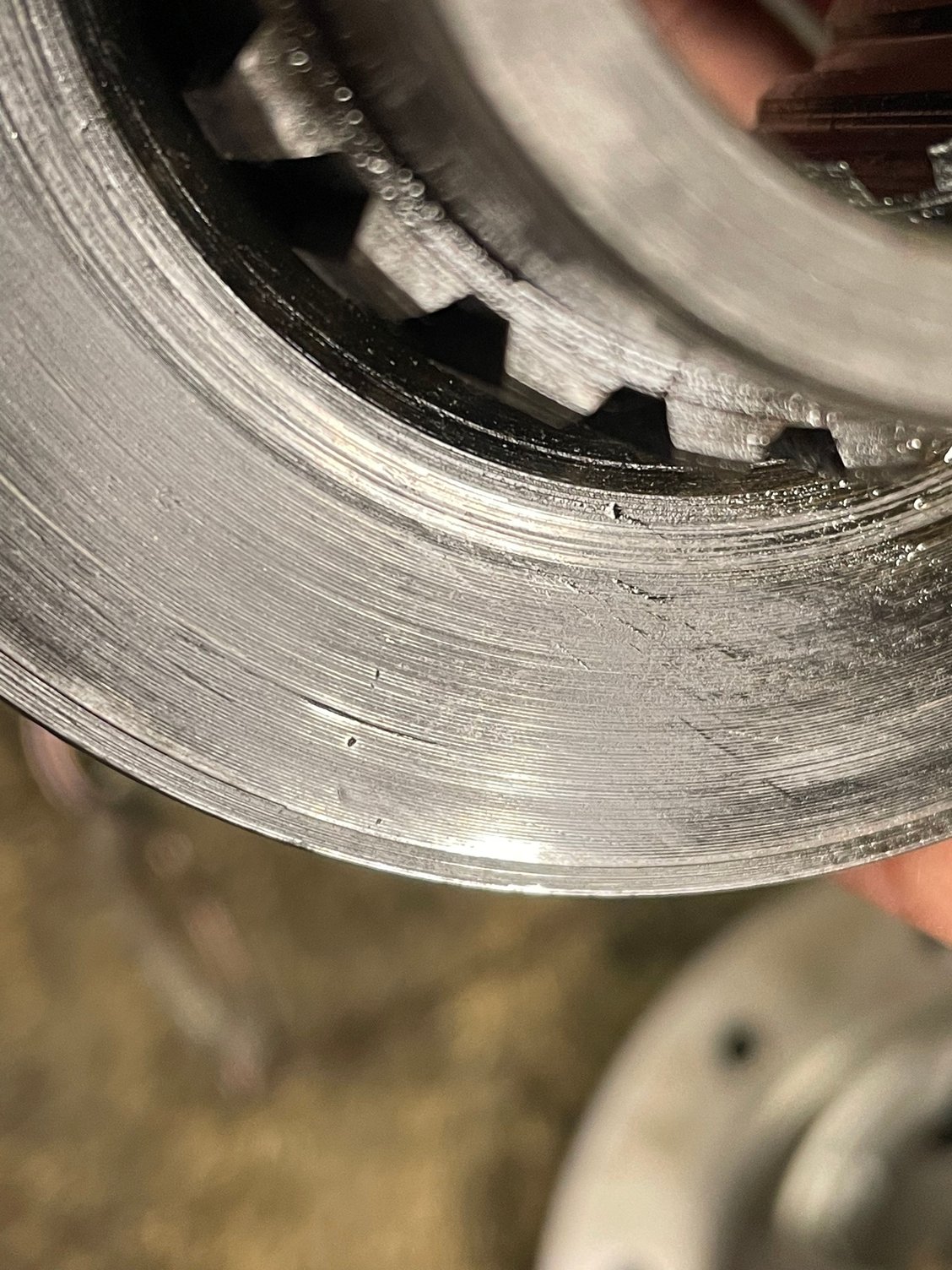

This is the gear out of my posi case. Is the surface shown supposed to be perfectly mirror smooth, or are the shallow circular grooves normal? (they look deeper in the picture then they are) The other gear has a small pit in this surface but there is no sharp edge at the top so I don't think it's really an issue. Also the shims have discoloration. Is this a problem?

The slight grooves you are referring to is a normal condition.
As far as the shims go, as long as they are flat, you should be fine but if you have any distortion, best to replace them.
