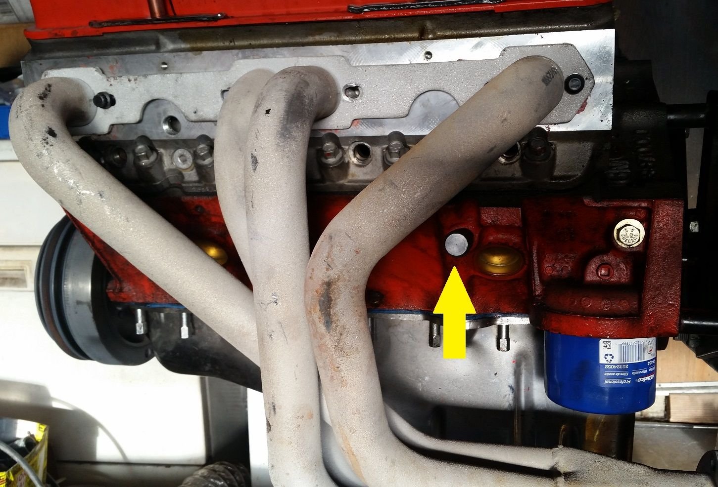

Question for you Auto-to-Manual Tranny conversion Mechs: Is that square-drive plugged hole where the Z-Bar's end pivot ball screws in to?

No, that's a pipe plug in an oil port.

Quote: No, that's a pipe plug in an oil port.
That's what it looks like to me too. But I am ignorant to the manual tranny setup.

Forward of and below plug #7
GOT IT!

If by chance you are unable to drill and tap your block, all is not lost. A bracket is made to position the ball stud that bolts to the bell.

Be careful tightening the ball stud into the cast iron block. Don't over do it.

Quote: If by chance you are unable to drill and tap your block, all is not lost. A bracket is made to position the ball stud that bolts to the bell.
Thanks! Sorta like an L-shaped heavy gauge steel thing huh?

Quote: Thanks! Sorta like an L-shaped heavy gauge steel thing huh?

Yup that's it. I used one on a friends 74 years ago......it did the trick but because it put the stud a little further off the block, the z bar had to be made shorter to fit.

Quote: Yup that's it. I used one on a friends 74 years ago......it did the trick but because it put the stud a little further off the block, the z bar had to be made shorter to fit.
Thanks John.
Since I have to weld the outer Z-bar end bracket on the frame, I could compensate any extra length there.

Is this the hole (with the bolt in it)?

Quote: Is this the hole (with the bolt in it)?

Yes

Aug 27, 2021 | 10:57 AM
Done!
No Header clearance issues here.
Thanks folks.
Steve
P.S.: Please note BRASS Freeze Plugs employed.
