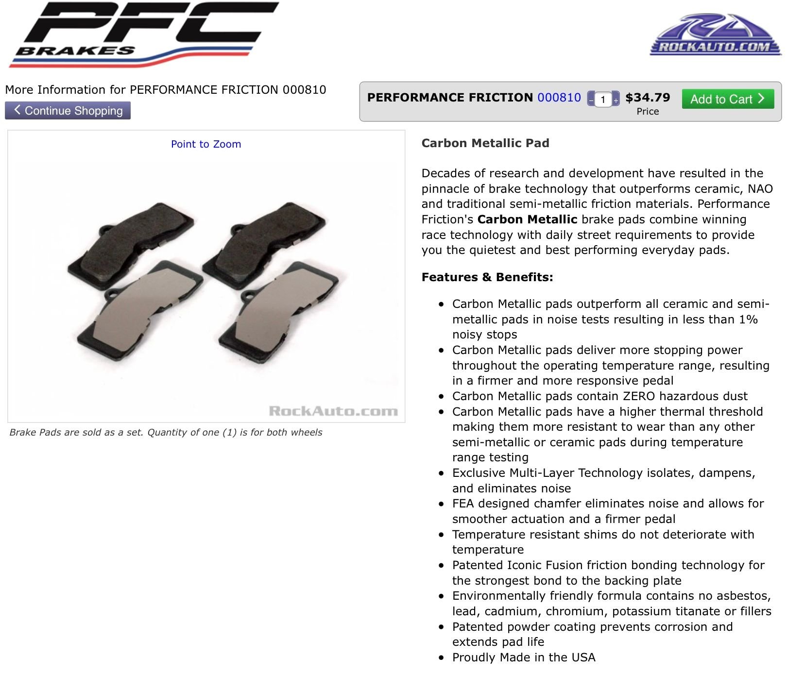

78 vette is getting new brakes, new solid rotors front and back (fronts where .030" under min spec), new rebuild Oring high heat stock calipers and SS brake lines. Pads are next and I know stock is organic but not a fan. Trying to stay on budget as all these brake upgrades were NOT planned so I'm trying to minimize damage. Plan would be to stay under $100 total for front and back. With that in mind and this car will be street driven only (400hp or 650hp if I can fit the supercharger on a 5.3LS) so better than stock stopping is a must. Semi Metallic has better bite but its harder on rotors and more dust vs the ceramics. So I think I want to choose between the 2 pads below. They are within $6 of each other but wanted to hear your guys thoughts. I normally try to run ceramics now a days in my DD cars due to dust and noise but used to swear by wagner semi metallic back in the day for my fun cars. I realize they are harder on the rotors and are dustier than ceramic but the car will have limited driving so I would rather have better performance with that low mileage. Since I don't have the OE rotors anymore I'm not too worried plus I go the cryo treated centric front rotors so hopefully that helps combat the aggressiveness of the metallic pads.
Centric - Posi Quiet extended wear - Semi Metallic - 1060080
Performance Friction - Carbon Metallic - 000810
I think I'm leaning towards the performance friction as I've heard good things about them from searches on the forum regarding the lower dust and better bite. Rotors are here (will check run out) and I've already started painting the calipers and the new SSBinc high heat Oring kit will be here soon so I would like to order the pads really soon if possible.

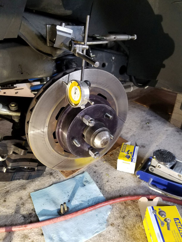

CHECK YOUR ROTOR RUNOUT!
I read that thread before, its where I first heard about the 0008.20 vs the 0008.10 versions. I want to get away from the organic and I run Hawk pads on my firebird which came in the BAER brake kit. Corvette will be street driven and cruised but I don't exactly drive easy on the street lol.
I will shoot for less than <.005 run out on the rotors since I will have Orings.

I have been using Performance Friction Carbon Metallics for over 20 years on MANY of my cars including my 78 C3.
They are by far the best street performance Pad I have used in over 40 years of driving: Tremendous stopping ability with extremely linear brake bite, totally unlike most pads that grab harshly and dangerously with semi aggressive brake pedal pressure, the harder you brake, the more PF pads bite with zero street performance fade, none to little dust, no noise, and literally will last 3 X as long as most performance street pads along with being VERY affordable, not outrageously priced like most high performance street pads which will not perform as well.
No Brainer!
GO PF Carbon Metallic (NOT THE Z RATED Autocross pads). A PF Z rated pad will be dangerous to use on the street if the pads are cold especially . Using A PF Z rated pad on a street driven car will feel like no brakes when cold and is very dangerous!
The advantage of a regular street Performance Friction carbon metallic pad is that linear pad bite will not upset the brake balance of the vehicle upon initial brake pedal application which is extremely important under severe braking, panic stops, and hard brake during inclement weather.
Do not walk but run from ceramic pads which were designed for quiet operation, long rotor life, with at best, fair street brake performance. Most Ceramic pads are junk......

Fun fact, I got in touch with the designer over at PFC about the 0008.20 and 0008.10 pads. They have discontinued the 0008.20 pad which was a 42 compound and they weren't a big fan of that compound. You can tell what you have with the imprint on the pad puck that says PFC-42 or 44 (the number is the compound). The 44 compound was formulated for the 0008.10 pad which they developed further and now the new 0008.10 pad has the most up to date new formula 44 compound and is designed for street use and occasional autoX. It has more grip than organic and ceramic and less dust than both, has very low rotor wear despite the higher heat and grip. He said the biggest customer base for them is the trucking and school bus/buss industry and as you know lots of heat and heavy use in those industries. They also have a specific break in procedure which they can email you.
So here are the take aways:
  • No longer offers the 0008.20
  • Updated 0008.10 uses new formula 44 compound
  • Designed for the street and more
  • Similar to ceramic for wear, dust and noise but offers more grip and pedal feel/moderation
  • High heat formula
  • Requires special bed in procedure and even different for new or used rotors.
I ordered the PFC 0008.10 from rock auto for $92 (front and rear) with shipping and taxes so stayed within my budget.
