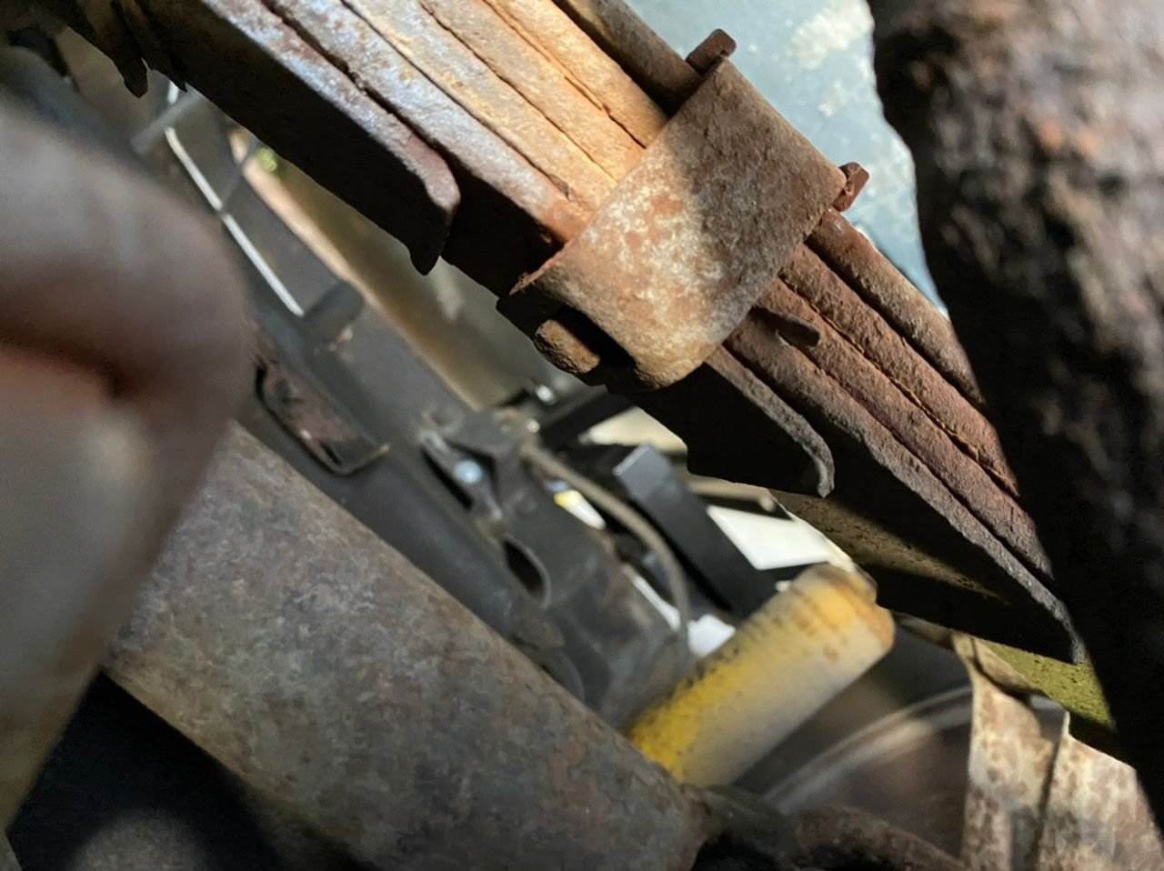

I found some more information about the 1980 gymkhana (FE7) rear spring in my NCRS judging manual and on the NCRS technical forum.
the 1980 FE7 rear spring is a nine leaf spring. The part number for the FE7 spring is 14021604 and it was stamped in yellow on the bottom of the spring. All nine leafs are .229 inches thick. The shims contain ZINC and are .02 to .03 thick. The leafs were painted grey. Width is 2,5 inches. There is a band around leafs 1-5 on both ends of the spring. See attached picture of the band on the FE7 spring on my 1980 L82. The stated spring rate on the NCRS technical board is 294 lbs / inch which matches what’s stated in the Vette Brakes catalog. This same spring and part number was also used 81s and 82s.
