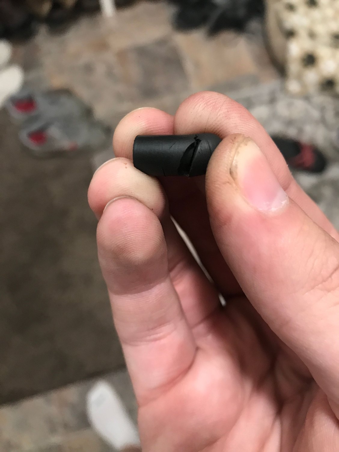

Well guys... sometimes its the easy stuff that gets ya. I tore down the carb this morning, cleaned all of the passages. Put back together, car ran the same. Looked over vacuum lines again, carefully. Didnt notice anything. Went to the auto store and grabbed a vacuum plug kit, plugged all of the ports on the carb. Then look ked at my ported vacuum port, which is plugged. Thought, ‘might as well take it off and put a new one on, and when I did, the plug disintegrated and ripped wide open in my hand. Put a new plug on, reconnected everything else, and she ran perfect. If the plug showed any signs of wear, I missed it. Thank you everyone for your help.

Sounds like Factoid got it right. Thanks for reporting back. It was lean but not for the reason you thought is all.
