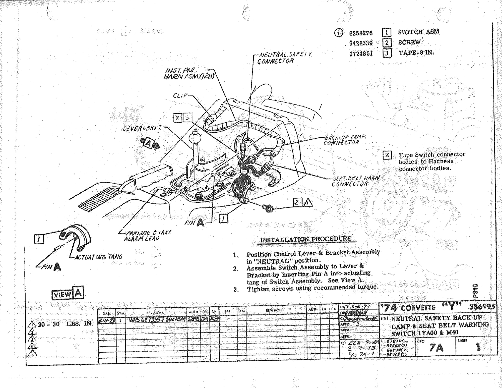

FWIW, that "sensor" with the wires on it is the kickdown for the TH400.
The neutral safety / reverse switch with it's limited adjustment in on the side of the shifter. You need to remove the shifter plate to get at it.

The cable can be fixed later, your problem is the NSS switch is out of adjustment or gone bad but adjust first

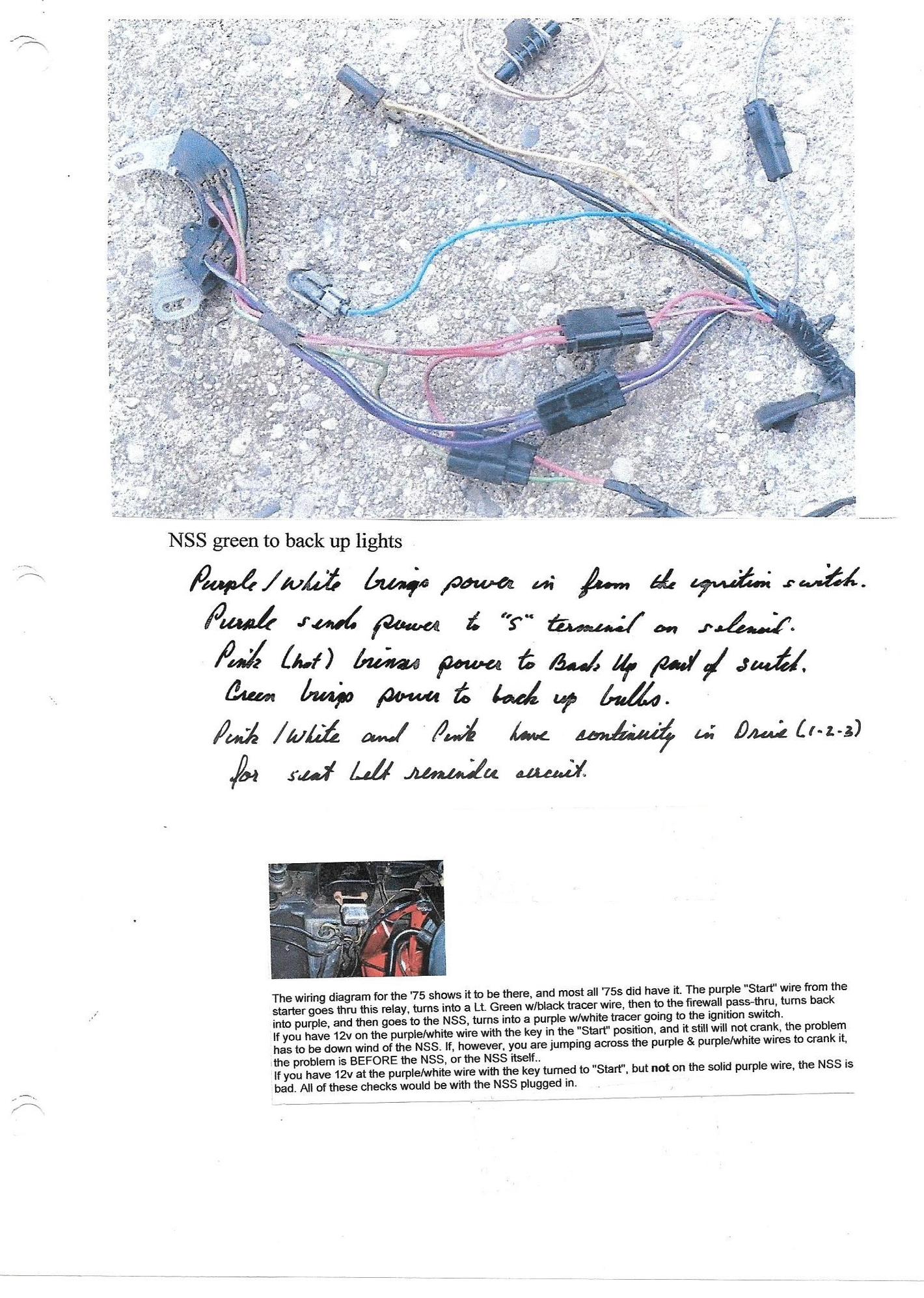

Default Read this

I would think your reverse switch would need adjustment. That cable may be your shift cable. Can you have some one run it through the gears while you see if it moves. YOur neutral safety switch would be out of adjustment if the car wouldnt start
They are one and the same switch on Corvettes with automatic transmissions like wiesleya posted in his pic. Only standard transmissions have a separate reverse switch.
