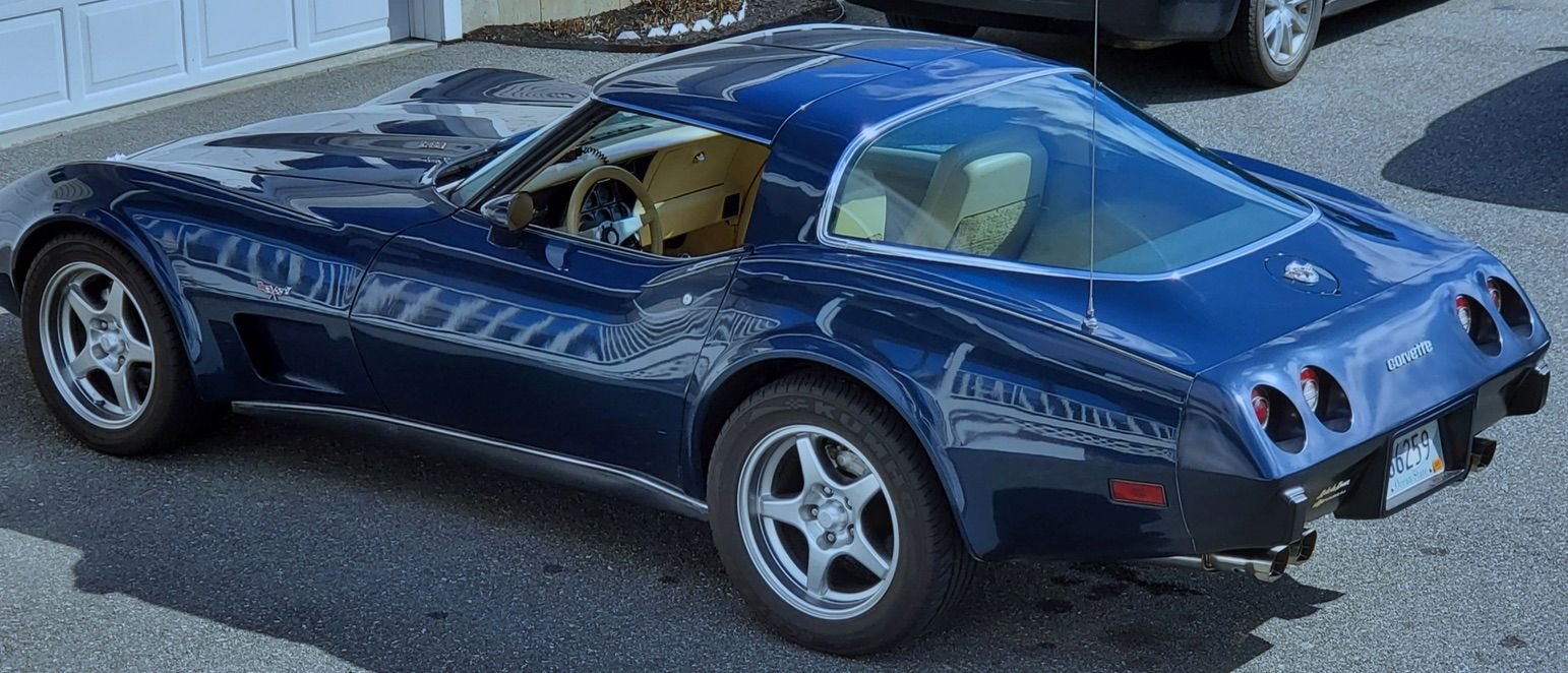

I bought the true dual exhaust system from Corvette Central with Magnaflow hideaway mufflers for my 78. These are louder than normal mufflers so you would need to like the sound. A couple of forum members commented that they can hear me coming into their neighborhood. The only problem for me is with 3.70 rear I am at 3200rpms on the highway sometime I cannot hear my phone gps directions.
This is the muffler: https://www.corvettecentral.com/c3-6...6q%3d323066%2b
and their system

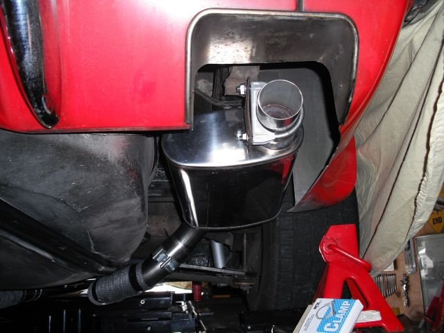

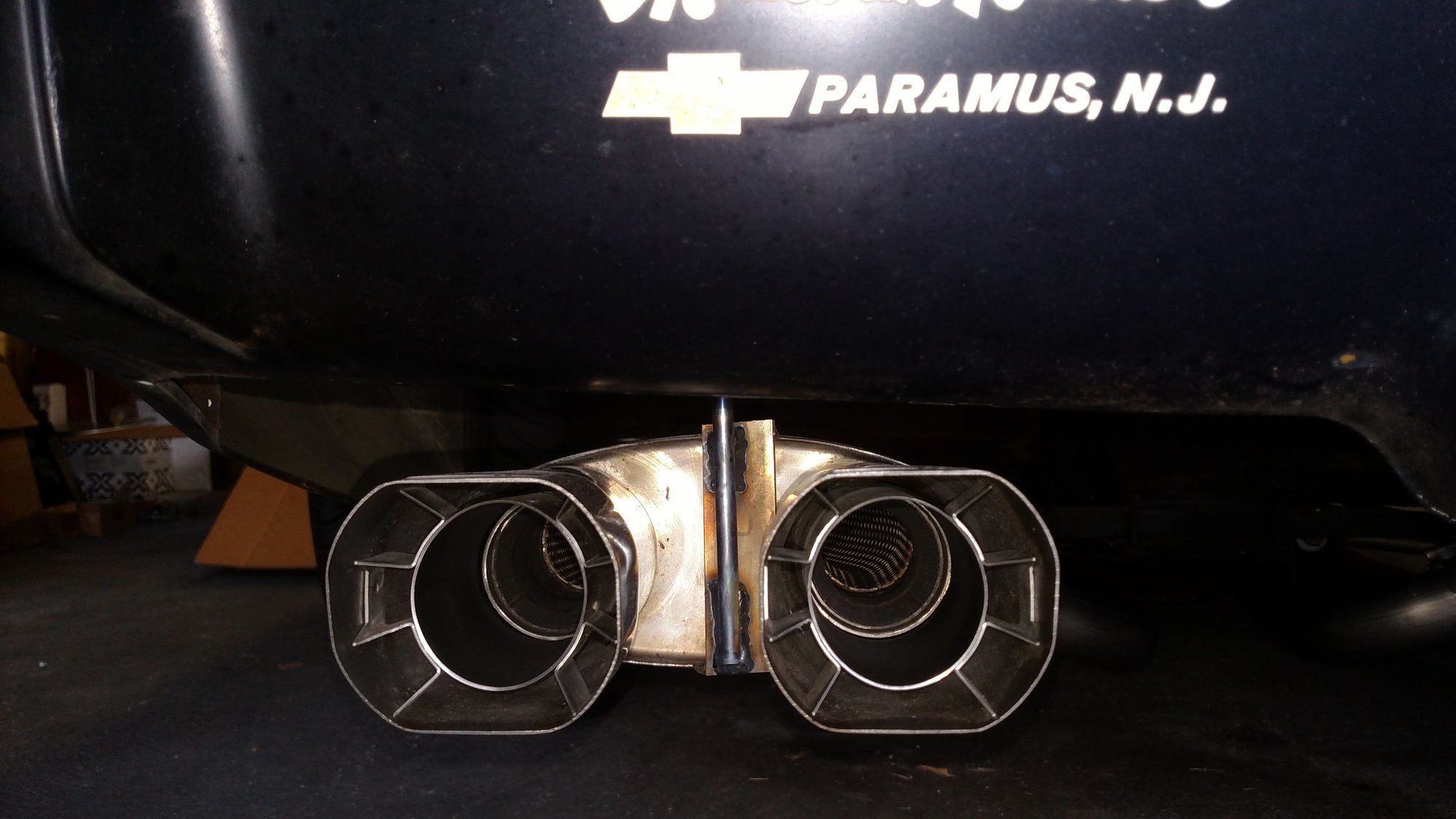

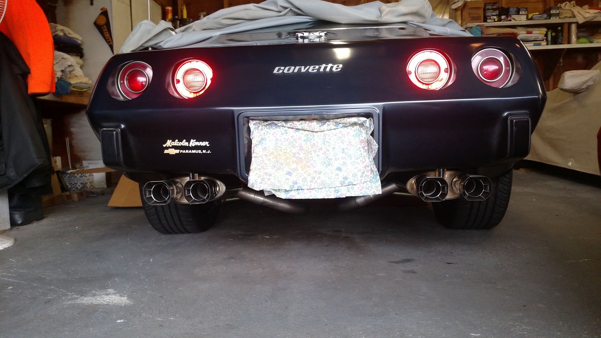

Here my 92-96 Square Tipped C4 Borlas Type S-I found them as an open box and stole them for $400 for the pair. One muffler had a VERy slight bent tip that I straighted easily. These Borlas below are made superbly, top notch quality:

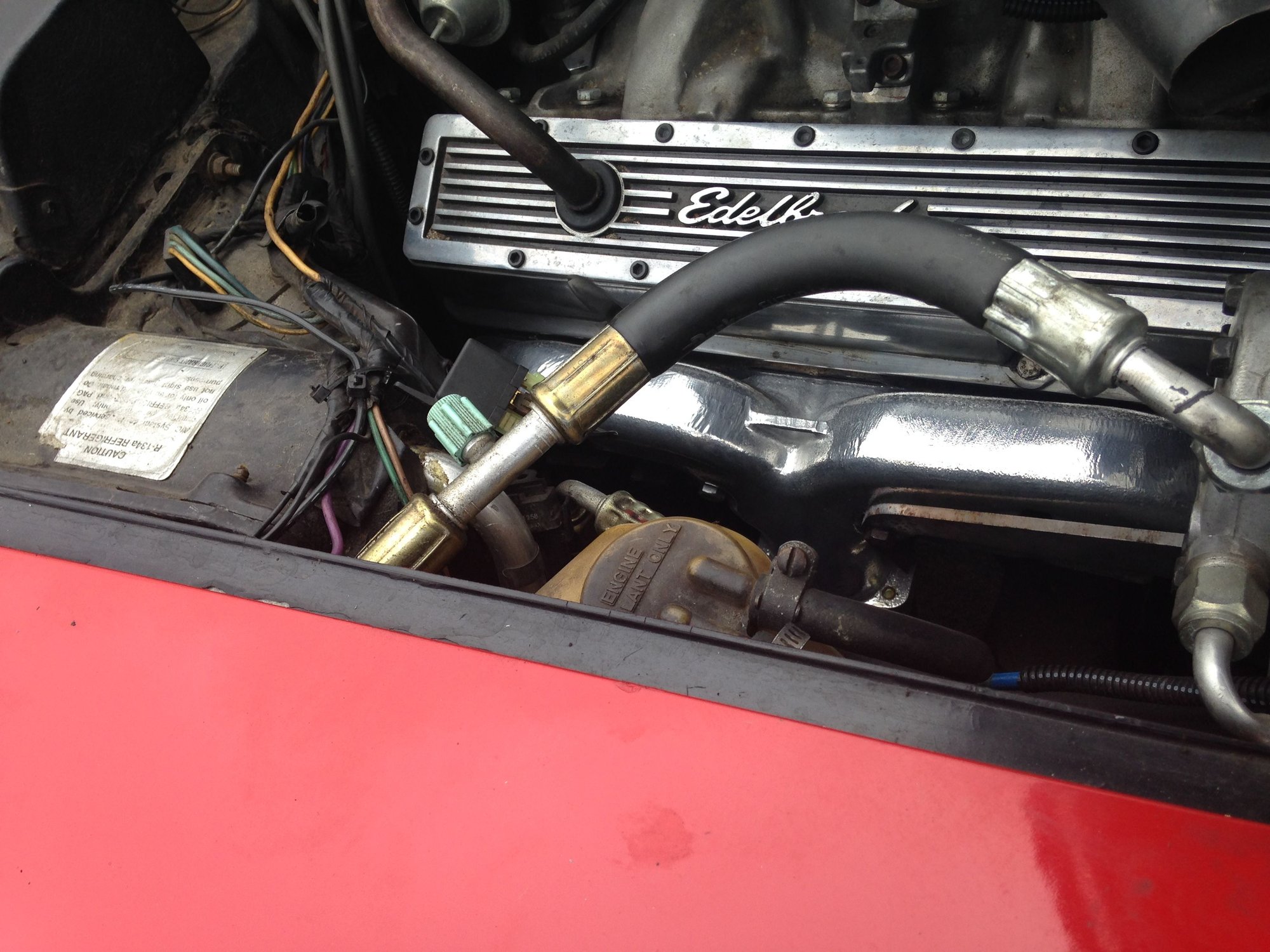

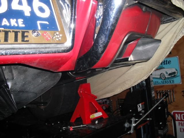

If you like a raucous sound, here's my Magnaflow exhaust. I mellowed it out (the after) with an H-pipe crossover, but it's still pretty loud whenI get on it.

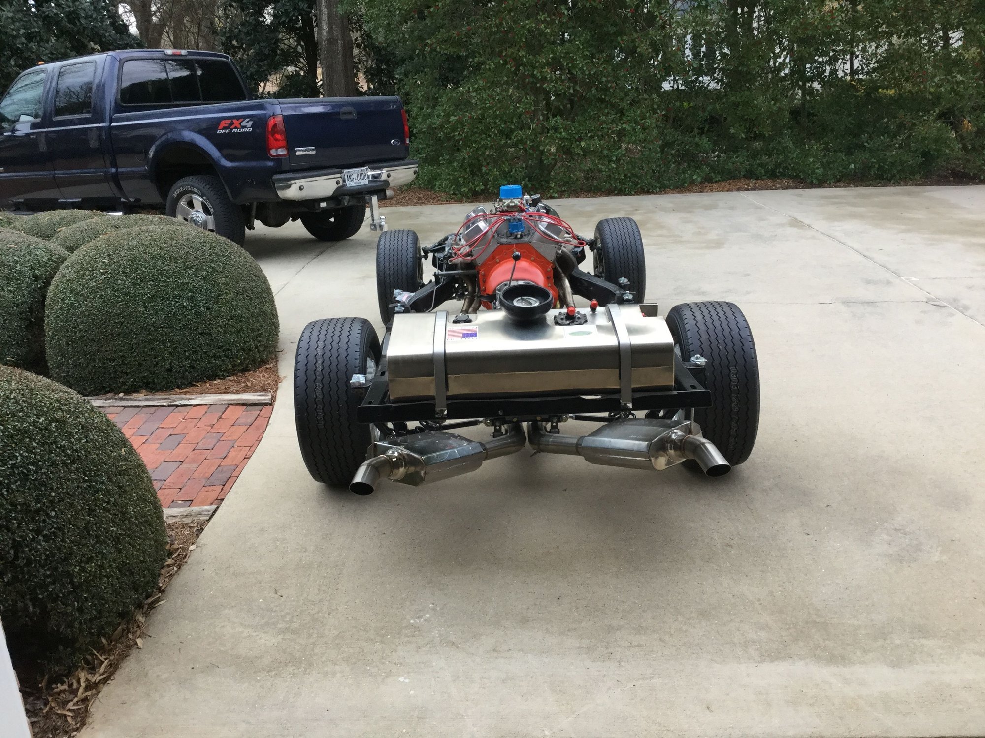

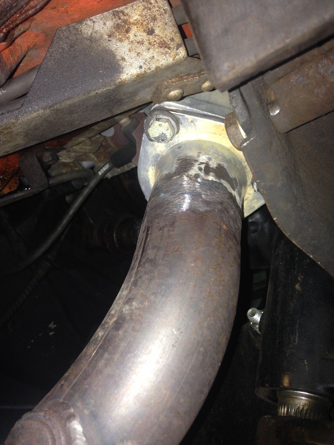

Complete Magnaflow 2-1/2" system with X-pipe attached to 2-1/2" rams-horn manifolds
Magnaflow sound

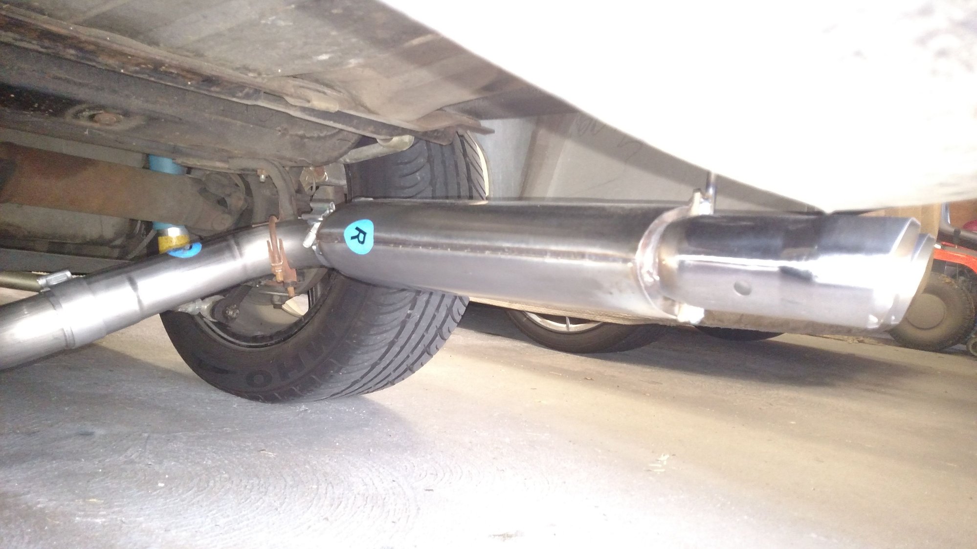

Any straight through perf core muffler will have the lowest restriction but have a deeper tone. Flowmaster is junk aka crapmaster as most like the loudness which I dislike and I’ve tried lots of mufflers on many different cars not to mention the flow like dog ****. I have run borla, flowmaster, thrush chambered, flowtech afterburner, Jones max flow, vibrant street SS, dynomax ultraflow SS, hooker aero chamber, walker, carven, different resonator style SS mufflers etc.
Best sound is straight through perf core and best sound and quality per dollar is Jones max flow SS. Same as most brands SS but it’s 409 not 304 but it’s $40/muffler and what I run on my C3. Straight through perf core has one of the lowest DB at idle and it’s a deep tone that doesn’t hurt your ears like a chambered muffler.
here is a video of my C3 with dual 3” with xpipe and 3” Jones max flows.

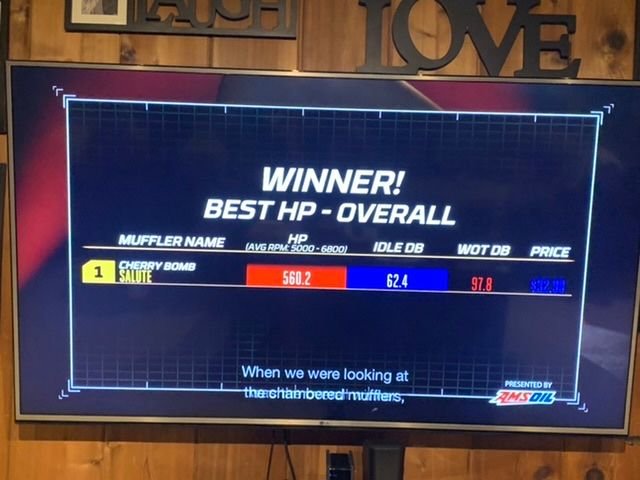

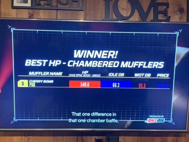

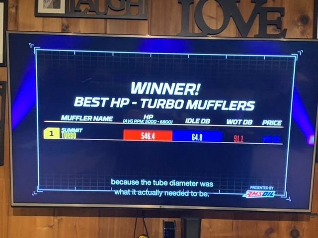

here was a comparison of 3 different styles and they had multiple brands for each style. Shows max HP, idle DB and WOT DB. The highest HP was a straight through perf core.
