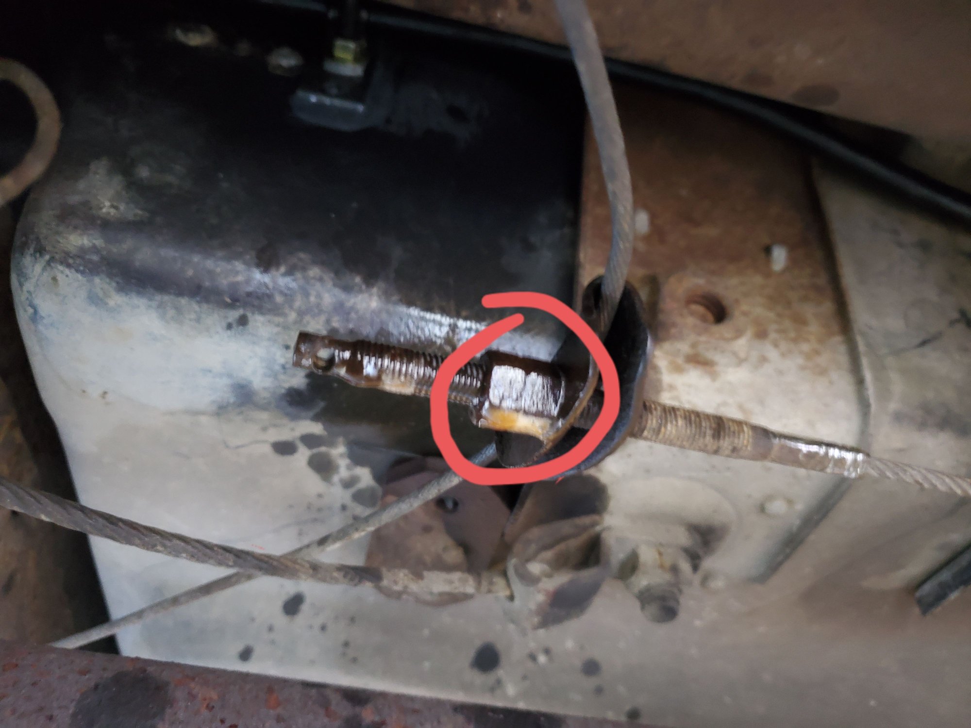

I pulled the spring off, but these two nuts are not backing off the cable, the cable spins when I turn the nuts. I can't get anything to hold on to the cable tight enough to hold it.

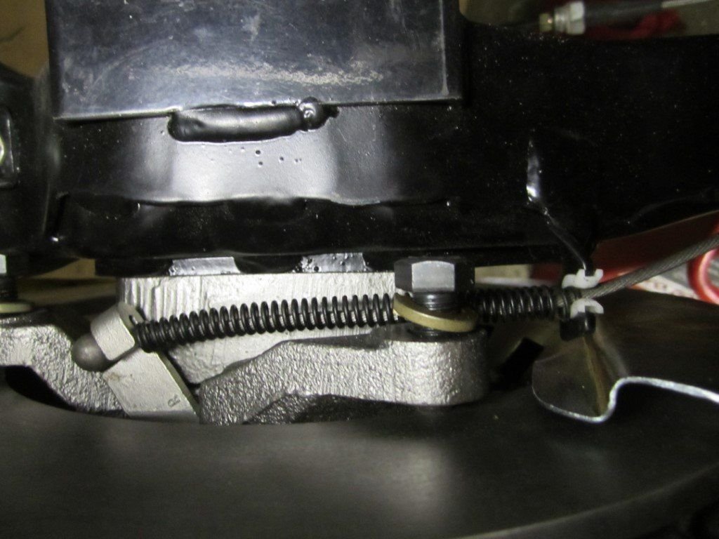

From: mount holly NC
Default Does this help?
You need 2 wrenches, one to hold the front facing nut and the other wrench to loosen the rear nut.

Big vice grips on the stud just where the cable connects. A wrench on the rearmost nut. If you can get everything to bite it'll break loose. Aircraft control cables get little stuck sometimes and that's how we break them loose.

I tried that too...but even as I try to loosen the rear-most nut, the cable turns....so that nut is "stuck" to the threads of the cable. they probably both are for that matter!
