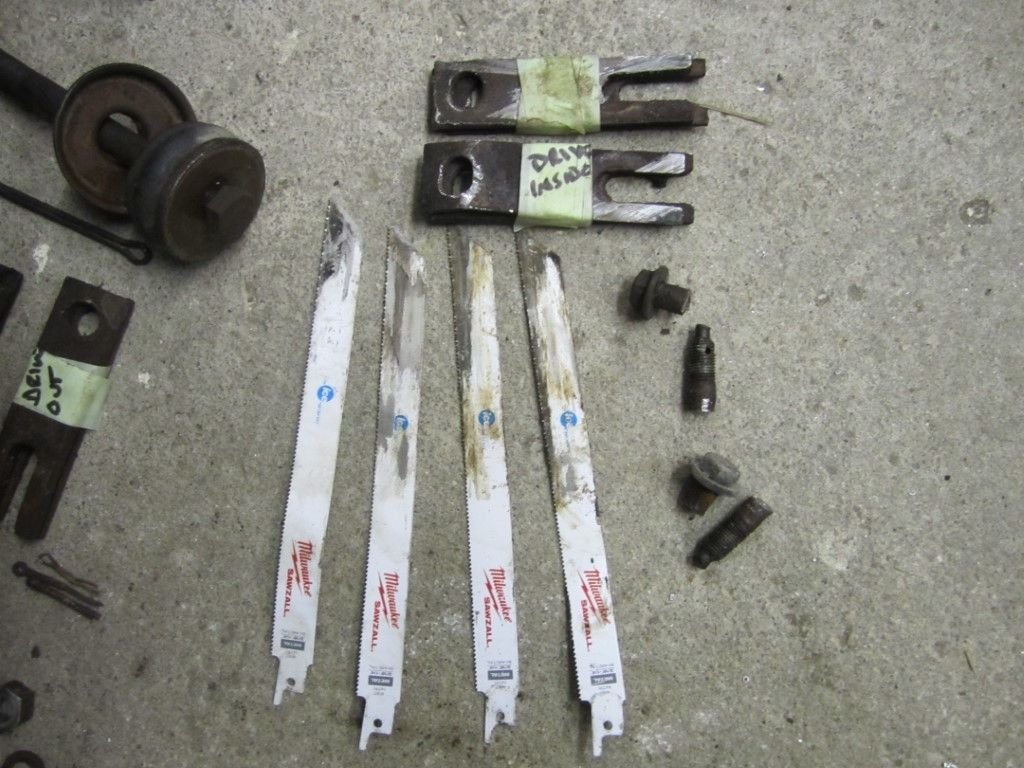

After spending a couple hours cutting one bolt, I found these Bosch Sawzall blades that made the next cut two to three minutes. Bosch RM618 bi-metal from Amazon.
After cutting 1 1/2 bolts the blade was still like new.

The secret is keeping the blade cool. Oil and not just bearing down at full speed.

Definately oil/cutting/threading fluid AND run the sawsall at 1/4 speed rather than full speed to make the blade last.

I burned through several bi-metal blades trying to get half-way through one of those bolts. Plenty of oil was used. It didn't help that the shims were in place, and I had to cut through the bushing before I even got to the bolt (not to mention the rusted sleeve).
I bought a single Diablo carbide blade, and blasted through 3 1/2 more cuts. That blade is still in service, with no paint left on it, and the teeth are still sharp.
I don't waste time with bi-metal blades anymore.

I went through at least 4 blades and what felt like hours removing my trailing arms. Pretty sure everything was original and the shims had rusted/welded to the bolt as well. It was a nightmare and at one point I was wondering if it would ever end.

Blades are cheaper than time. Change them once they start to get dull.
Only good thing about it was I could cut the front half off and still had the back 1/3 ~ 1/2 of the blade that was virtually new
