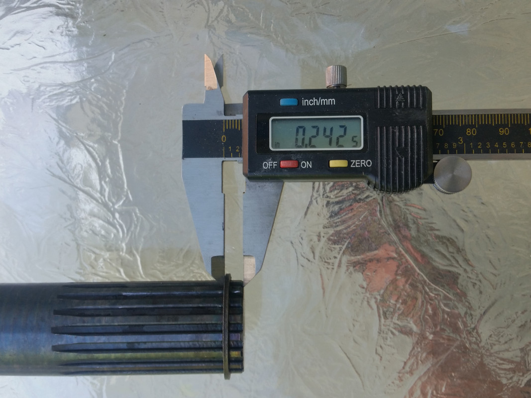

I bought another rear end to put my extra 3.55 US gears in. I can't find the source of the best hardened steel yokes on the market. Any sources?
This is the 3.55 rear end. Probably half the ring bolts were very loose and backing out. It was a junk car sitting in a bone yard for many years.
What's the min width?

I think the best 17 spline axles are International Axles. not sure if he is still making them though. It's been a couple of years since I got a set.
The common rebuilt axles sold by many places come from one source with inconsistent quality. I think most new axles are imported and the ones I have seen were also all over the place. If you go with rebuilt and get a good set they work fine but you have to check them, they should slide into the spiders without hammering, the snap rings should not be expanded in the grooves because the tip isn't machined correctly, the shields shouldn't fall off, tapped holes should have clean threads, and the face dimension you pictured will be all over. Some of them close to GM axles others off 030"
You need to check from the face to the ring, you're behind it. In your picture the dimension is probably 177" not even close to what GM axles were. There is no chamfer left so that axle is soft. Now depending on how you build the posi they might still work and you can have them hardened and reuse them without a splice in the end.
The diff was rebuilt or worked on before, you can see the witness stamps. Also that is not an Eaton posi it looks like a cone posi and they are not rebuildable or as good.
You push your car pretty hard so I would not be using that diff in that condition. You can look for a good used Eaton but stay away from 65-68's, 69-71 are ok but the 72-79 and NOS service cases are the best for most applications. New loaded Eatons are ok, I will be getting one in next week and post pictures on the quality if you like. Then there are the $4200 bare cases Mark Williams has.

George I got around 0.198" on the axle tips on three sets I had, and that was with no c-clip, just from the groove to the top. Those were 69-72 axles.
Another set was worn all the way down to the circlip groove, that was a mid 70s one, like a 77.
