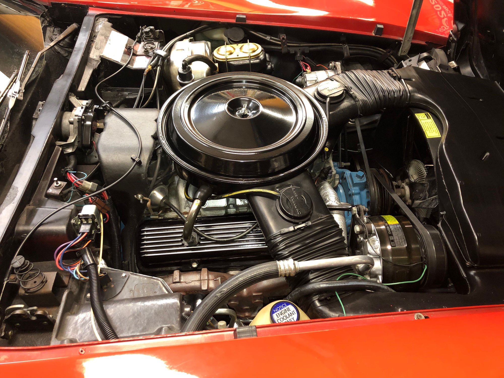

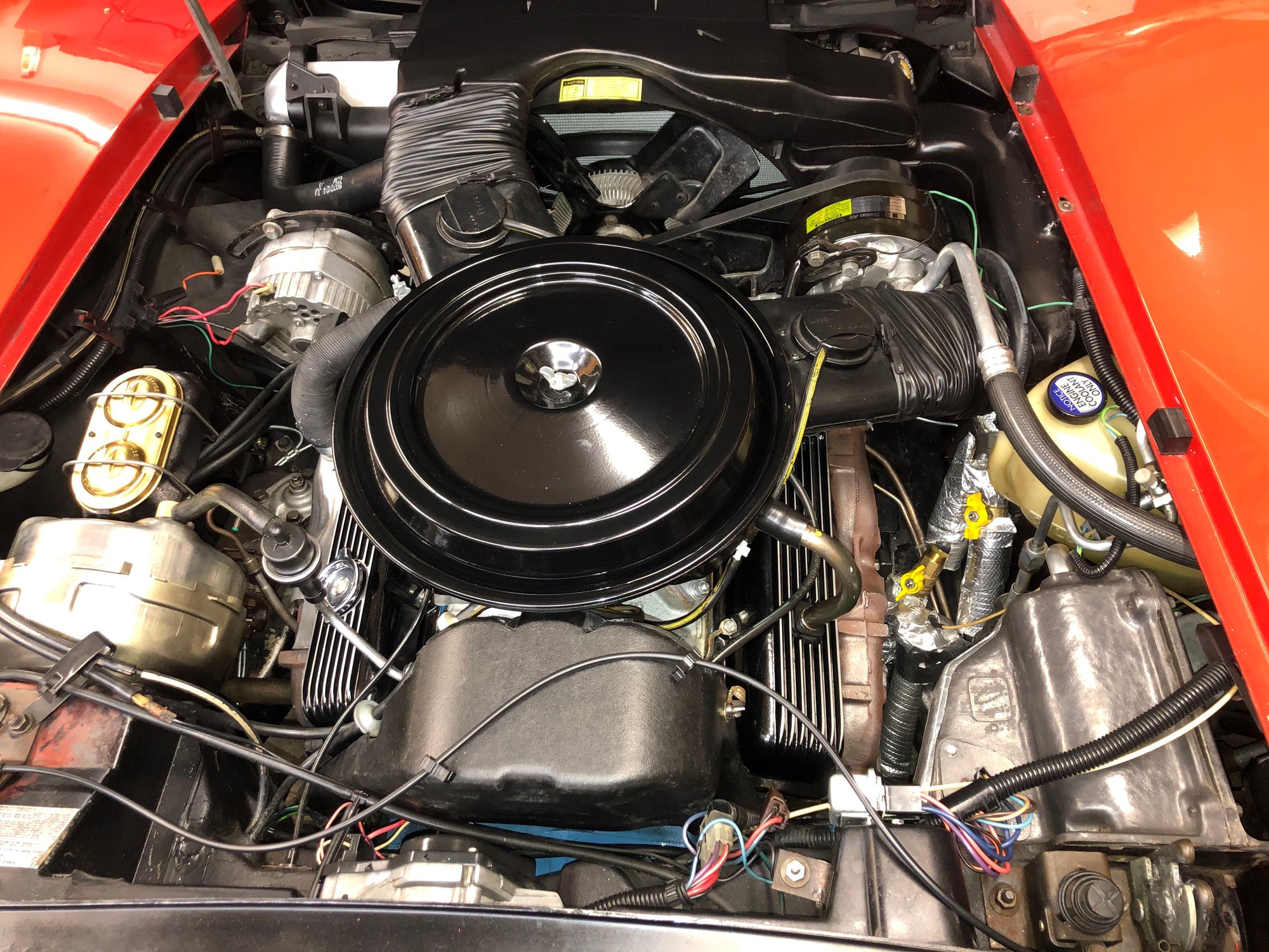

Hello again!

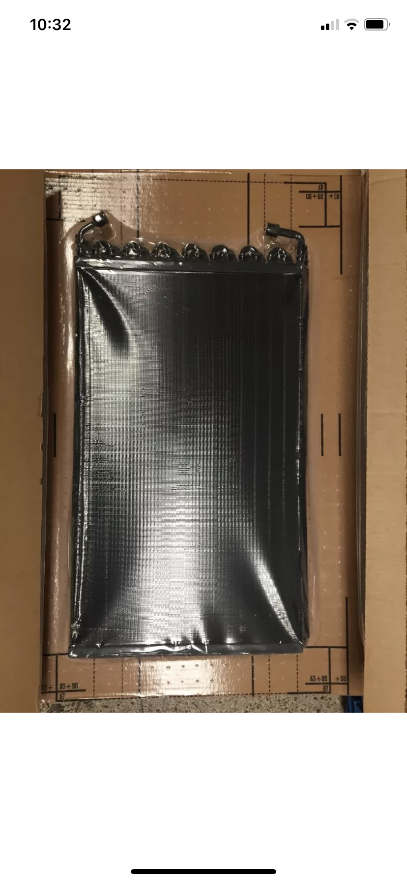

I have a 1973 coupe mostly original and a small leak in my AC condenser. I finally found a NOS made in US one. This thing is way hidden. Do you guys know if I have to remove the hood? Seems like it.
thanks!

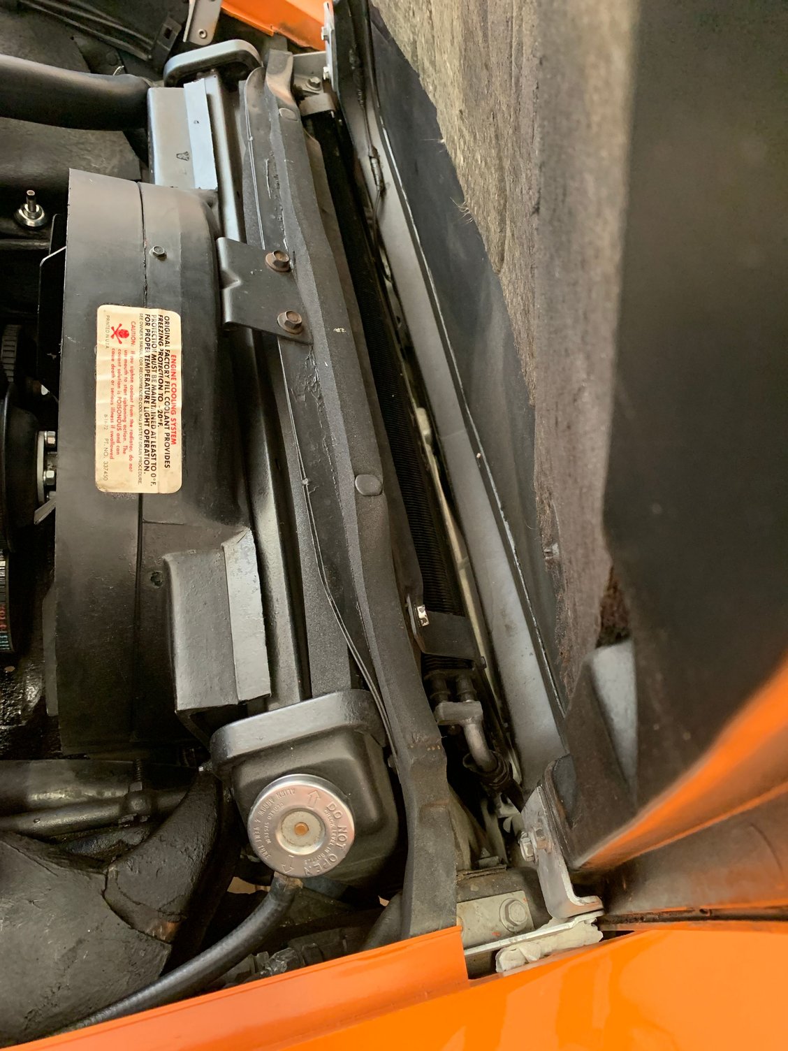

Yes condenser sorry for the wrong section. It is right next to radiator and was wondering if I have to remove something to get at it…I am new to repairs and relying on YouTube but cannot find one. Thanks

I took the hood off to replace the hoses going to the condenser. Removing the hood should take less than 5min.. Get a stick to hold up the hood when you remove the hood prop and courtesy light. Remember the exact position of the stick, this will duplicate the exact angle to remount the hood. Scribe a fine line around both hinges to index those. Best to have a buddy hold one side of the hood while undoing the hinge bolts. Some guys do it alone with a jig hanging from the ceiling.

Are you running R-12? If not, you should consider investing in a modern style condenser - you'll get better AC performance.

That is something I should know but it’s all been updated to the new stuff about two years ago. I think R34 but not sure. I try to keep the car as original as possible but if I had not purchased the parts it’s probably a good idea to just update it because I feel leaks in the old system will just continue to happen. The compressor has been replaced with a rebuilt one, replacing the hoses and condenser. Not sure what else I should replace while at it?
