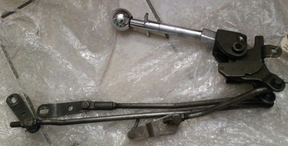

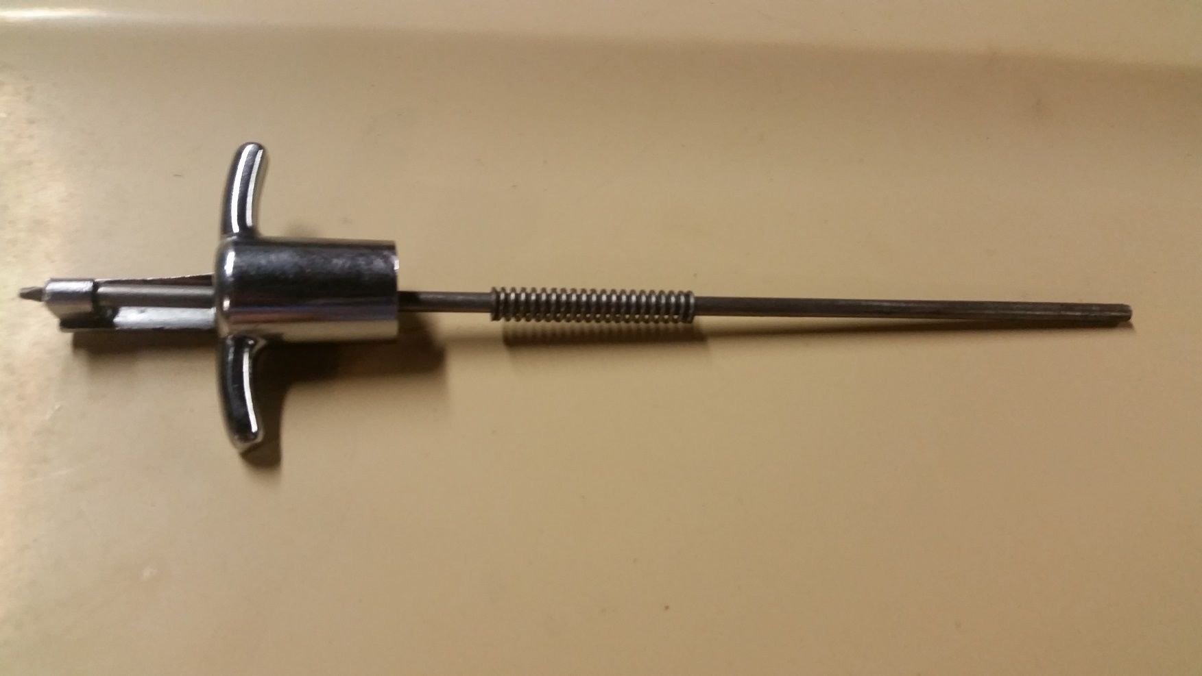

This is kinda weird. Shifter Ball's T-Interlock worked great before I had to take it apart in order to fit a hole adapter plate/new lower 4-speed boot to my Auto-to-4 speed conversion project. Now it won't go back together properly.
Bought this as a " Original GM Corvette 4-Speed Transmission Shifter Linkage Rods-Levers 1969-E1974" for my '73.
Here is the Interlock T-handle, Rod, & Spring that came out.
Here's the Spring next to it's upper seat.
Here is the Lever where it came out of.
When I insert the Rod w/Spring back into the Lever, the Spring merrily drops down the Rod to the bottom of the Lever. The Lever is missing a lower Spring seat somewhere along the Lever's cutout.
When I removed the Rod assembly, the Spring was sitting at the bottom of the cutout, with the Spring's top at a small tilt outward. Why it didn't fall down into the Lever is a mystery to me.

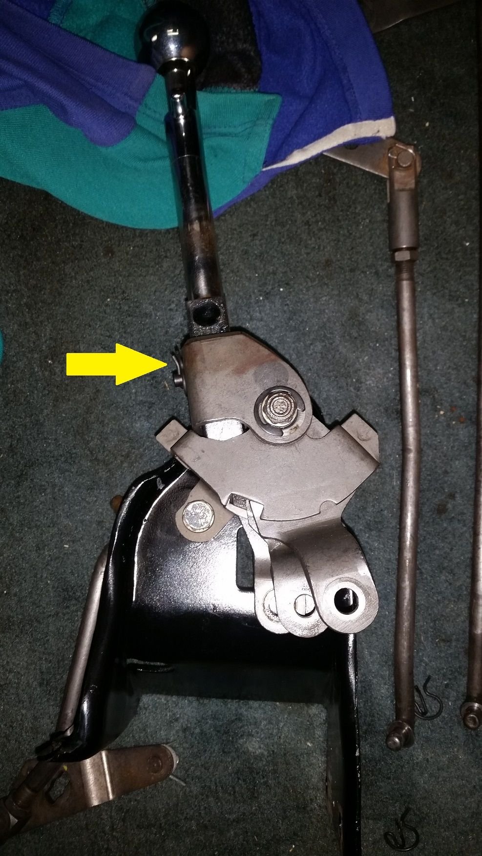

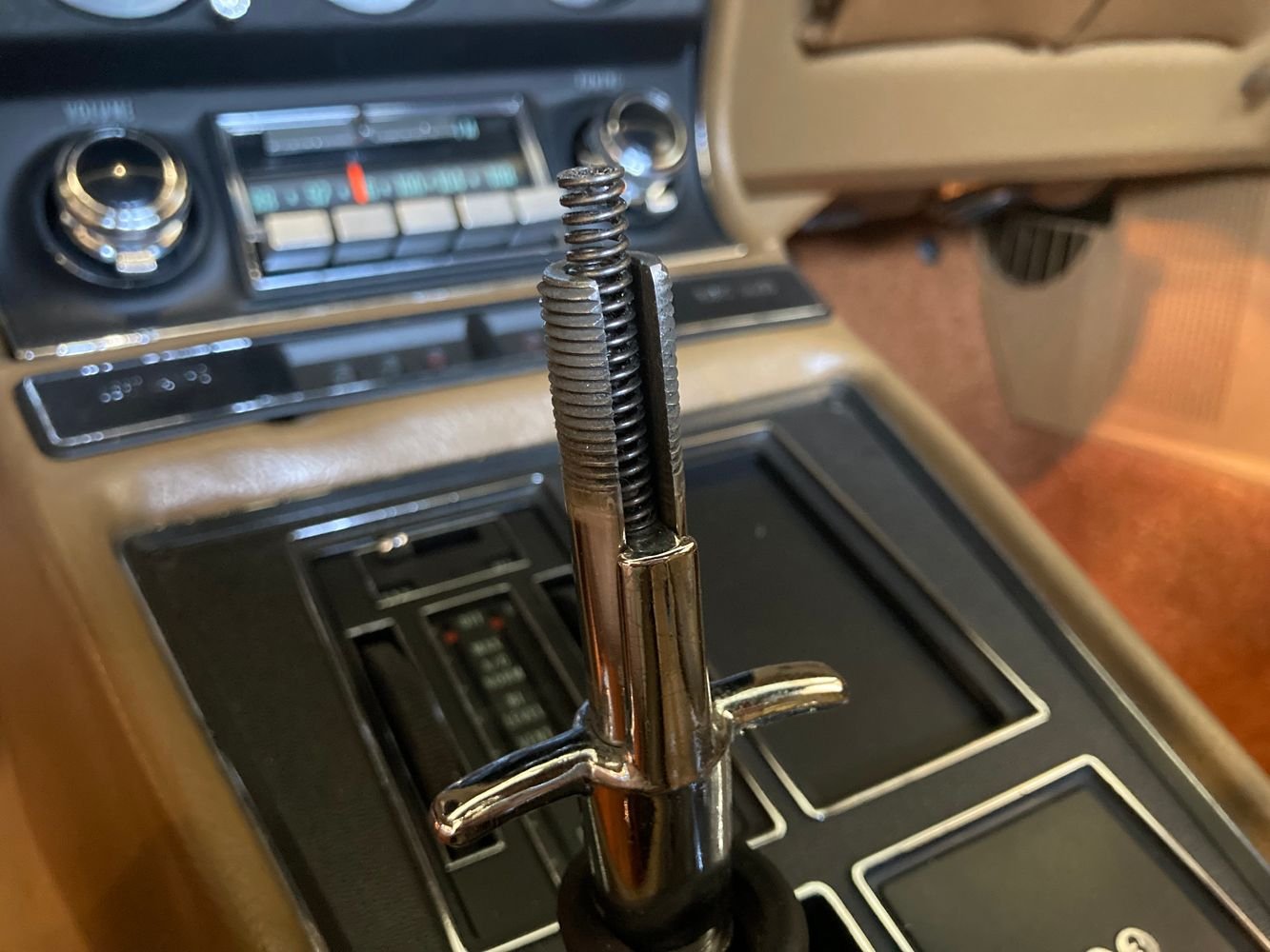

I know this problem as I have done it several times over the years. The handle goes in first and then the spring goes on top of the handle and then the shifter ball is screwed on. If you put the spring in first it will fall to the bottom of the shifter and then it is a pain to get it back out.
See photo.

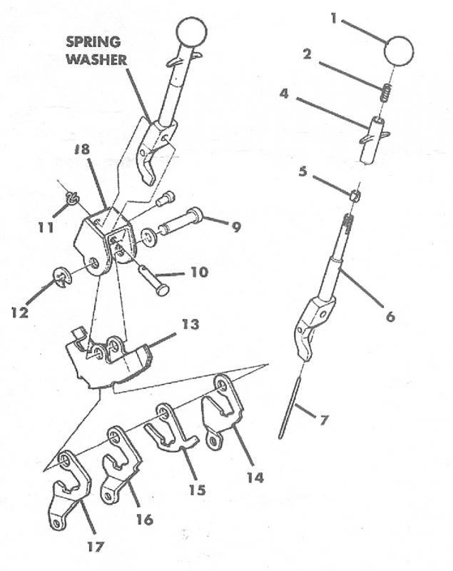

I kinda wondered about those bushings too, and Willcox does carry them. Also wondered about that extention on the bottom of the Rod.
On this parts breakdown, it shows a normal Rod end like mine, and the Spring up against the **** also.
Different years, different construction I guess.
See photo.
Makes all the sense in the world. THANKS MUCH!

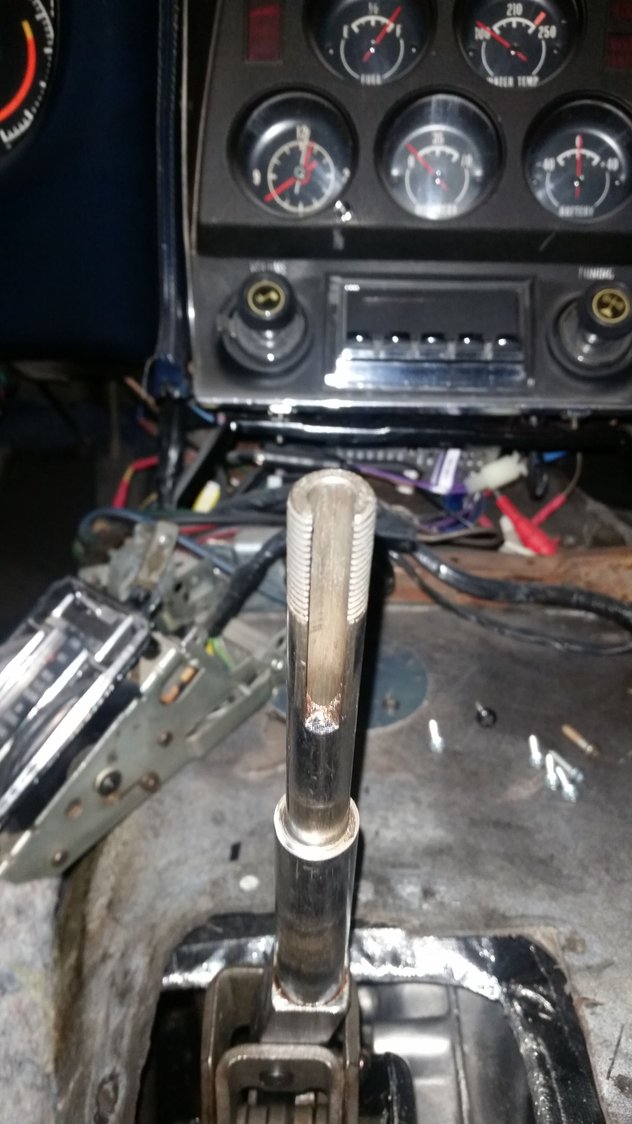

Now I have another problem;
Something at the bottom of the Lever is keeping the Rod/T-Handle from going farther down. No way will that long Spring compress enough to allow the Ball/**** to thread onto the Lever.
Would removing this Pin and removing the Bolt give me access down there (remove the Lever) to see what the hell is blocking the Rod from going down deeper?

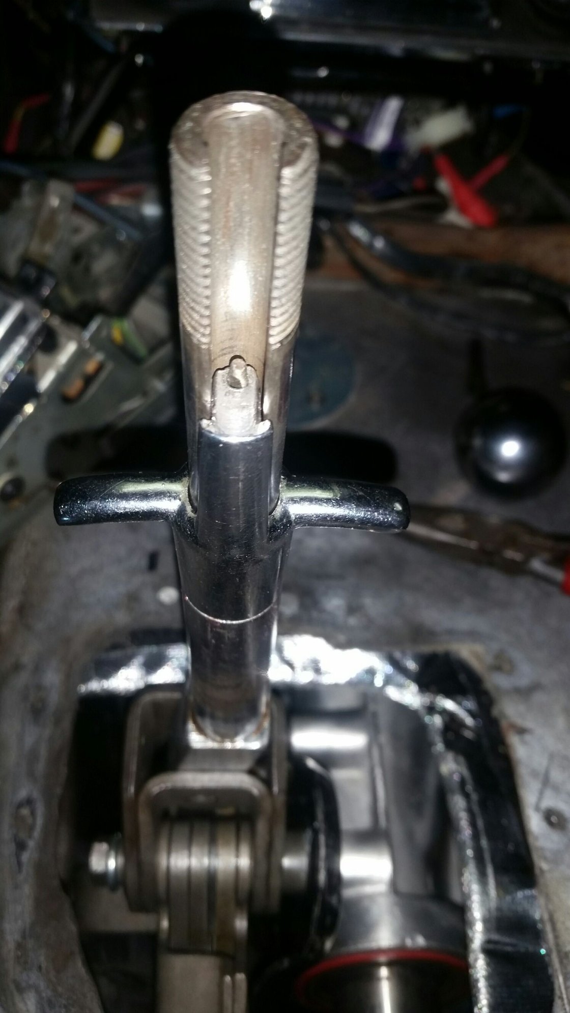

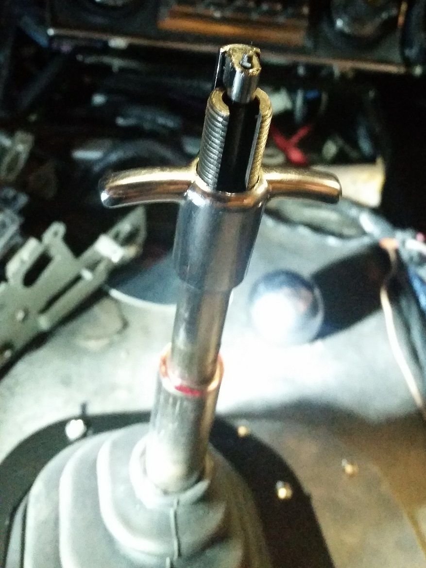

This is pretty embarrassing.
I asked Why wont the Spring Fit?
Because I inserted the T-Fitting/Rod 180 degrees OFF!
