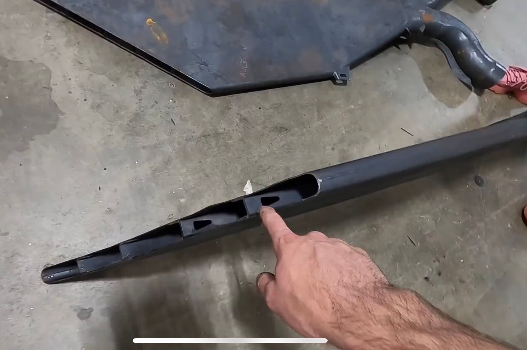

Originally Posted by Chassis74
Would be interesting to try a boom tube side exit exhaust like these instead of side pipes
I went down that road too. It didn’t gain much clearance over the oval tube that I did and was a very tortured path to get it up close to the body. Boyd /Dr Gas was hit and miss on contact at that time. I talked to SpinTech about making something custom but they didn’t seem very interested at any price. They said they were supplying the spin traps for Dr Gas and didn’t want to step on toes. Still like the idea but happy with how mine turned out. Big gains over the hooker side pipes, better throttle response and a much better sound.
