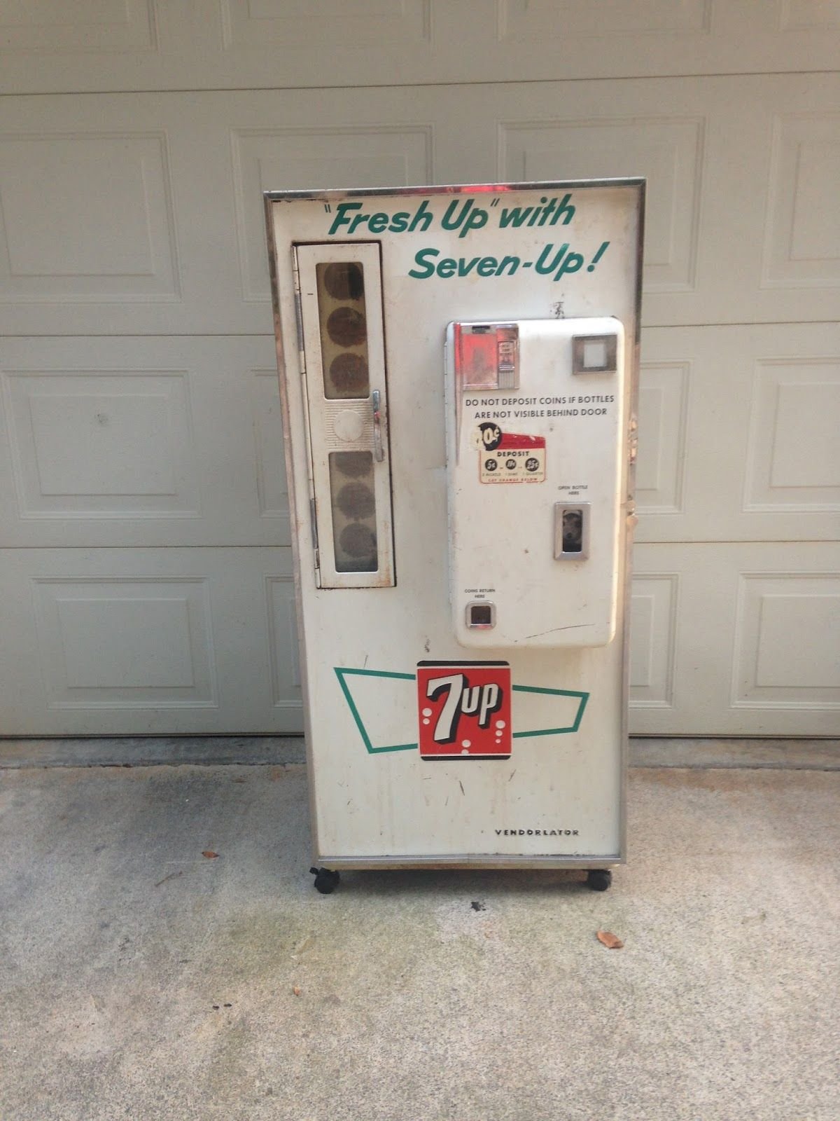

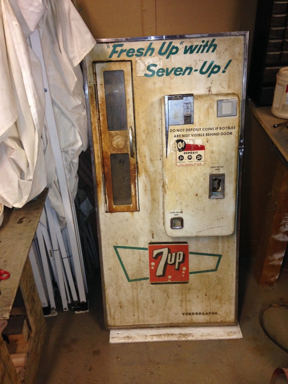

I have used PREP&ETCH after checking out the msds specs....I was looking for something I could use on painted surfaces like old vending machines. Works pretty well.....
Before....
After.....
Brian

I bet the farm that contains oxallic acid it’s the only thing that won’t harm the stickers ..
Old Oct 10, 2021 | 09:56 AM
Wee's Avatar
Wee
Joined: Apr 2010
Posts: 1,857
Likes: 332
From: Cartersville GA
I think the only sticker is the one on the coin door.....But the lettering is very thin paint. I don't remember what's in it or what I was really looking for, it's been a few years.
