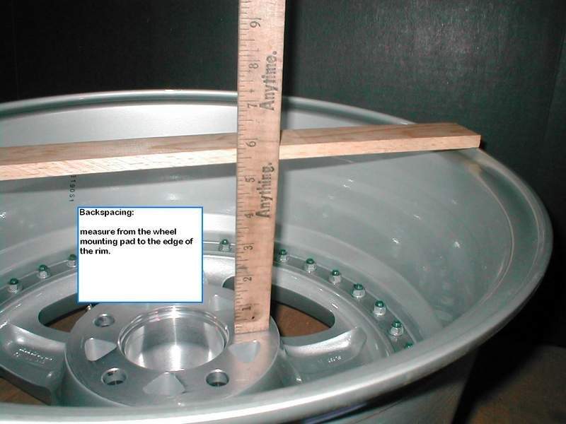

Originally Posted by pspicci
the stock backspacing for the C3 wheels is 4"
I agree ! That's how I measured and here is a pic of one of my "new" rally wheels for my 69 Vette.(8x15, 4" backspace with 275/60R15)
But then you come across this chart...
https://image.mamotorworksmedia.com/production/website/articlefiles/TechTipFiles/C3_Tire_Reference_Guide.pdf
I measured my wheels the same way and came up with 4". What gets me is Eklers, Zip, and Mid America all only sell 4.25 backspace rallys and Eklers says to use a 1/4" spacer.
Oh well, Summit came through. Never thought buying a rally wheel would be so complicated.
Also, if you read the description of backspacing in A10's first pic, it says measure from the inboard flange, not the outer lip but their pic shows from the outer lip. Ahhhhhhhhh!
Cheers.

Originally Posted by F4Gary
I
Cheers.
I know it's frustrating when you need to get it right and you're shelling out good money. You would think there would be consistent info on something so basic.
This is not "pilot proof". Good Luck !
