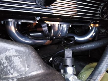

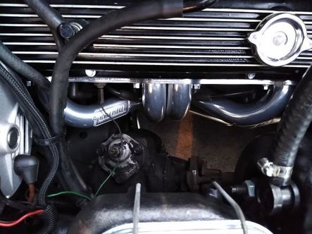

The headers came in and I had a local shop put them in. As I suspected they are NOT a stock replacement. The angles work out and they do fit, but required a short list of modifications:
  • Re-route heater hoses for clearance
  • Cut and shorten the engine pipes, including moving the O2 sensor.
  • The tubes are bigger so the brand new heat shields that I installed last year had to come off.
  • "Header" spark plugs that are slightly shorter.

Thanks. They look awesome. Well worth the two extra bills for the coating.
Driver's side:
Passenger side:
