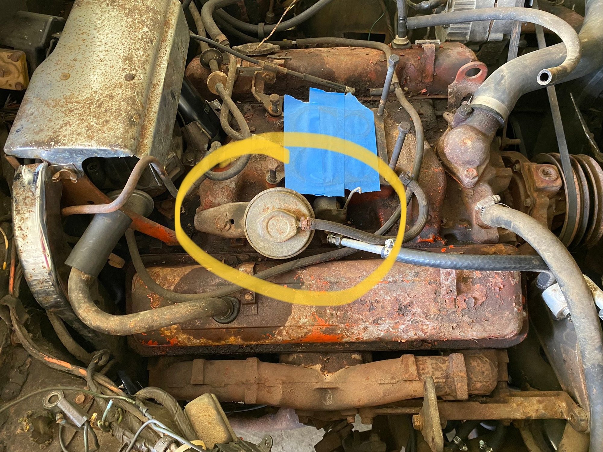

Forgive me, I’m new to working on cars. What is this?

E.G.R. valve [exhaust gas recirculation] part of the emissions control system.

You do not need that EGR, they never work half the time and yours being rusted the bladder is probably frozen!

I pulled it off and the PO had put a screw in the vacuum line so it hasn't been functioning anyways. I did try to manipulate the bladder and the rubber surrounds on the diaphragm is definitely deteriorated. I'm just going to pull it off and put a cover plate on it.

You can buy a block off or even an older manifold that looks identical but has no EGR provision or you can go to a 2101 Edelbrock Performer.
