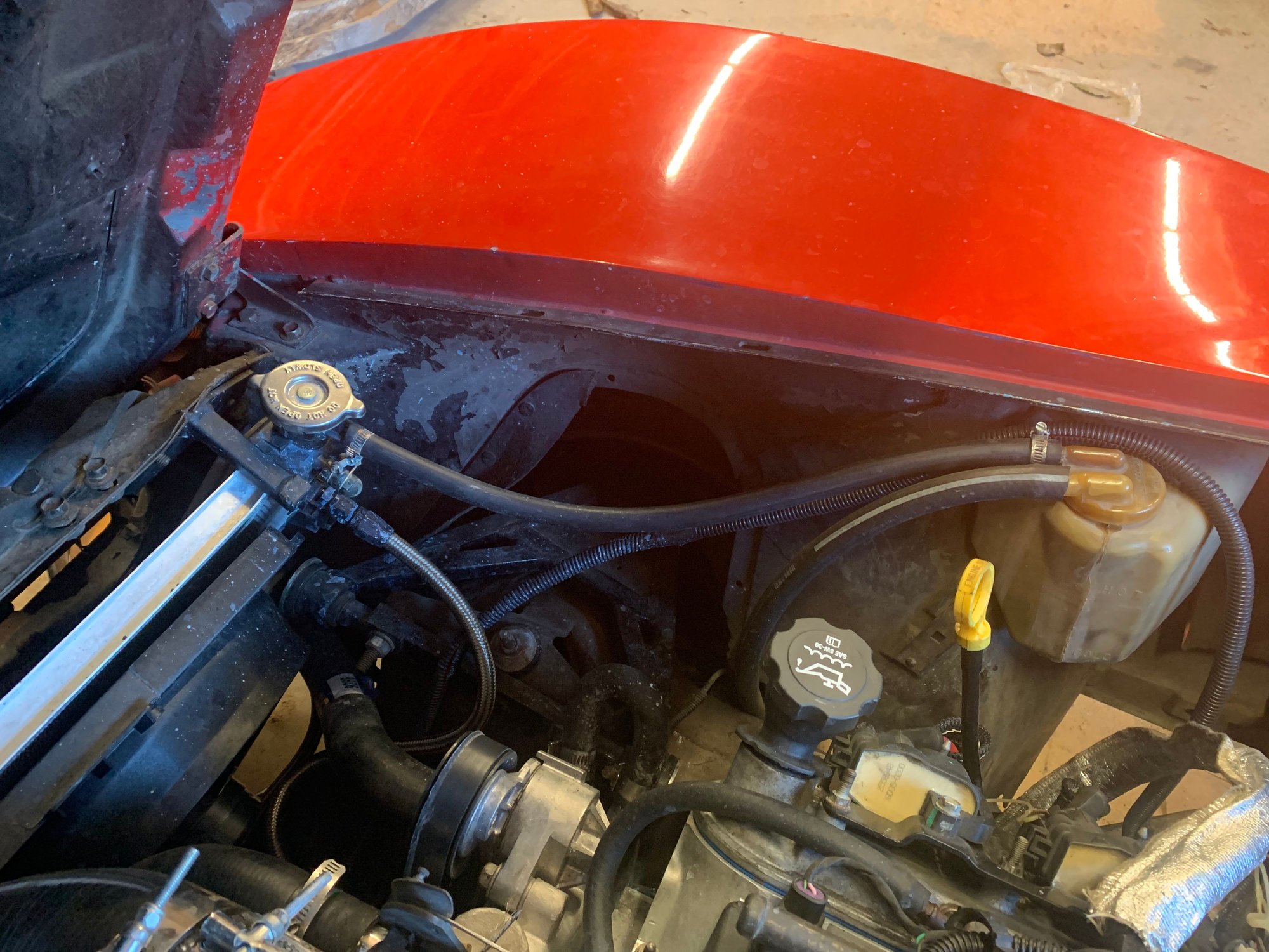

good afternoon all, I am running the 98-02 f-body radiator and fans in my LS6 conversion and it seems to cool OK, it might get up to 210 or 215 on occasion but going down the highway it settles back down to 195 to 200. I am wondering if I am running the correct radiator cap because it does not seem to burp out the air after a fill and does not draw anything from the overflow tank. I am running a Stant cap that is supposed to be compatible with the radiator but should I try a stock GM one, would that make a difference? Is there anything else I should check out?

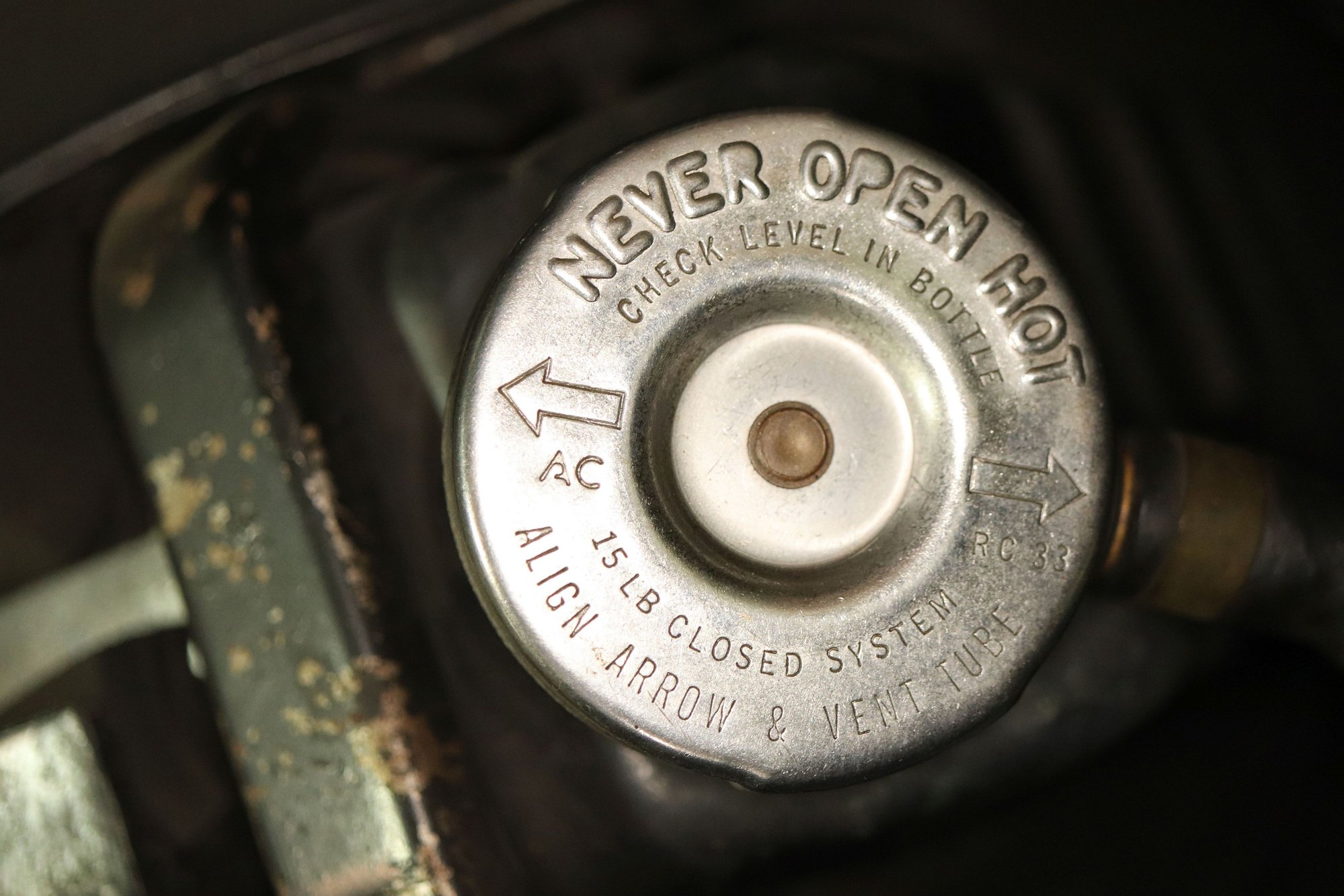

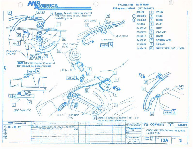

Please check to make sure that the radiator overflow tank suction hose is attached to the tank cap. This hose is located inside of the overflow tank and needs to be submerged under coolant for the system to work properly. Typically the line falls off of the cap nipple and lays in the bottom of the tank, or it is removed by a PO. Without the line in place, the radiator cannot draw coolant back into the radiator when the car cools down. It is Item #7 on the AIM sheet below.
Also, the OEM cap is a 15 psi cap. Check your Stant cap to see if it is the same. Below is a pic of the original cap from my '75.Let

Thanks fellow '73 and '75 owner! The hose from the radiator to the tank is new, as are the clamps, but I did not check the hose that is in the tank so I will check that as well. Since the radiator is from a 98-02 f-body I am using the cap that is compatible with it.

I confirmed the hose to the tank and the hose in the tanks are both secure, there is a hose clamp on the hose that attaches under the tank lid. I unhooked the hose from the radiator and gave it a good suck and got no air, just distilled water, so it is not plugged and there does not seem to be a leak that would let in air.
