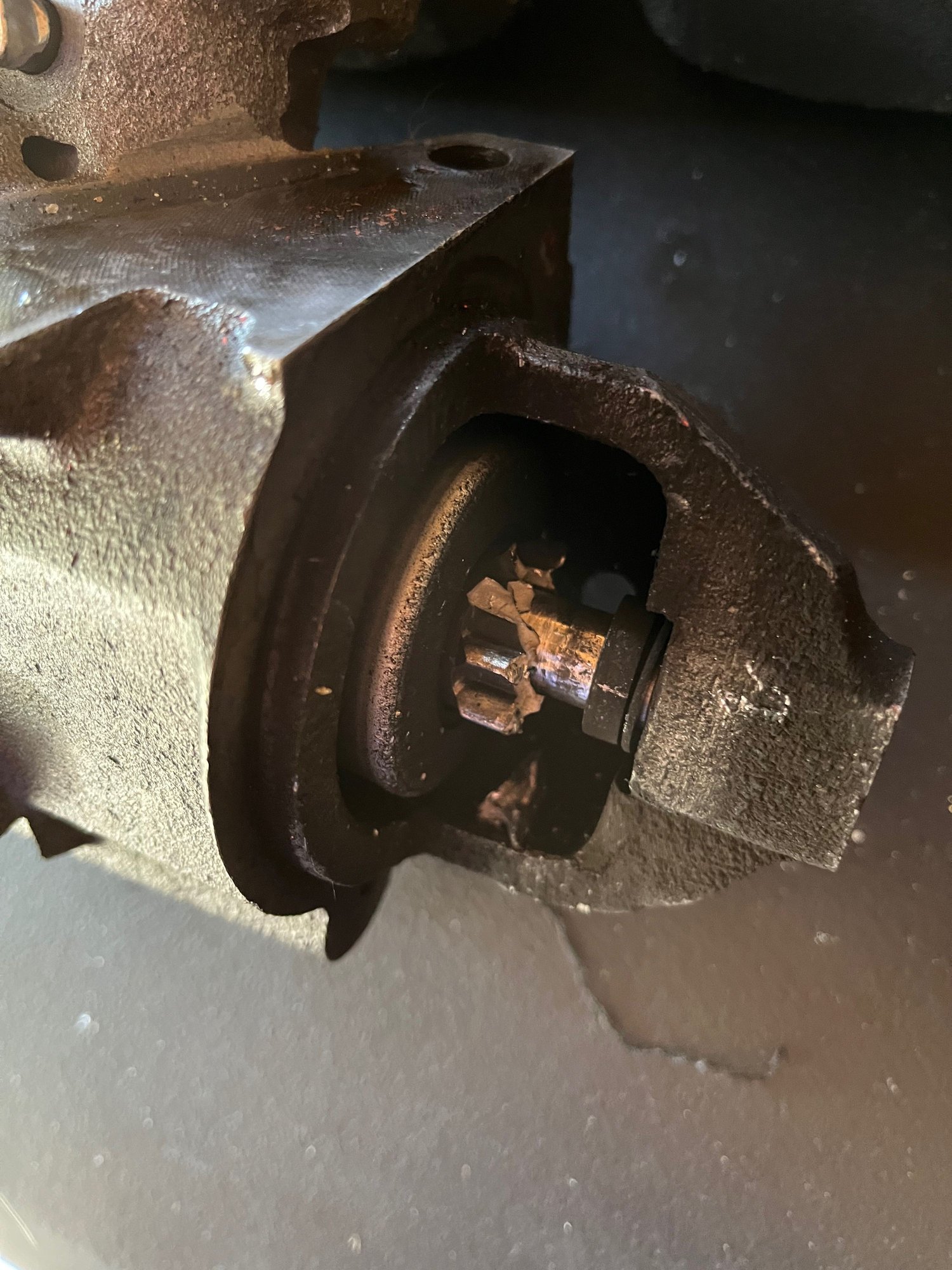

I just pulled the starter on my 73. Other than changing the oil, was the first time I've ever done work on a car. I jacked it up onto some 10" race ramps cribs and it went pretty smoothly. If I can do it, anyone can. Now, just have to figure out how to swap the bendix as the gear was chewed up - guessing due to bad solenoid as it is stuck in the engaged position. Trying to decide myself whether to swap the parts or go new starter.

seems yours has the staggered pattern and thus the larger 168T flywheel/flexplate. If so, the starter I linked in my P#12 will work for yours as well. It has the "R" terminal to go with '73 points ignition. If you've swapped to another type type trigger; simply disregard the "R" terminal. As before, pay attention correct starter bolts.
Remove the "nose" piece after unbolting. Bendix will slide out. Put a dab of grease on the armature shaft.
Those old Delcos are heavy, but are pretty much bullet -proof. Their downfall is the solenoid black cap is subject to years of heat from the exhaust pipe.
If you purchase a new solenoid, demand a brown cap on the solenoid end. Those are more money, ceramic, and heat resistant.

Wrong. The starter needs to be disassembled to remove the drive. There's a captured snap ring and shift fork keeping the drive from sliding out.
