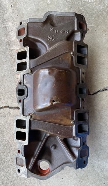

Thanks for all the discussion. Very valid points all around. For my situation, I think I will try and get the manifold to fit. If this was a numbers matching LT1 and I was using the born with heads and the Winters aluminum intake. Yes I would pull the heads and correct the issue. But I'm using some donor 492s that are not born with the car ( I have the matching and dated 993s I pulled off) and yes the original intake and block, but the intake is nothing special, I can probably buy another one for $50-75. I've owned the car for 30 years, if and when I sell I will let the buyer know about the machined intake. So I will try this machining route first. If I need to pull the heads and get them all taken apart and milled, I think I will just go and buy some aluminum trick flows with the camel humps and paint them orange. Too much invested in the 492s.
As an update, I went to my machinist. Like everyone he is surprised I cannot get it to seal. Before milling the intake, he took off the splash shield on the bottom of the intake (he didn't like how the pan encroached near the runner, and asked me to take the gap readings again with the solder, and to bring him the solder strips because he wants to use his equipment to measure the compressions. If he decides to mill it, he says he will also clean up the drivers side and see if .120 gasket will then work the bolt holes. He plans on milling China wall as well. Says its on the tight side.
After laying the intake on the China wall. Rivets not an issue. Still have to recheck gaps.
Rivets near ports on passenger side.

MrVette. Sorry to hear about your ailments. Did the car run well before and for how long? Did you check the block for warpage before reinstalling heads? What thickness head gaskets? If its your intake, I hope my troubles will help you diagnose your problem.
