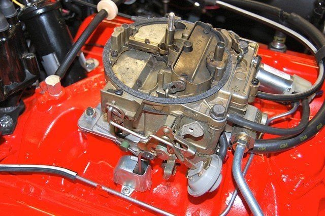

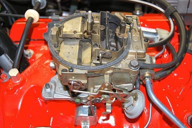

Choke open:
Choke closed:
"Fuel running down its throat"...about 42 years ago my '71 was running rich and I could smell gas. A high school kid around the corner from me stopped by to see what I was doing. I told him that I could see gas pouring down into the carburetor. One glance and he said "your float has sunk". So I went to NAPA and bought a new float, he removed the top of the carburetor, installed the new float, and problem resolved.

Thanks for the pics, so it's choke was open when I looked at it in the afternoon while waiting for the tow truck to arrive, not sure what condition it was in right after I pulled over.
