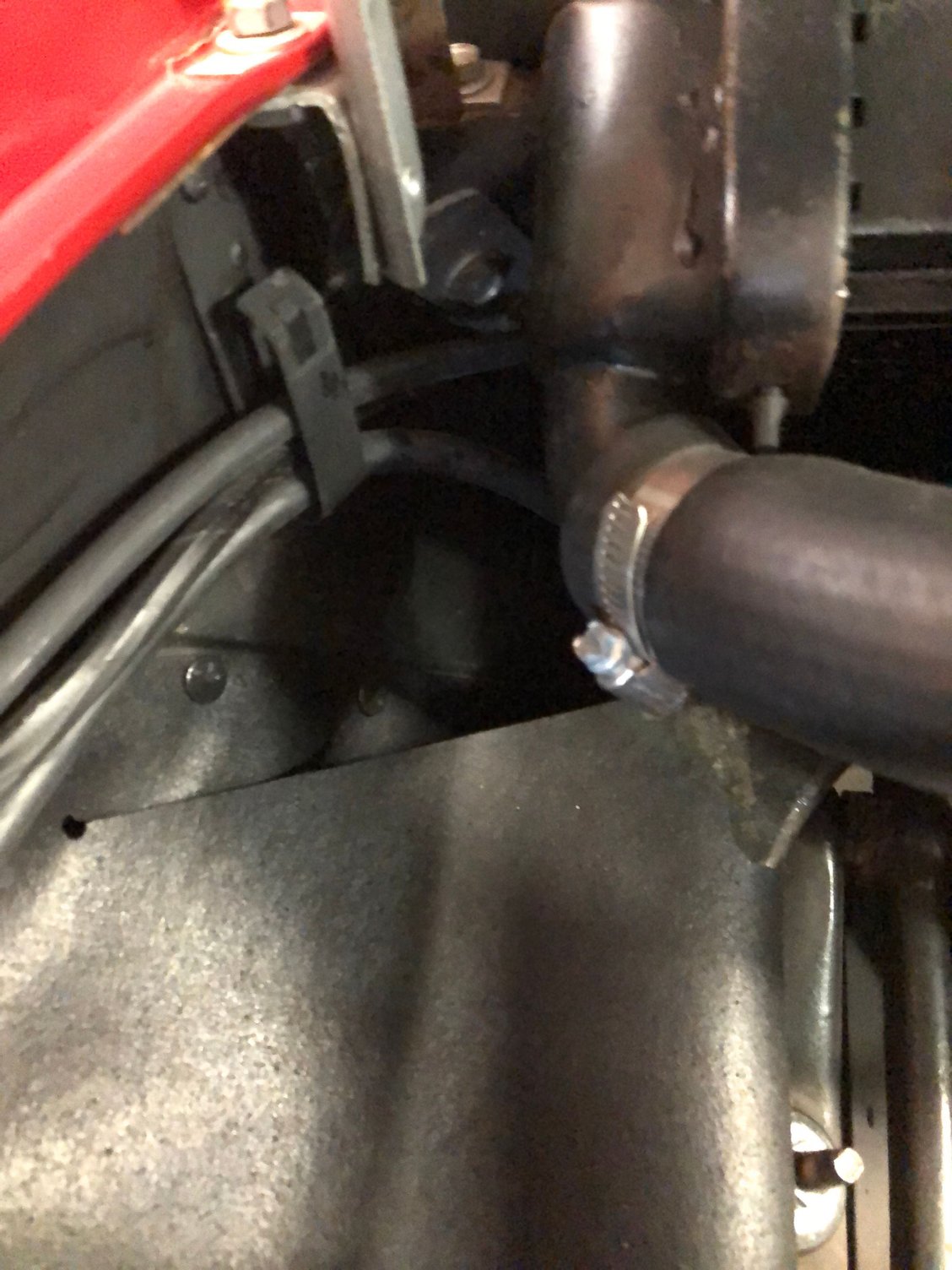

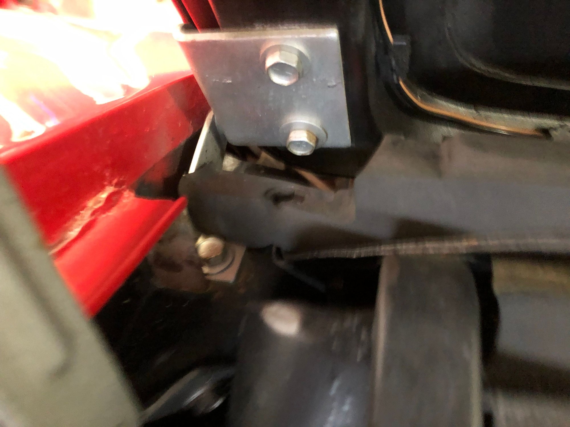

In the words of a fairly famous politician “I Feel Your Pain.” Here are some pictures of the hood bolts, and latches on my stock 73.
I hope this helps, let us know if you need any other photos. Good Luck
The taped “Arm” is what’s needs to be pushed toward the head lights
