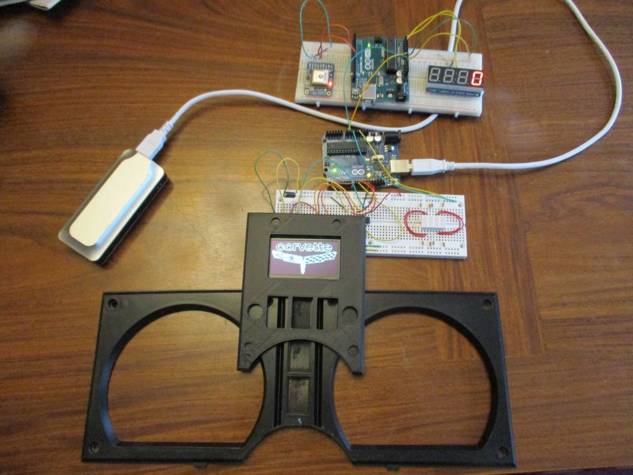

I've used an Arduno Uno for many years to provide temperature measurements. This required a laptop to record data, so not particularly useful for driving around.
After playing with some cardboard box prototypes, I finally finished the engine compartment wiring and added a prototype display to where the radio usually goes. This enables real-time, accurate monitoring of one or multiple temperature sensors, one or more bright visual alert bars, a vacuum sensor, data-logging, and whatever else I want to add. Here's the plastic and electrical tape prototype. I need to 3D print a radio-face sized housing once I figure out which OLED display to use that best matches the stock interior.
Here are the teaser photos.

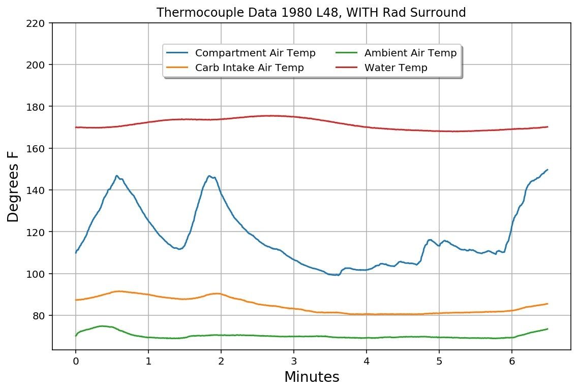

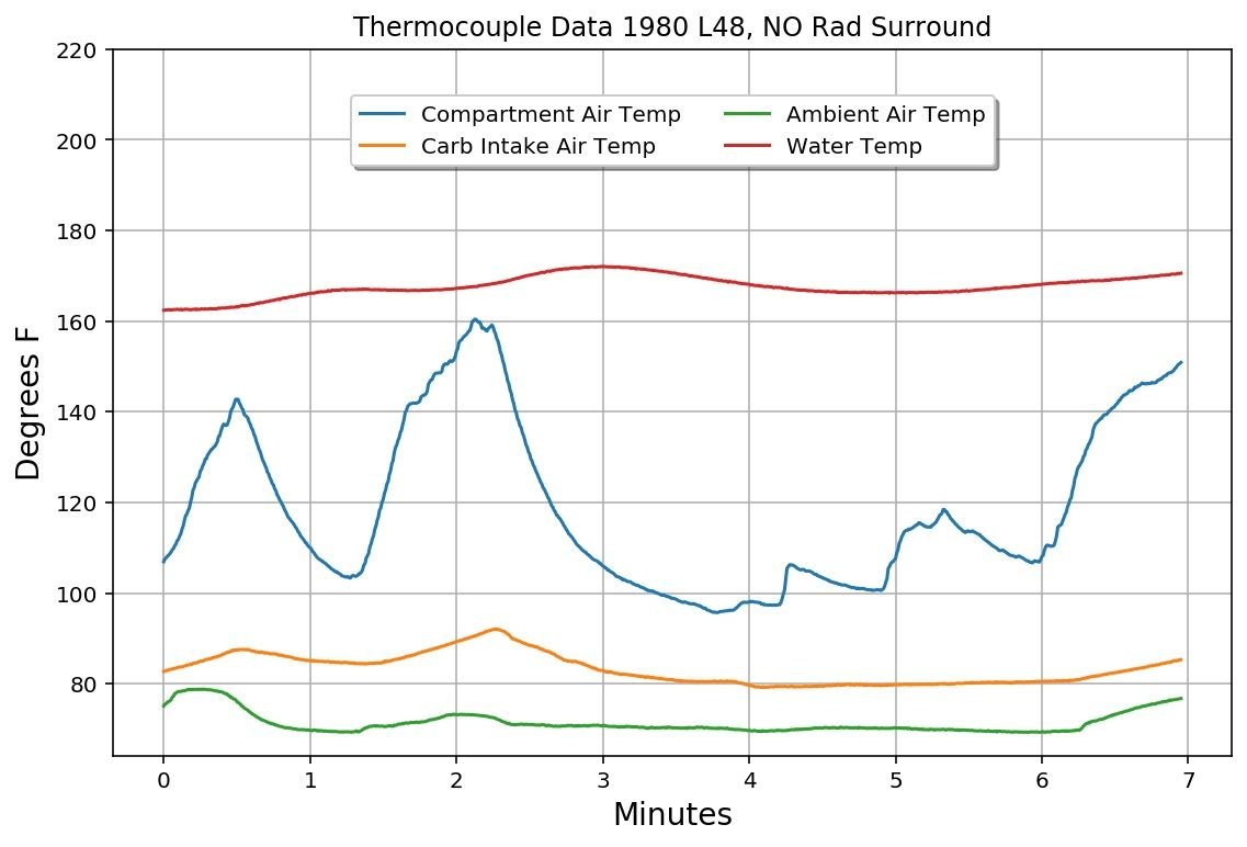

That experiment convinced me that the L82 dual-snorkel CAI is the best solution for a stock-ish L48 engine. I have them in both cars, and I have modified them to remove the bellows and heat stove input, meaning both snorkels get unimpeded cold air all the time.
In my 80, I noticed that there was a large gap at the sides of the radiator, where the air conditioning condensor once was. So I made sure the thermocouple on the upper radiator hose stayed attached this time, and I ran two passes on an identical driving loop within few minutes of each other. The loop featured some city driving, and then a blast down the highway, ending in a slow crawl through town. At no time did the coolant temperature rise above 180 degrees F, and my electric fans never turned on (195 F on, 185 F off, both switched together on separate relays).
Other than the carb intake air temp, the plots show that the air bypassing the radiator didn't really matter for this drive.

So I noticed that it didn't matter what I did. If my car was moving, it was NOT overheating, or even coming close. I have a 180 degree Milodon high-flow thermostat. So I did a longer driving, starting with a warm engine in a nearby town, and going over what passes for a mountain in Virginia. While going uphill, the temp was about 160. Coasting down the backside, the temp dropped to 150 (!).

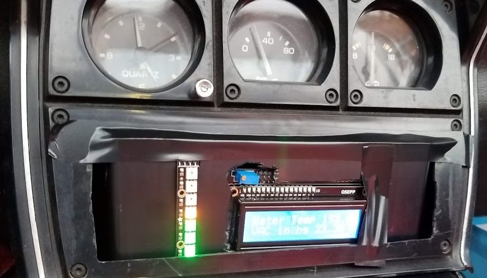

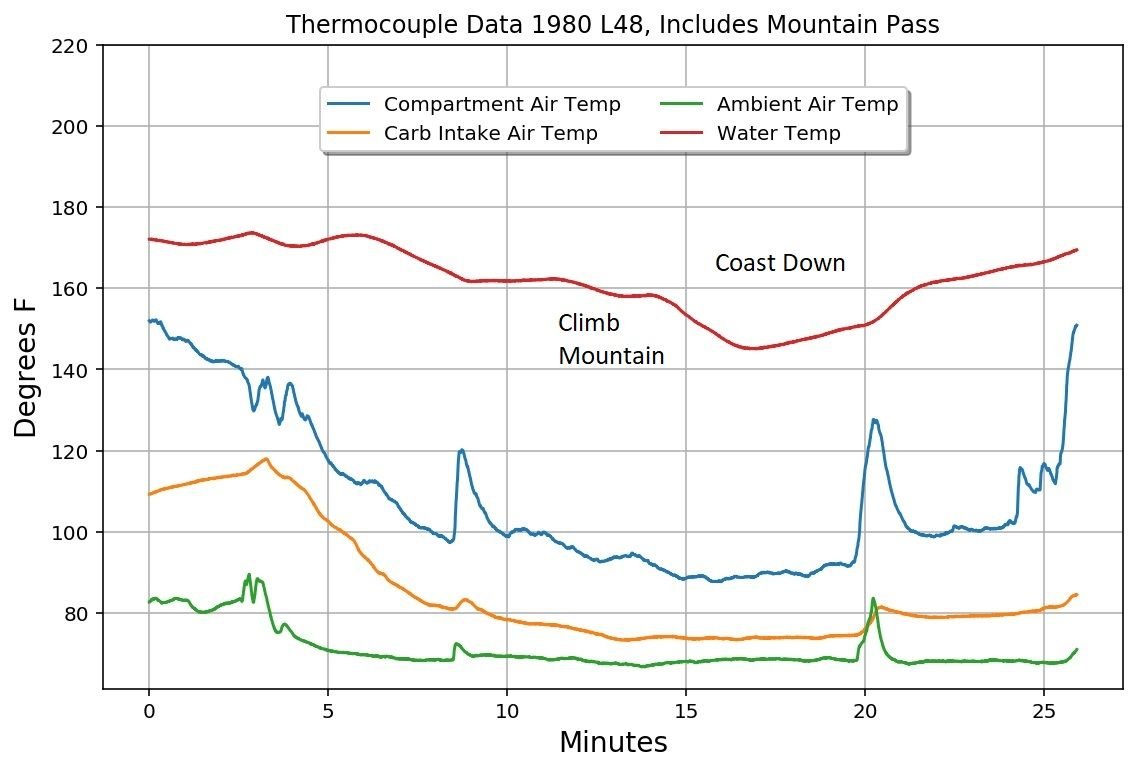

This is early Fall in Virginia, not summer in Florida. But I was still surprised by the temperatures. The upper radiator hose thermocouple was under several layers of electrical tape, but perhaps cold air was still blowing on it. The other air temperature readings were interesting, but didn't tell me anything useful. I can't dynamically adjust the tune of the engine to take advantage of cold intake air. And the data collection process was cumbersome, requiring a laptop to collect data from the Arduino's USB port. It makes it very handy to plot in Spyder, but impossible to use while driving.
The thermocouple shield on the Arduino took over most of the Arduino's functionality. I could add another sensor, perhaps, but not display anything. I needed an actual coolant temperature sensor, and I needed a real-time display. Fortunately, I had these items, I just needed to write a new set of code, and wire everything up.
The teaser images in the first post show the result of all of that. I used a Wells SU109 2-wire ECT to take temperature measurements, and I added a Wells SU105 MAP sensor from a 1982 Corvette. I spliced the appropriate connectors to 18 gauge GXL-rated wire and ran it to an Arduino fitted with an OSEPP LCD 16x2 display shield.
All of the HVAC components are currently removed from the car. While I hope to have heat again someday, I removed the heater core bypass components, plugged the return port in the water pump, and used the ouput port in the intake manifold to hold the ECT. I needed a 3/8" NPT female to 1/2" NPT male adaptor to make the transition. Since the ECT is a two-wire system, there was no problem using pipe tape. The image shows the ECT, the plug in the water pump, and the temperature switch used to trigger the dual-Spal fans (2 wires for two relays).

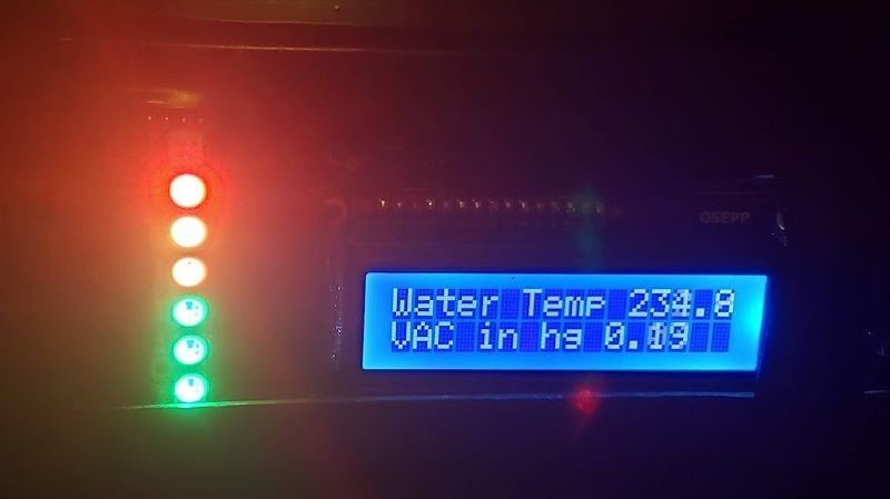

I used a 330 Ω reference resistor, since that is close to what the ECT's resistance is at 180 F.
In this image, I unplugged the ECT, and have about a 125 Ω equivalent resistor plugged into the ECT connector, which the Arduino interprets as 234 F.
It doesn't come across well in this photo, but I am using an Adafruit Neopixel 8 element stick to digitally display temperature. I can pick the color and intensity (and could even change the brightness if the headlights are on or off, or from a brighness sensor on the dash). As the temperatures go above where my fans kick-in, the colors get more red, and much brighter. At full-brightness, an over-temp situation looks like a shift-light. You won't miss it, as you might with a gauge. I am also monitoring vacuum (here, the car is not running), but the Arduino could easily measure oil pressure, and have a similar bright display.
