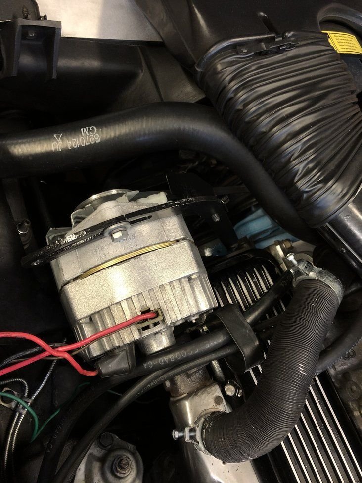

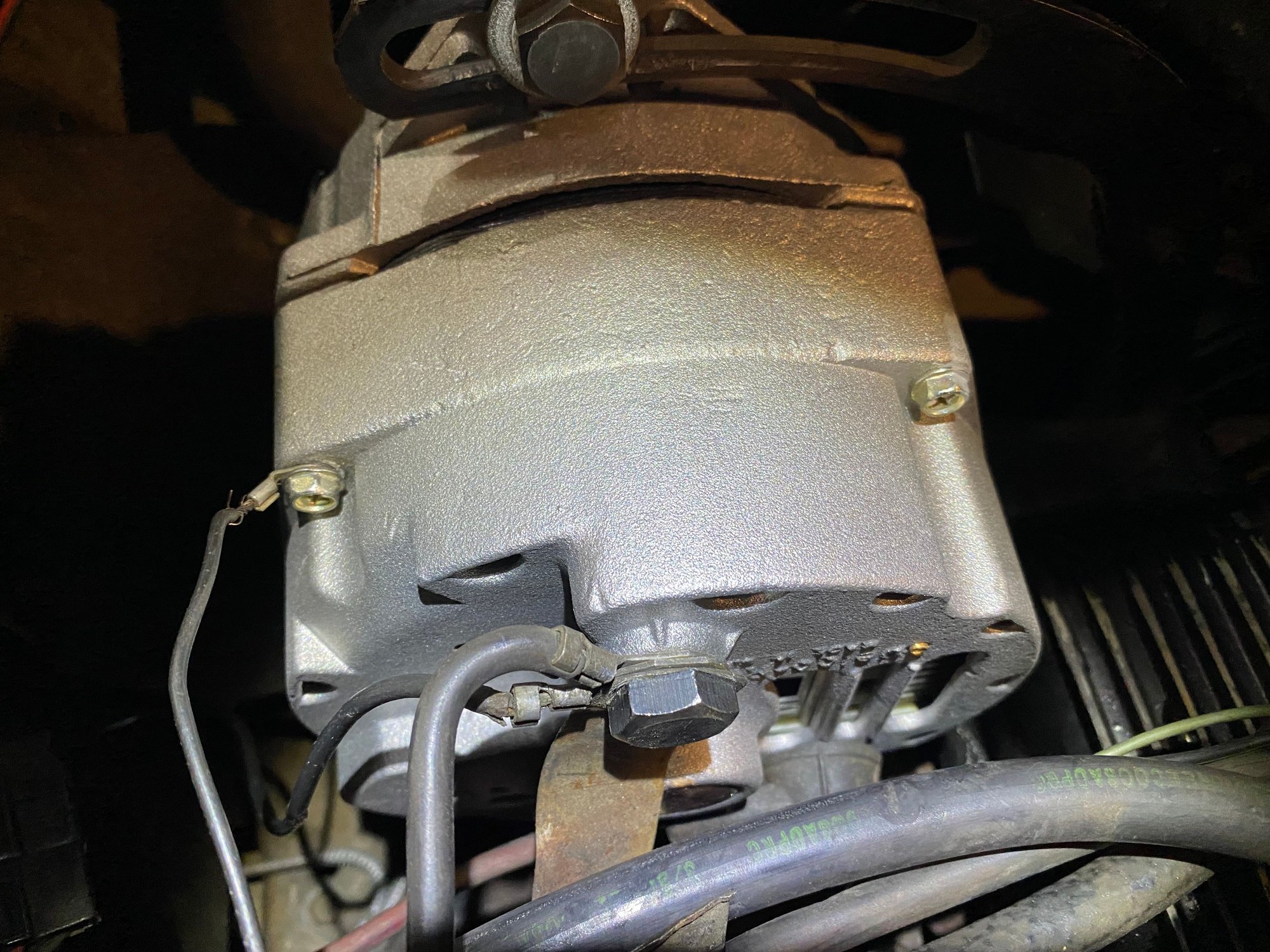

Old Oct 30, 2021 | 06:16 AM
Eric2vettes's Avatar
Eric2vettes
Joined: Jun 2015
Posts: 51
Likes: 13
From: Farmington Connecticut
This is what my new 70 amp looks like.
Old Oct 30, 2021 | 08:43 AM
interpon's Avatar
interpon
Joined: Jun 2019
Posts: 7,649
Likes: 2,466
From: Indiana
others can chime in but those connections do not look right to me, at least oem wise…
