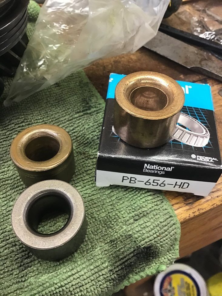

Old Oct 26, 2021 | 05:44 PM
interpon's Avatar
interpon
Joined: Jun 2019
Posts: 7,649
Likes: 2,466
From: Indiana
Originally Posted by cottoneg
Interesting. I never heard that. I was going to put a McLeod bushing in. After all the clutch and pressure plate were McLeod. I emailed tech service and they mentioned
They are a powdered material with iron and oil compressed under heavy load and heat. None of that stuff is made in the states. Most of it is coming out of India."
So I may have to go w
here stingr69 mentioned or similar.
SEE POST #9.. i agree that bushing from McLoed didn't feel right and was magnetic..and looked completely different than what i took out.. silver not bronze... WHY DO THEY DO THIS FOR pennies????
https://www.corvetteforum.com/forums...se-79-l82.html
i did NOT USE the McLoed bushing.. local Oreillys had in stock USA non magnetic in stock.. running perfect still knock on wood.. same one as @Mr D.

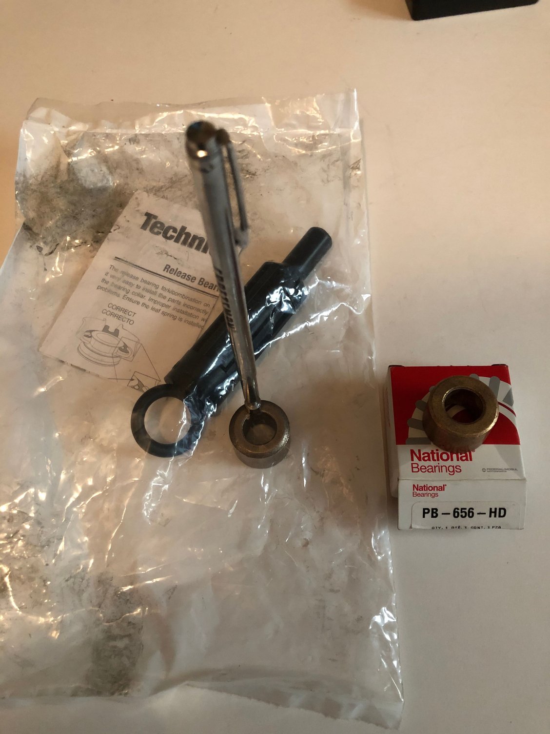

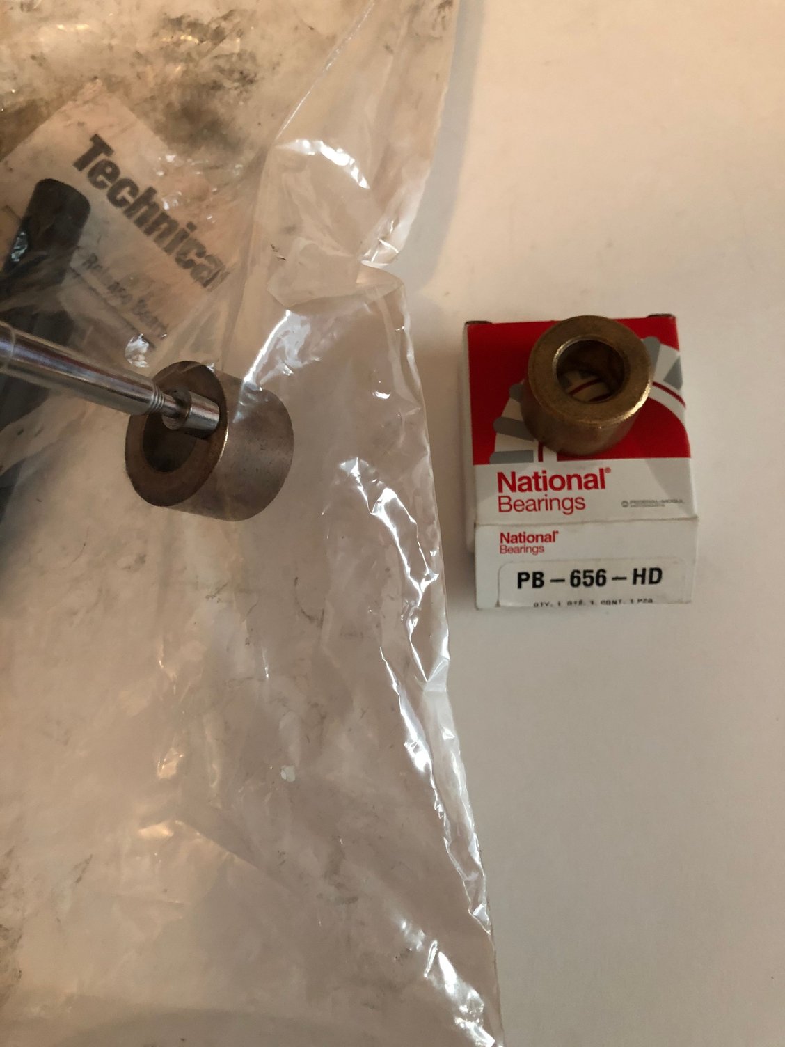

Old Nov 6, 2021 | 11:13 AM
mrg's Avatar
mrg
Joined: Nov 2001
Posts: 4,424
Likes: 619
From: northern CA
Non magnetic National brand pilot bushing. Personal brand preference is SKF.
Pencil magnet sticking to supplied pilot bushing that came with a LUK replacement clutch assembly.
John
