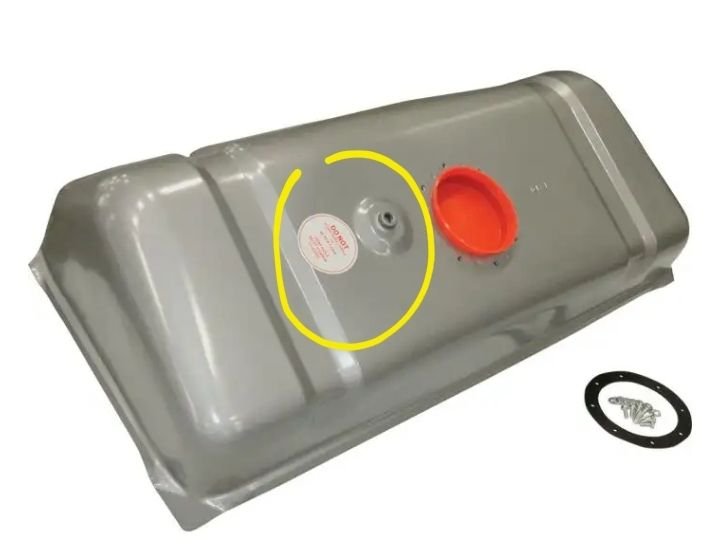

Hello, replacing my fuel tank on my 78. The tank I
received has a do drill or modify sticker. But the area where the t-valve should be installed is also sealed. Do I still need to install. Please see picture

No.
That's for a vent between the steel tank and plastic liner.
Your new tank has no liner, no need for that vent.

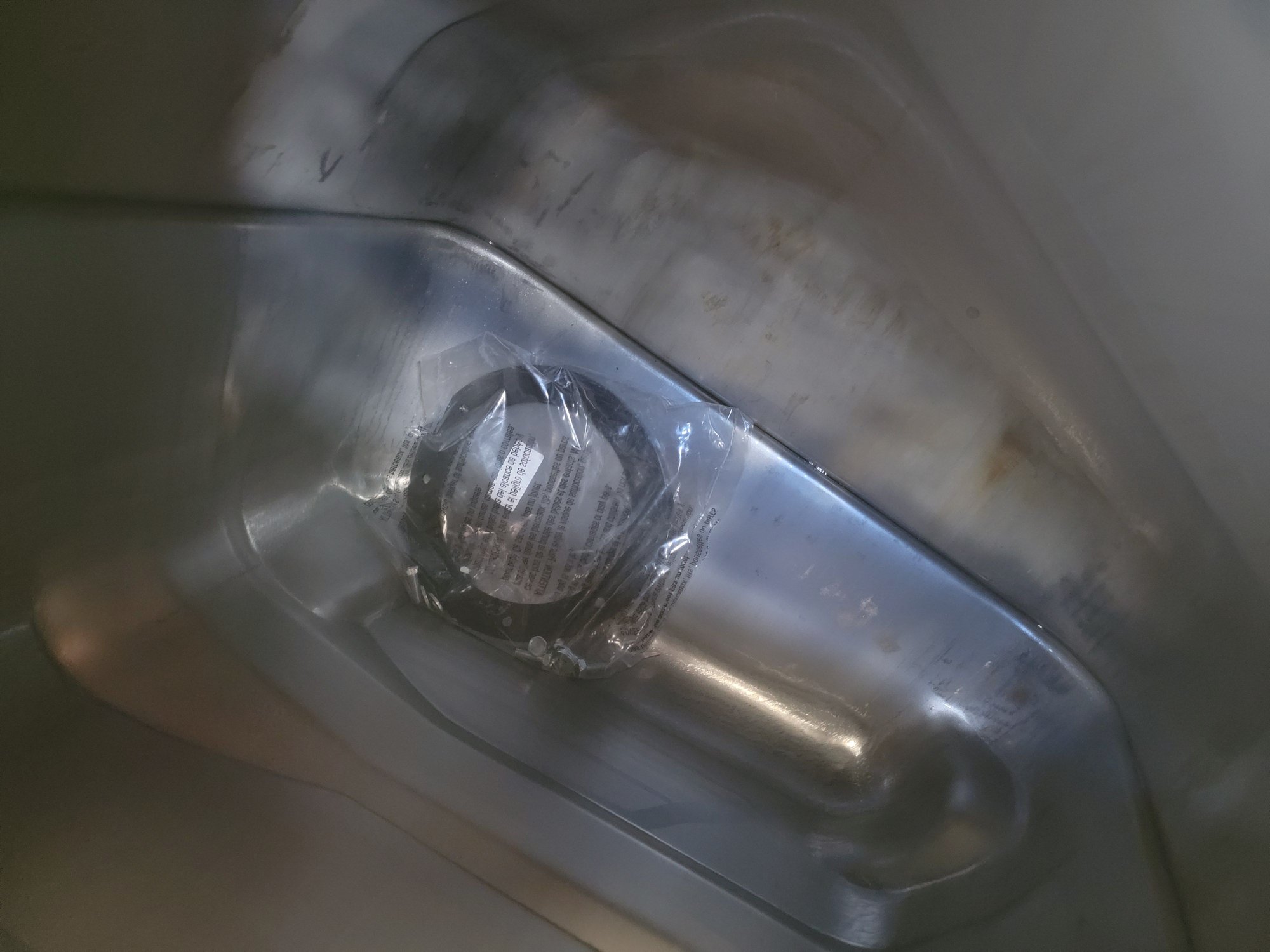

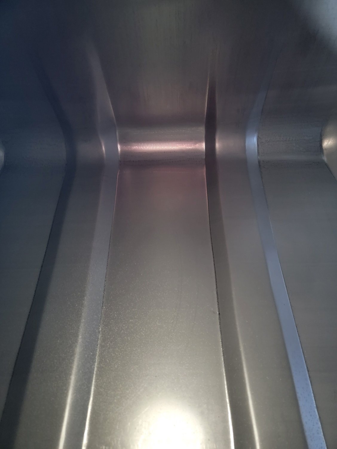

DANIELBEN
Just curious - if you can would you take a picture of the insides? Wondering if it is coated with something from looking at the outside.

Hmm, the tank for my '79 from Corvette Central had one-way vent valves tied to that port.

Default Pictures Inside the tank
Originally Posted by carriljc
DANIELBEN
