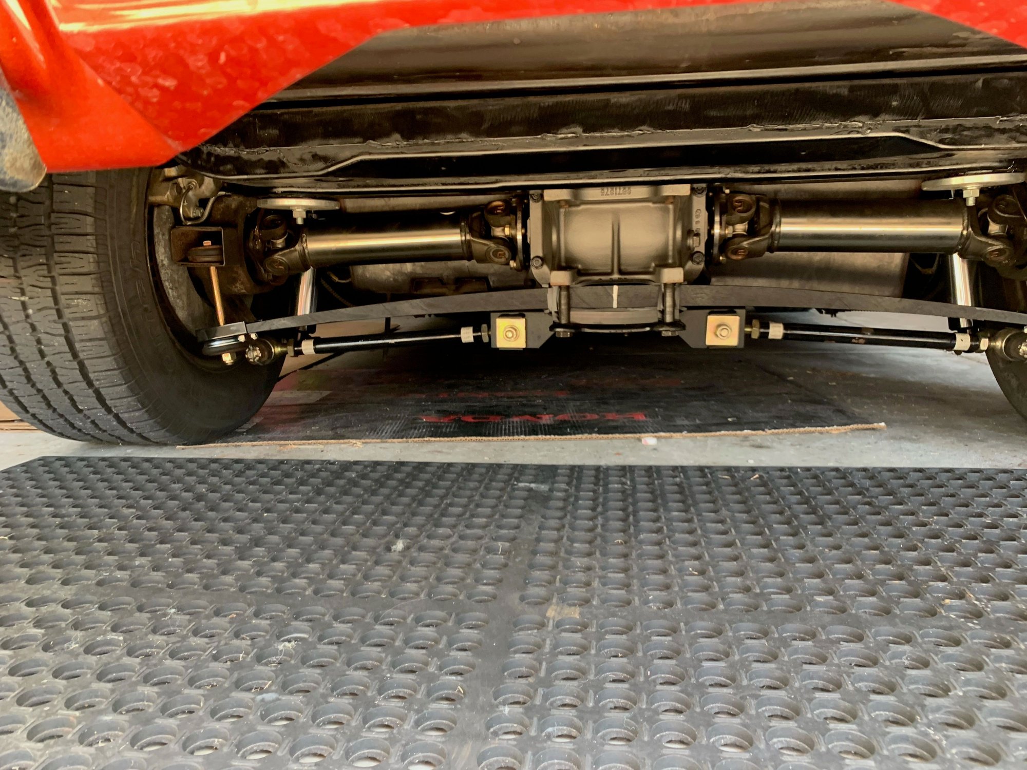

Damn that color is gorgeous on your Vette. I just installed a Van Steel 360# spring with QA1 single adjustable shocks on my 70. I wouldn't say its a "cushy" ride.(I didn't want that) but it definitely rides better than the stock 9 leaf spring and the KYB shocks that were on it before.
